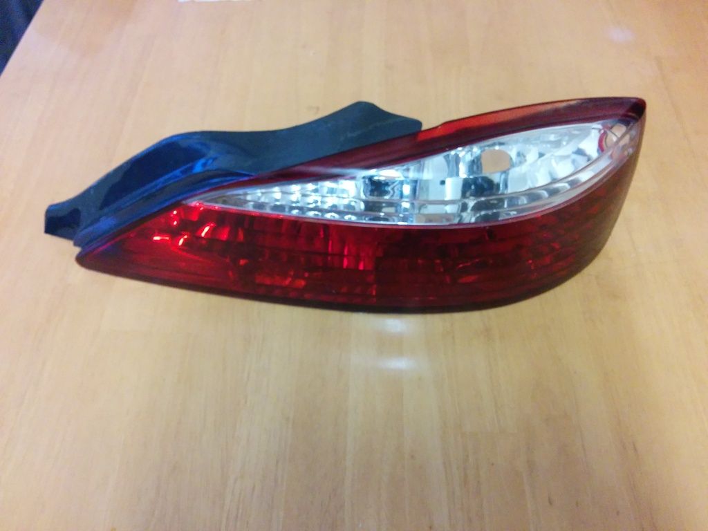

I purchased the led lights, my drivers side was letting in water, i sealed it friday, now ive jist noticed somehow there is water in the light yet again. & the water has damaged the inside of the unit with corrosion.... Fitment was spot on.
16 October 2012
240
uk
These lights are notorious for letting moisture in.
I've gone through 2 sets and tried sealing them further with no luck! While they are stunning lights..keep this in mind.
I'd recommend drilling 2 or 3 very small holes on the bottom of the light to allow the water to escape.
