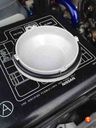

My headlights have been letting water / condensation in so I've taken the caps off to get a hair dryer in there and think I found the source of the problem, the large seals are pretty much perished and need replacing, and one of the tabs is missing off a cap so will need a pair of those too. :wack: can anyone advise on where to get a replacement set or have a look at FAST for part numbers? Pic below if it helps. Cheers

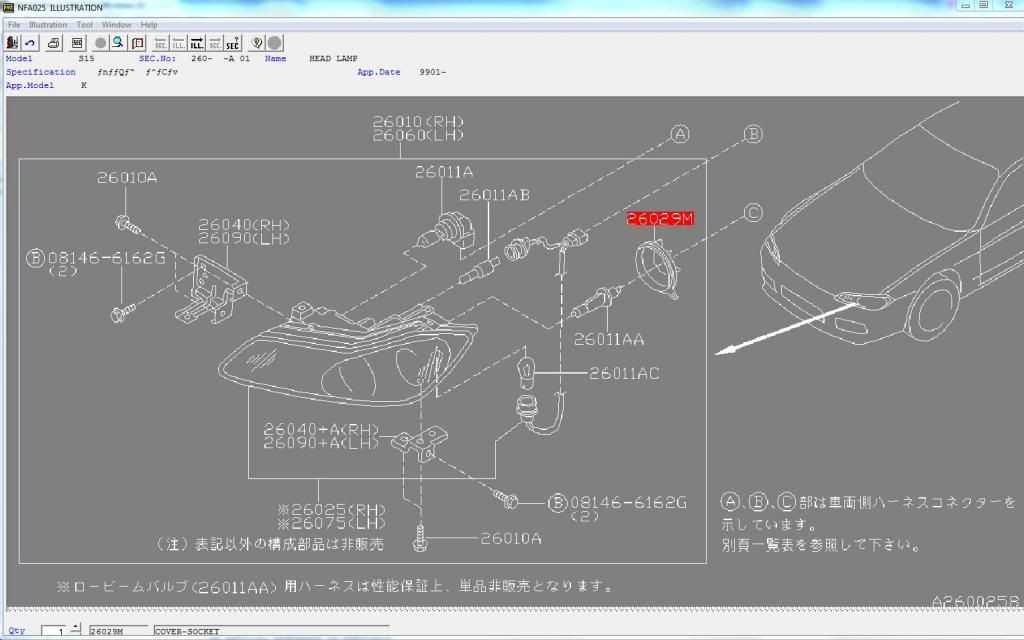

FAST INFO Part Number:26029-85F00- Description:COVER-SOCKET

Thanks Spoonbob!
nice one thanks guys, will get that ordered..

The new seals / caps did the trick, no more condensation in the lights :)

Yeah they arrived in about a week as well which was handy. Took the old cap and o-ring off, removed both sidelight and main beam bulbs and left a hairdryer on low temp / max speed blowing through the light until all the water had disappeared, let it air out back to ambient temperature then refitted the bulbs and new cap / seal. Job's a good'un.
