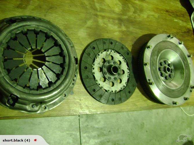

17 March 2009
204
here is the photo of clutch and flywheel that I have.
so where to look for the spigot bush?
thanks for the help guys
:D
17 March 2009
204
oh lo..sweet..
then just the clutch lines that I need to buy from the shop then..
sweet as man
thanks
