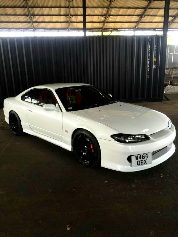

So I've just got some pictures through from the guys respraying my car
Now I've seen it looks good I can relax and enjoy my holiday
Let me know what you think
Sent from my HTC One_M8 using Tapatalk
Lil SpecR
2 October 2015
401
STOKE-ON-TRENT
www.ejmcarphotography.co.uk
@lil_ej_x
:) tbh it certainly looks good and shiny and the first photo looking down the side it looks nice and flat and not orange peely or reacted lol!! sit back, relax and enjoy your holidays, I'm sure she's bang on this time :D

how much should a respray cost around?
Not sure really
He told me it should of cost 3k -3.5k maybe 4 as its a 3 stage paint with pearl
