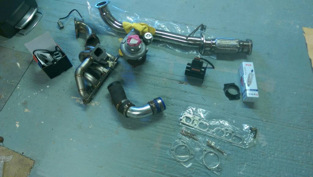

So a little update
Been shopping a lot and it hasn't been a a cheap month haha
Picked up the gt2871r yesterday for a good price
Only thing I need now is 740cc inj and spark plugs
but unsure if I need the 7 or 8 colder spark plugs any help with this please ?

Looks very similar to my collection of parts over the last month. :thumbs:
You got a new airfilter to go with (what i assume is) your z32 AFM?
Main difference being i am going to try and run a high flow cat, so i don't have to swap it out once a year for the MOT.
What is in the box next to the manifold?

I've got this all in about two weeks and fitting over the next two weeks
and I've already got what I think is a Greddy mesh air filter on it already so I'll give it a clean up

It's a turbo smart eboost 2 boost controller
It's pretty sweat bit or kit it can controller water meth and nitro if needed
And can do boost by gear so I can get the power down
