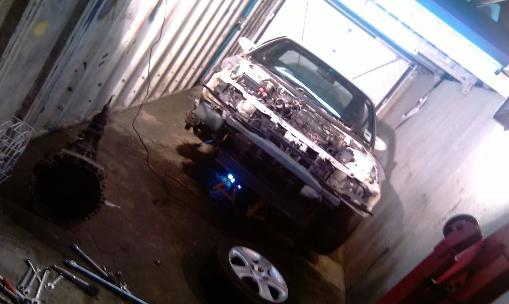

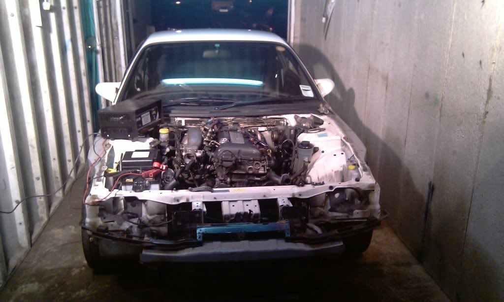

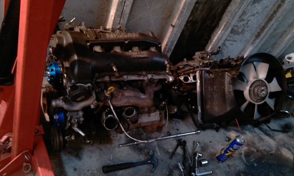

1st of my mates S14a that we are rebuilding aswell :wack:
Now My S15 :wack:

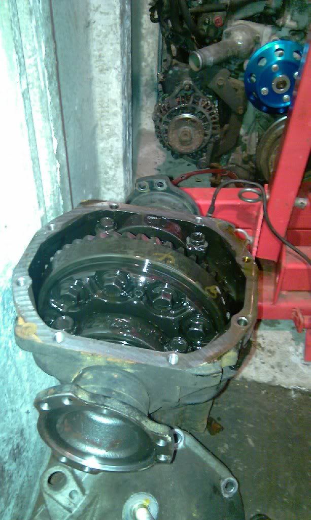

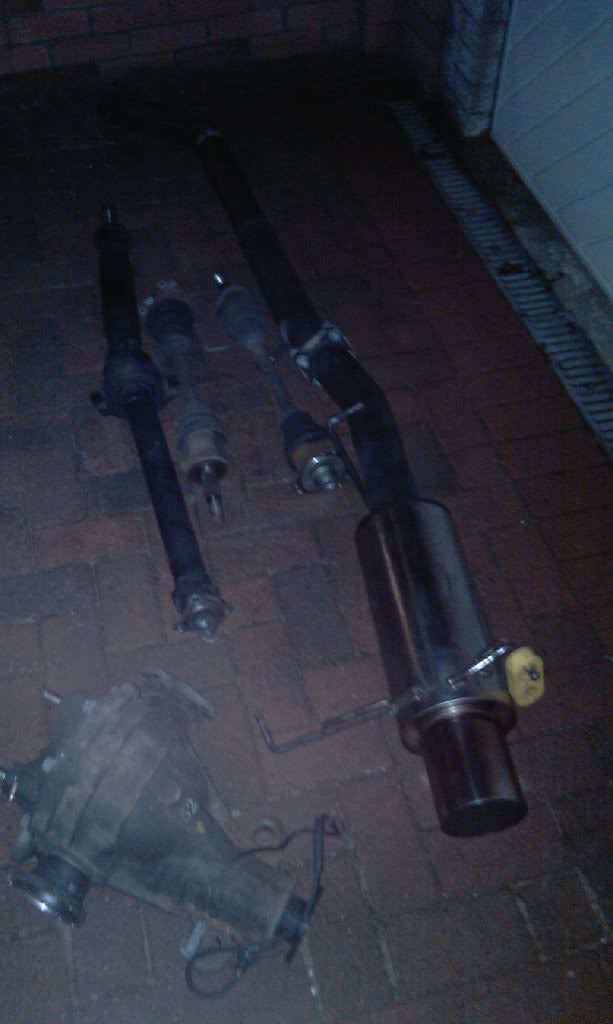

Safe to say taking out the Diff, Prop and Driftshafts and Gearbox with the car just jacked up at the front was entertaining for a Sat night :wack:
Few more parts will be ordered next week and a good few bits already added to the growing list :D

Haha forget doing all that with it just jacked up at the front!
Bet that was a tight squeeze! :D
22 October 2009
964
Paisley
www.bebo.com
Dude I had to jump on the back of the engine while my mate bare huged the gearbox out! I got a diff in the nuts aswell when it came off the driveshafts lol
well earned drink on sat night :D

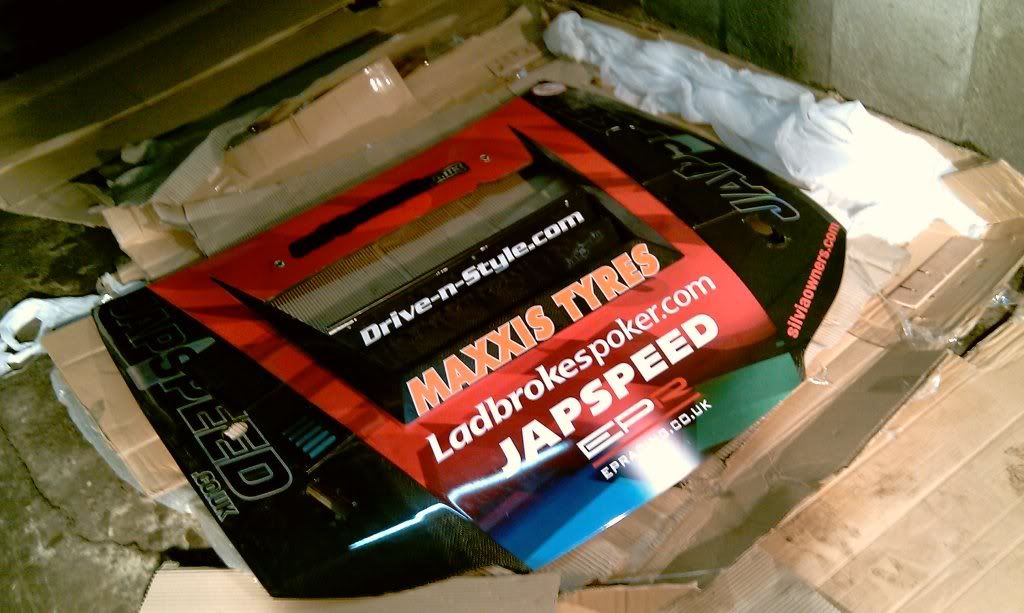

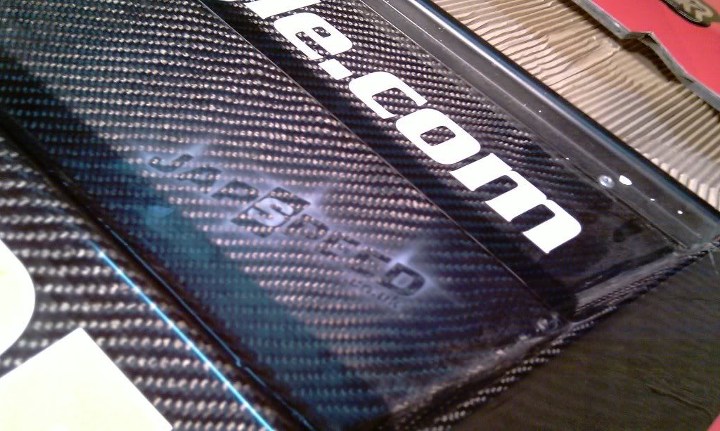

Japspeeds own Shane Lynch's bonnet from his V8 S15 :)
Big thanks to Japspeed for sorting us out with this and one of their FMIC Kits ;)

just fitted it aswell going to look ace cause one of the carbon pannels has been taken out when Japspeed put in the V8 with the Sr20 you will be able to see all the centre of the engine, inlet and turbo set up :D woohoo

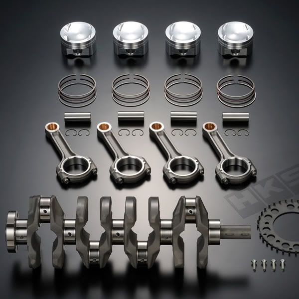

HKS only do one type of Stroker kit for the SR20DET dude here is the part number etc :)
21004-AN001
Nissan SR20DET 2.2L Kit, Capacity 2164, Piston Size 87mm - 22mm
most of all the details you would need is here from nengun aswell :)
http://www.nengun.com/hks/stroker-kit-nissan-sr20det-22l

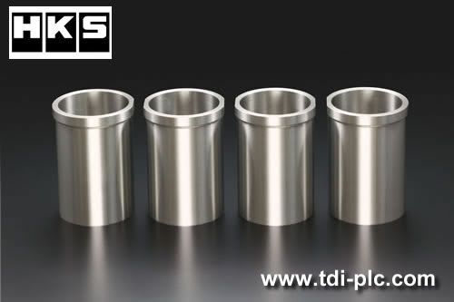

Though I am also going for the cylinder liners just to be on the safe side considering it will be a HKS Step 3 Headsystem aswell in there :)

Thought there was more than one kit as I have seen prices vary from 1400 up to like 4000 ? Thought with that wide variation would have been diiferent kits maybe just a. Search error, cheers mate will check it out,seem beTter priced than other kits,Your going for a full hks set up then,gonna be pretty awesome!

to be honest I personaly think a 2.4 stroker will be a bit OTT for what I am looking to gain and with a pritty much fully forged HKS engine I would be pritty happy in pants :D
Pegliobaglio - nah dude I am sure HKS only do the 2.2 for the SR20DET as thats what they run in their own S15 and the Top Secret S15 aswell :)

Sweet,yeah I looked into it a bit further and all are the same model number,just don't see how the prices vary so much,found a place doing the kit for 1200 dollars shipped yesterday? Then the next place was 4400 dollars???? Best to get it from a reputible supplier and spend a little extra.

has no one ever fed back on the apex stroker kit ??? thats good value if it does the business.....

I looked at them dude, personaly I was considering it but after reading up on most of their rads have been bursting and the FMIC's taking months after months I would much rather know whats in my car has been tested 110% and is used in alot of other top S15's such as a Top Secret S15 to name one of many :)
Value is there on it but its the small things that put me off such as why sell a stroker kit with a crank that isnt balanced? For all the cost in it its small things that just would make me spend that bit more for peace of mind :)
Pretty sure a crank needs to be balanced with the flywheel and clutch assembly all connected in order to be balanced correctly. And seeing each clutch, crank and flywheel combination will be different it makes sense to sell them unbalanced.
