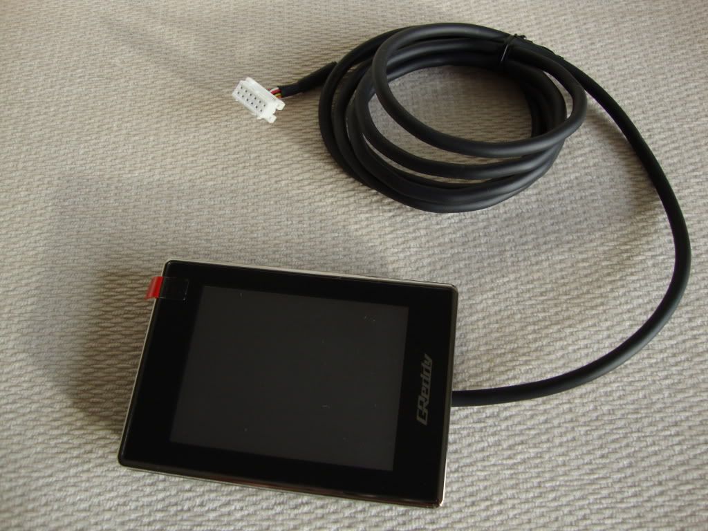

Well I've ordered an informeter touch, should get it in a week or two. It says it comes with an obd 2 plug, but I've also ordered the opional Nissan consult plug adaptor! Won't be able to tell you which one I use, because I havnt even got a silvia yet. I'll take a couple of pics when I get it, showing the different plugs.
The Nissan consult plug is apparently 14 pin.
Post some pics soon.
Mike
S15 SILVIA
Recieved my informeter. Looks a nice bit of kit.
Had a look at the optional Nissan consult cable I bought, and it's only got 4 or 5 pins. Does that sound right?
I'll try get a couple of pics up tomorrow.
Mike
S15 SILVIA
Heres a couple of pics.
Looks a nice bit of kit, just need the car to put it in now! LOL
It has 5 pins too
Mike
