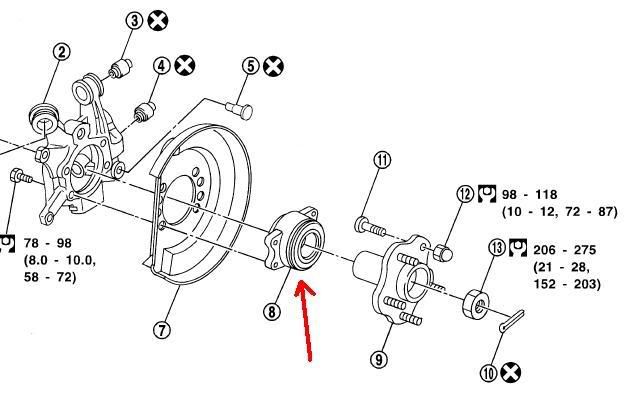

Unlike the front , the rear bearings cannot be pressed out and replaced with suitable sized ones. Ive to get them replaced with the hub.

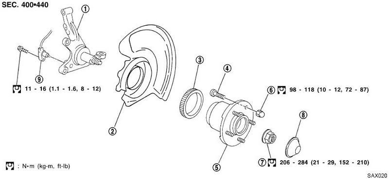

Can't figure out the front. The manual is very haynes...
Assume you press it out of the hub (5)?
The rear bearing will come off the hub assembly if you keep the four rear bolts attached when using the hub puller. I removed both in that photo to get to the back plate and knuckle. As you suggest, this was for the Z32 brake conversion. Don't, whatever you do, make the mistake of taking the knuckle off to do the job :no: Its completely unnecessary and will add a couple of hours onto the job...

Yep i meant that flange assembly (8)
Nicely,
which job are u referring to when u say do not remove the knuckle?The brake conv?Knuckle is item no (9) as shown in the rear wheel pic rite?
I'm new to this..
Thx
I'm talking about the hub and bearing removal. A lot of people think you have to take the knuckle off the remove the bearing. This involves undoing all the various arms and would be a complete PITA. In fact, the bearing bolts can be removed from the back without too much issue by simply rotating the hub to gain access to each bolt in turn. Simply loosen each bearing bolt, remove the hub with a puller, remove the bolts and take the bearing off.
