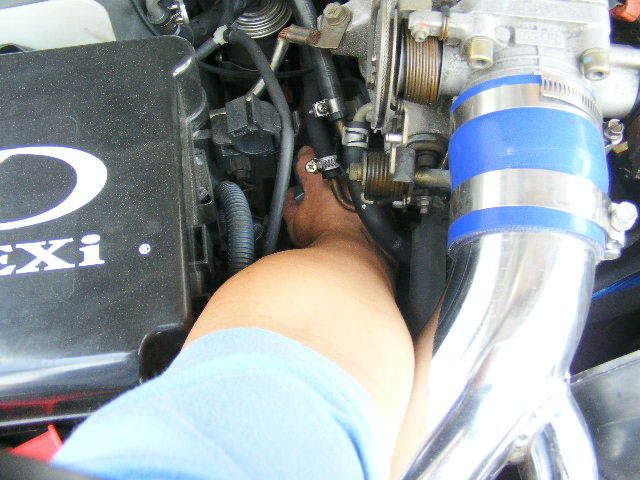

When I had my oil filter changed, I realised with the aftermarket adjustable FPR in the way, its absolutely PITA to remove the oil filter now. The relocation kit becomes essential if I have bigger hands. You can see how tight it was for me here...:(
G
gunner93
Its worst if the engine is hot and no proper tools. I had to loosen the filter first to hand-tight +10% before warming up the oil to temperature.
