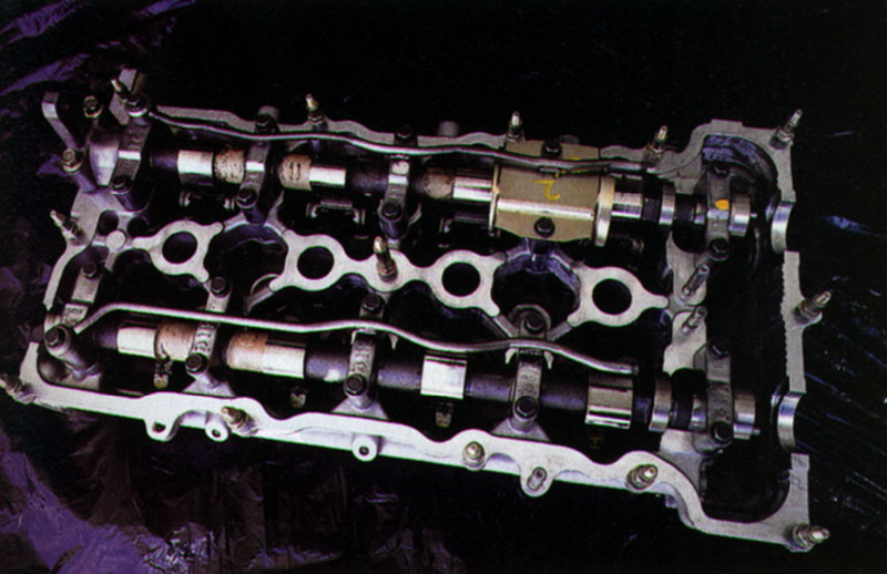

Err, cos they have the same valvetrain you dumbass! :p
OK, so the DET in the 15 has VVT and a turbo, but essentially theyre the same! :wack:

SR20DE head:
SR20DET head:
