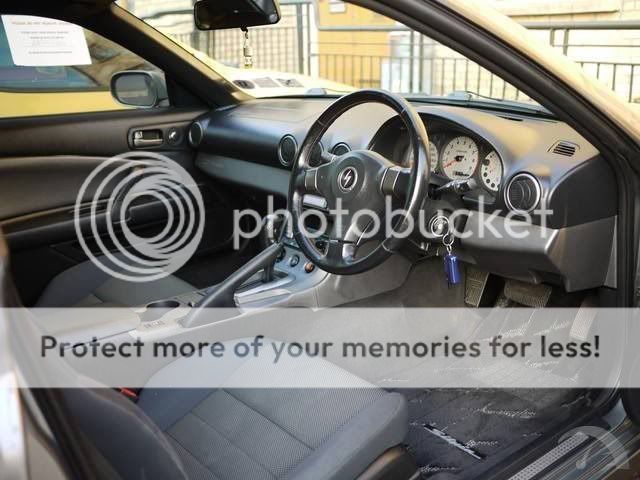

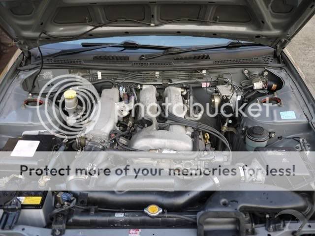

Well after a year without an s-body I seem to have fallen back into the game. The S14a got sold along with the Navara in a bid to limit myself to one sensible car whilst my wife was on maternity leave. So I bought a Black R33 GTR V-Spec. As nice as it was, it never really exited me so now my wife is back at work the GTR has gone, I’ve bought an L200 animal and the plan was to buy a TA22 1970’s. Then this came up.
It’s a NA Spec S with auto box and a mind blowing 160 BHP with a fair few battle scars around the bumpers and wings, and even had a smashed rear window and broken door locks. It is however completely rust free and very straight underneath it all. It’s done just 62000 kms.
On a whim, I flew to Dublin paid £2850 cash and ‘transported’ it home.
Obviously my first and only thought was RB25. So here I am with this in my garage, and an RB25 conversion package ordered from the GTR shop, and some other bits and pieces ordered from Jap Performance Parts.

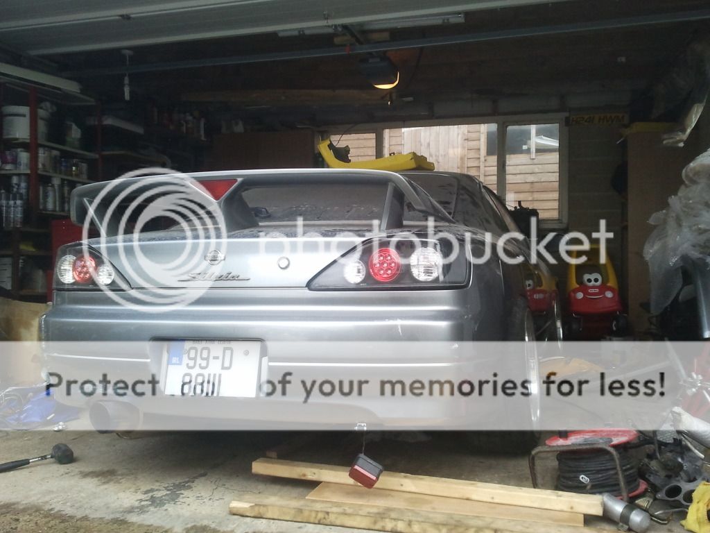

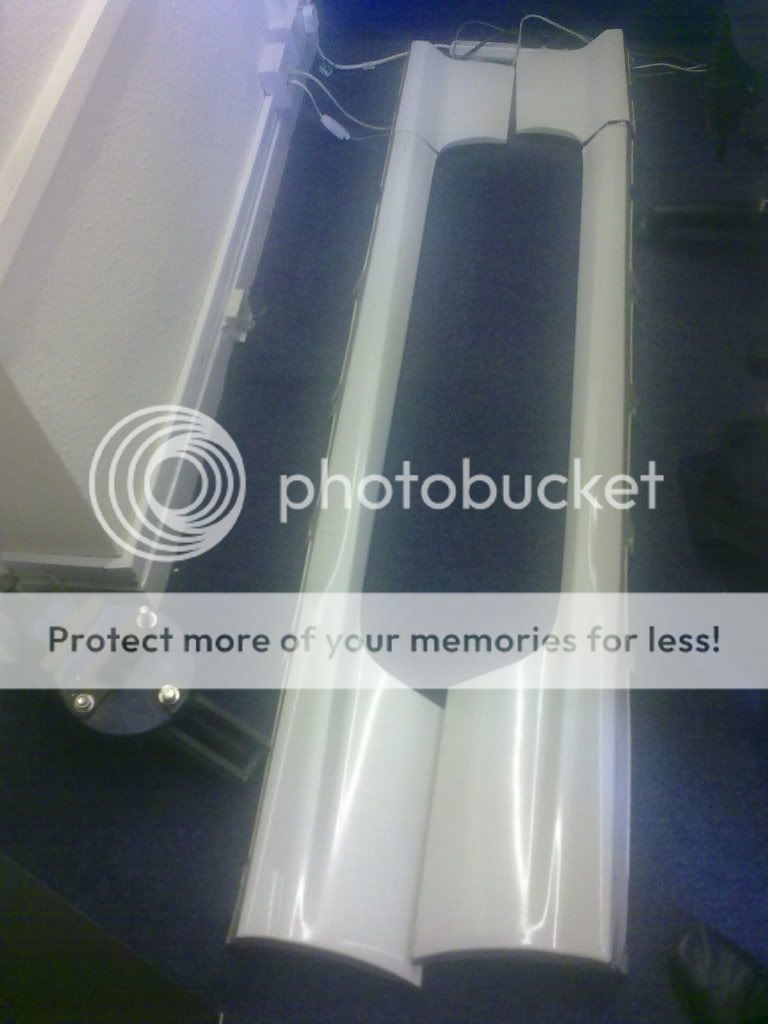

First goodies have arrived. Aero Side Skirts.
Nothing like having your desk at work surrounded by car related bits and tools.

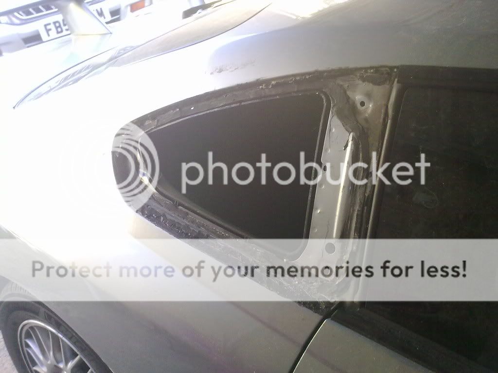

I have started to remove the broken glass from the rear quarter and clear the adhesive. Any hints on fitting the new window appreciated.
Looks like someone has bodged it previously with drainpipe sealer as it is really tacky still.

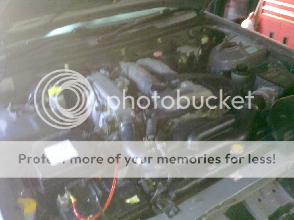

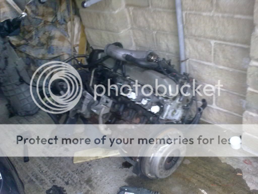

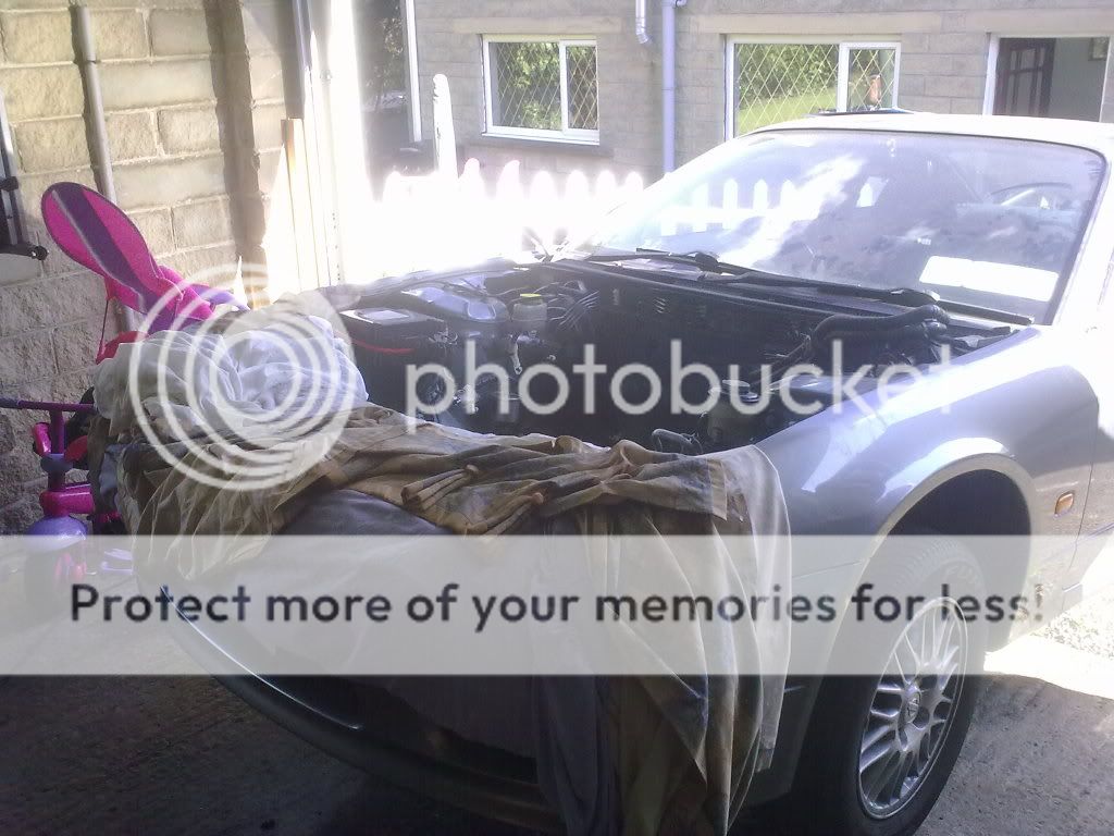

Engine removal has commenced. I can't dedicate a huge amount of time to this as I have a new house with extensions and things being planned, so as and when I have been removing parts.

The front wing also needs replacing at some point.

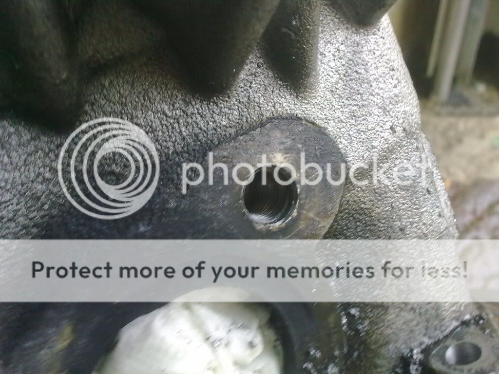

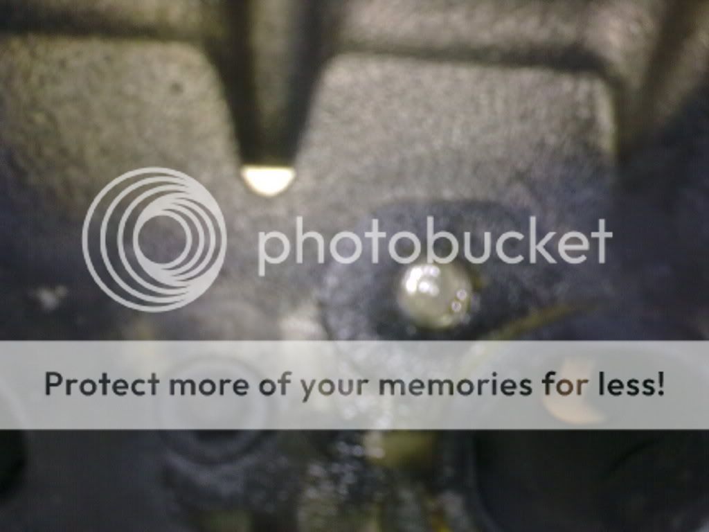

Well as I have recently found out the RB25 is prone to exhaust manifold studs shearing.....I have three that are gone.
So using a stud removal tool (the left hand tap type) 2 came out failry well, the third needed drilling and tapping.

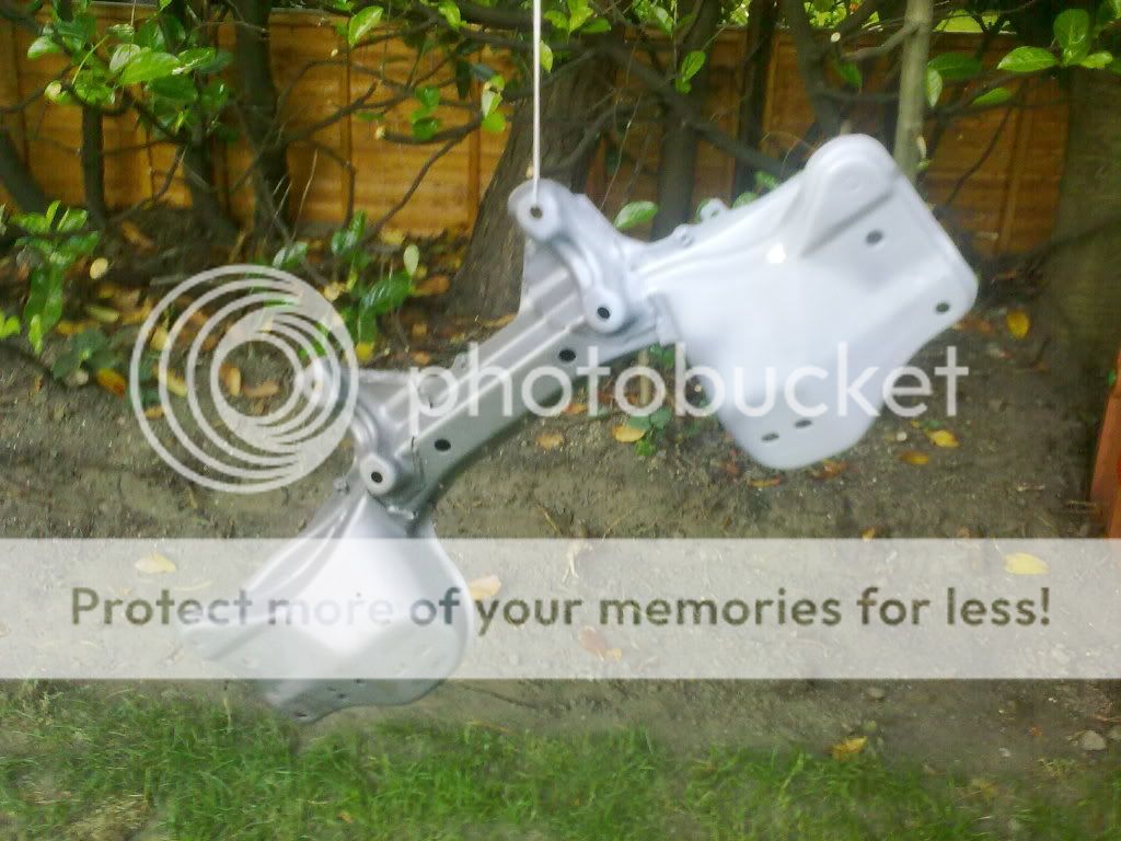

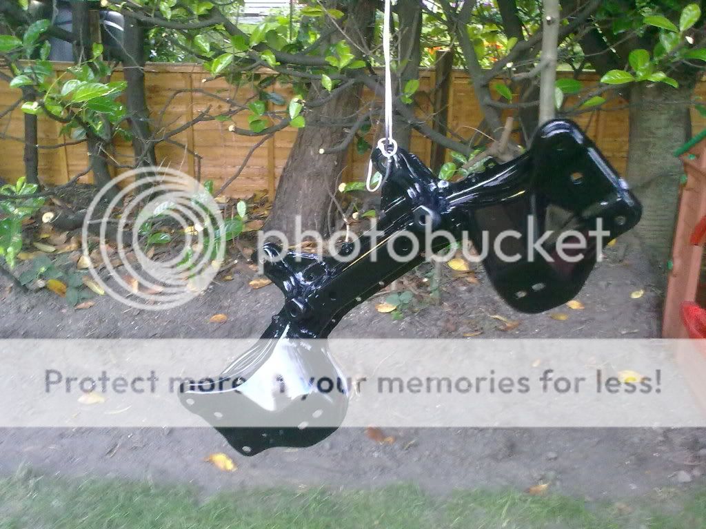

Going with advice from here I am using the GTST subframe and engine mounts. I have yet to see much difference, anyone know what it is? does it sit lower?
A quick shot blast
and a lick of paint

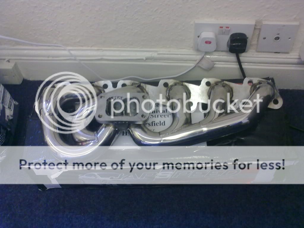

I have some Alloy 825 (commonly known as Inconel 825) 10mm bar. So I am going to make some new studs froms that. Still not as strong in tension as a high tensile steel but at least it won't rust and much better that 304 or 316. I have been toying with the idea of a tubular manifold, but can't help thinking it's not worth it for under 400bhp. So I may just get the cast one skimmed.

Bought a Japspeed Manifold.

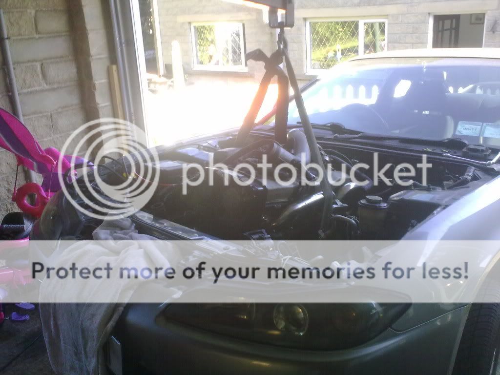

The engine is in. I um'd and r'd about dropping it lower but after a conversation with Martin Battye at MB Automotive I decided to go for the standard mounts and get a Greddy style plenum.
Some much needed help, cheers Andy.
Looking back I should have dropped the car over the engine, but it did go in.....just!

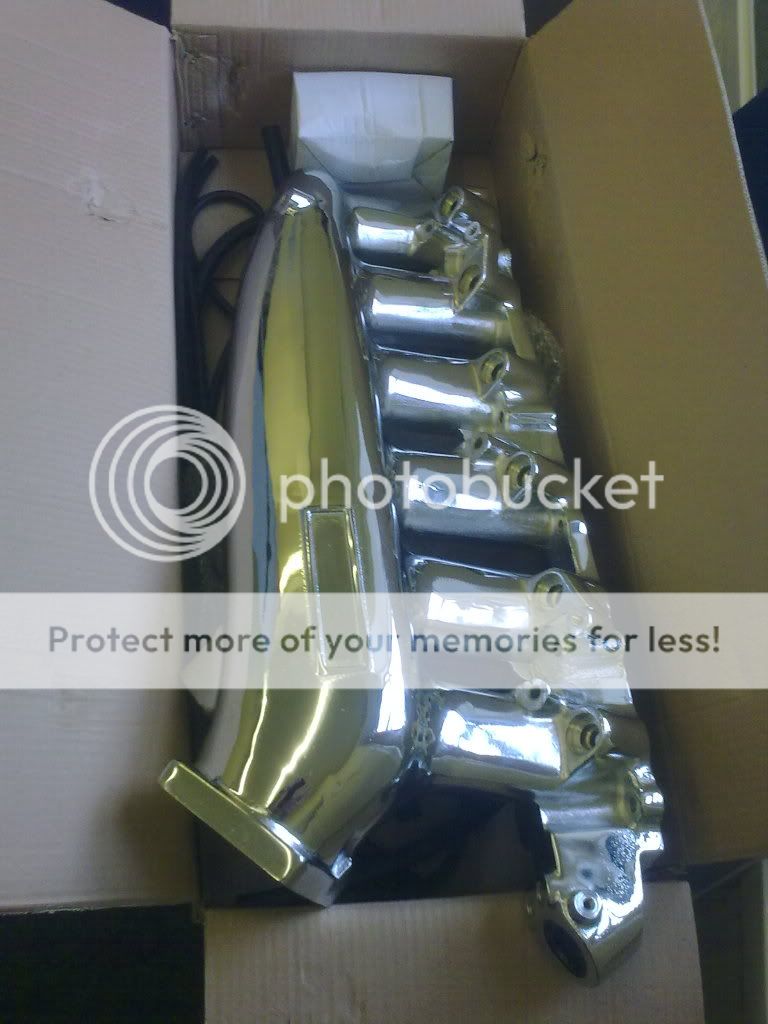

This arrived today so is next on the list.

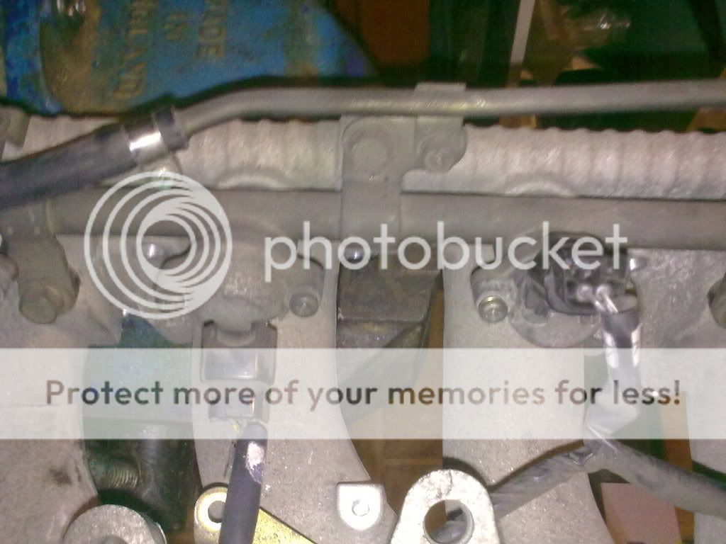

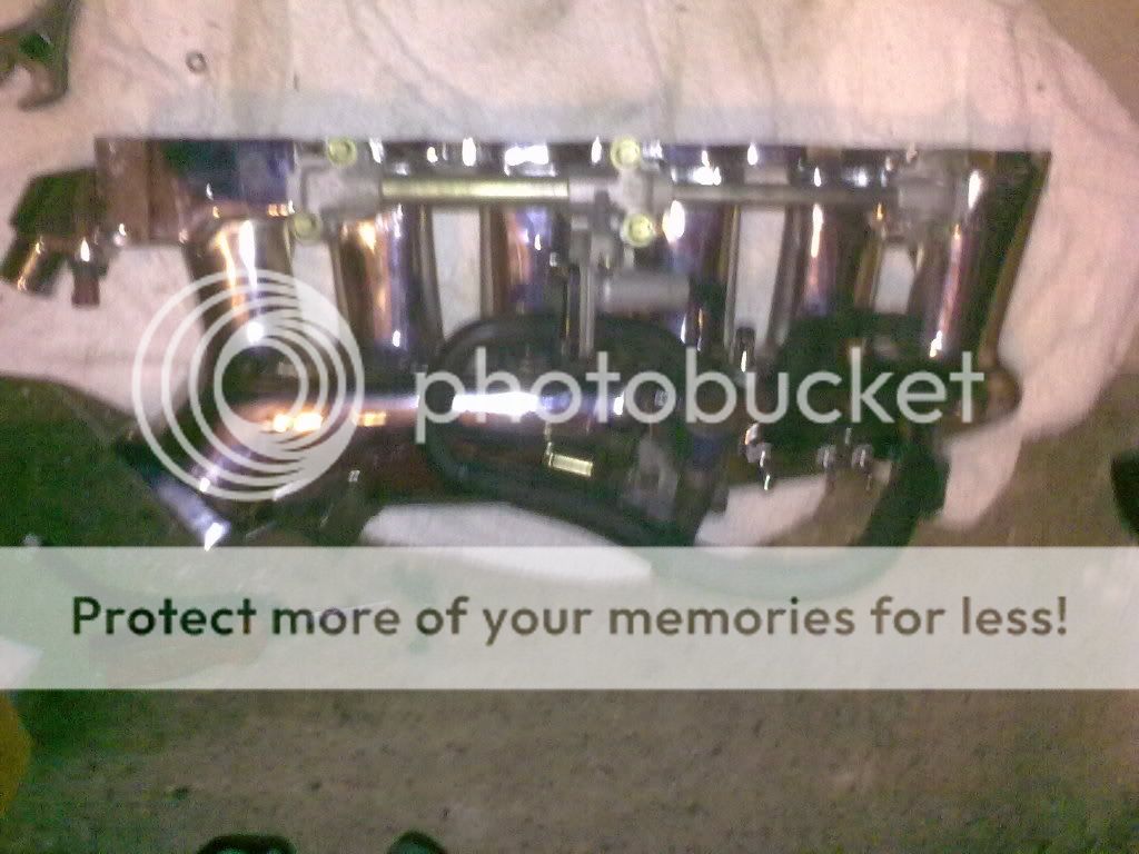

I have removed the inlet manifold and started swapping all the parts over. Whilst turning the fuel pressure regulator 180deg I managed to snap it!
Heres the injectors being rotated 180deg too. I didn't damage these thankfully.

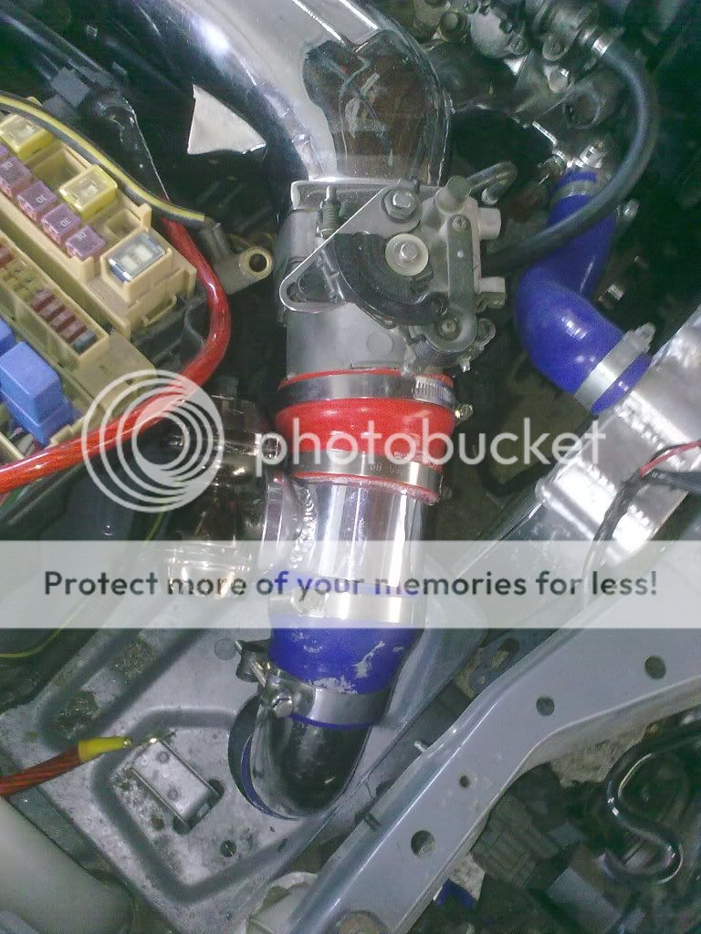

Fitted the inlet manifold....mostly, just need to hook up the Q45 throttle body

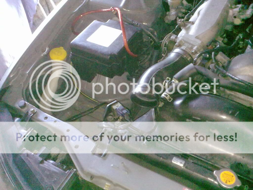

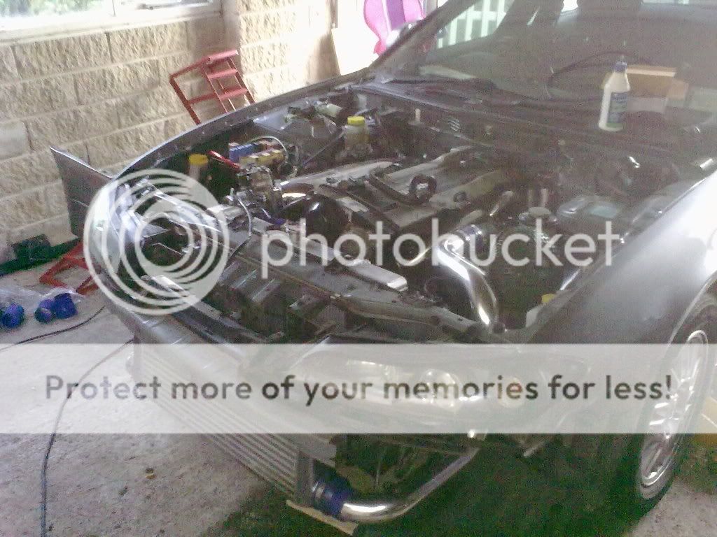

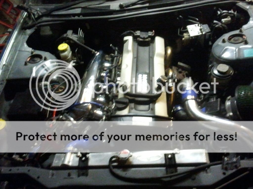

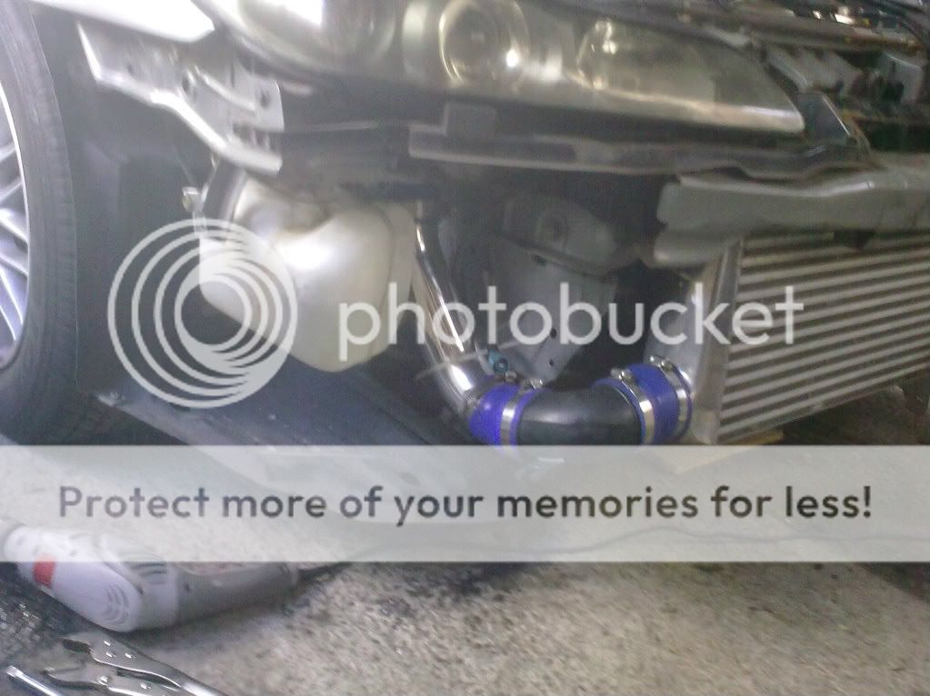

Bit of an update and some pics.
Just part fitted the FMIC. I need to fab a pipe from the core to the Q45 throttle body and include the dump valve somewhere in that.

some more pics

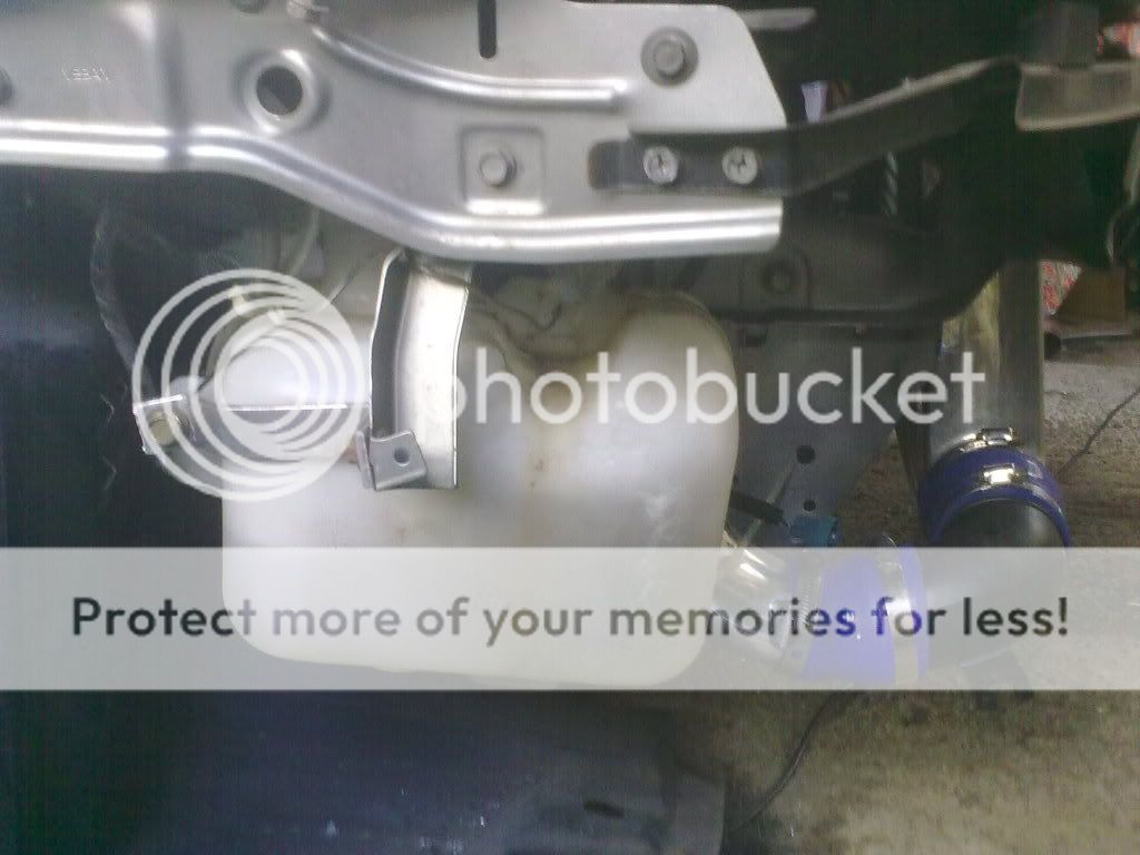

Water bottle rotated.

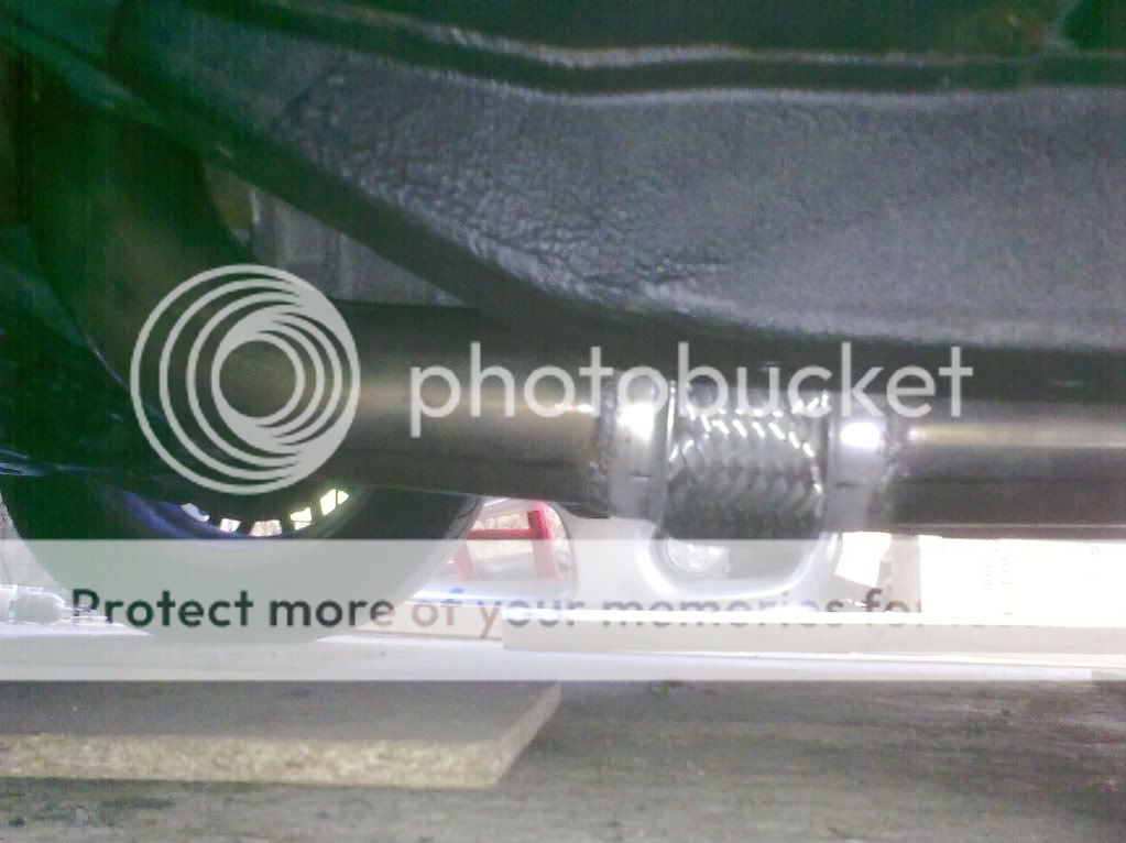

and heres a pic of the downpipe fitted. Perfect fit!

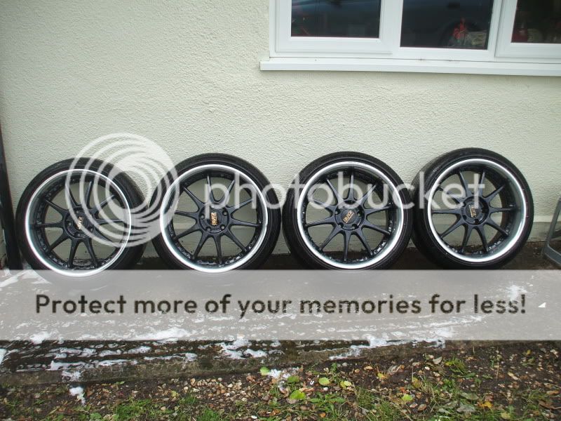

More importantly I bought these off ianlea73. Not got them yet, there at my parents house 200 miles away but can't wait to try them on,
18x10 et 22 rear wheels and 18x9 et 38 front wheels.

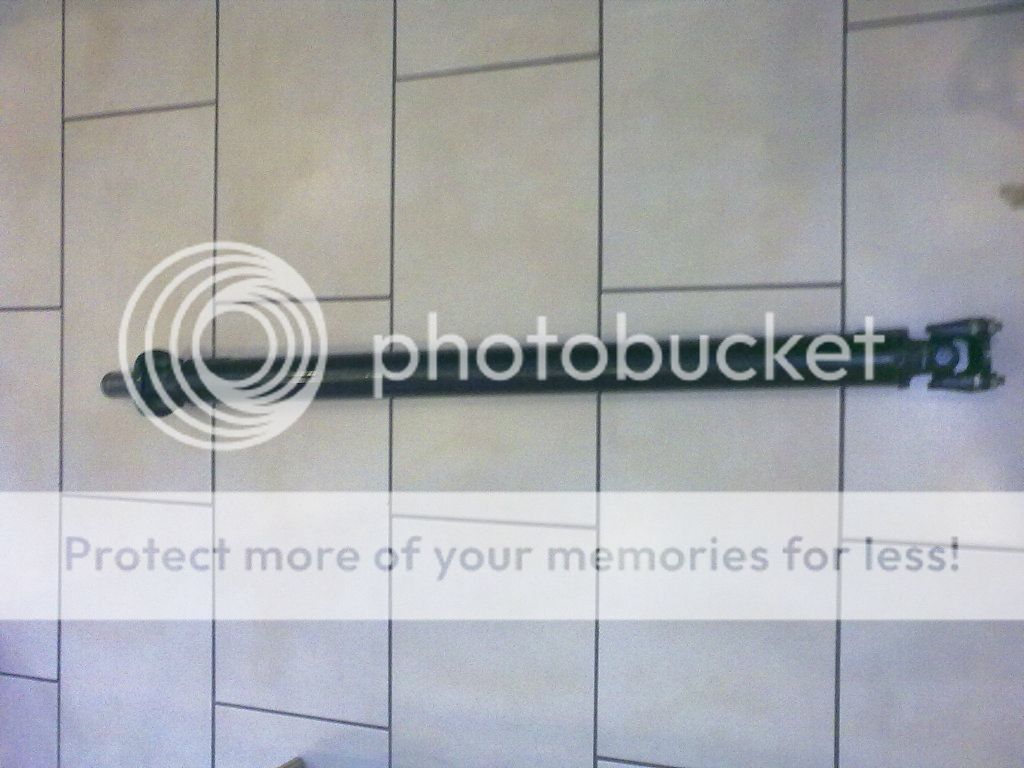

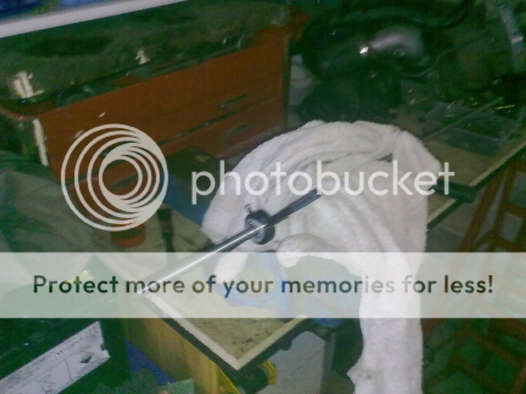

DR Prop (http://drprop.co.uk) has made me up a 1 piece prop shaft using the Skyline bits and pieces.
I'm really happy with it, and for £135 balanced and shipped you can't grumble.
So this will be fitted tonight along with new belts.

I just sent him the R33 complete prop and he cut the ends off to use because the Spec S Prop was about 2" diameter. I sent him this sketch; yours will be different for an S14.

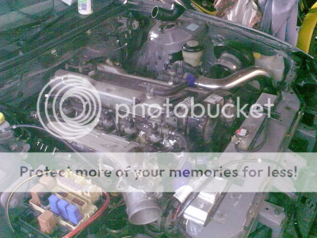

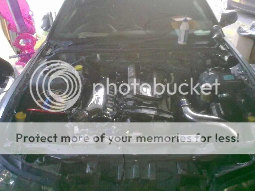

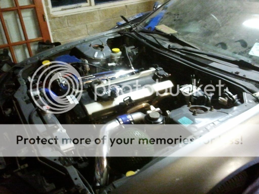

Here's a photo of the engine bay;

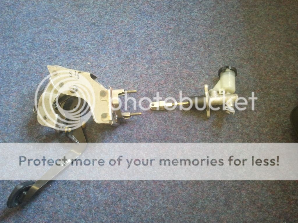

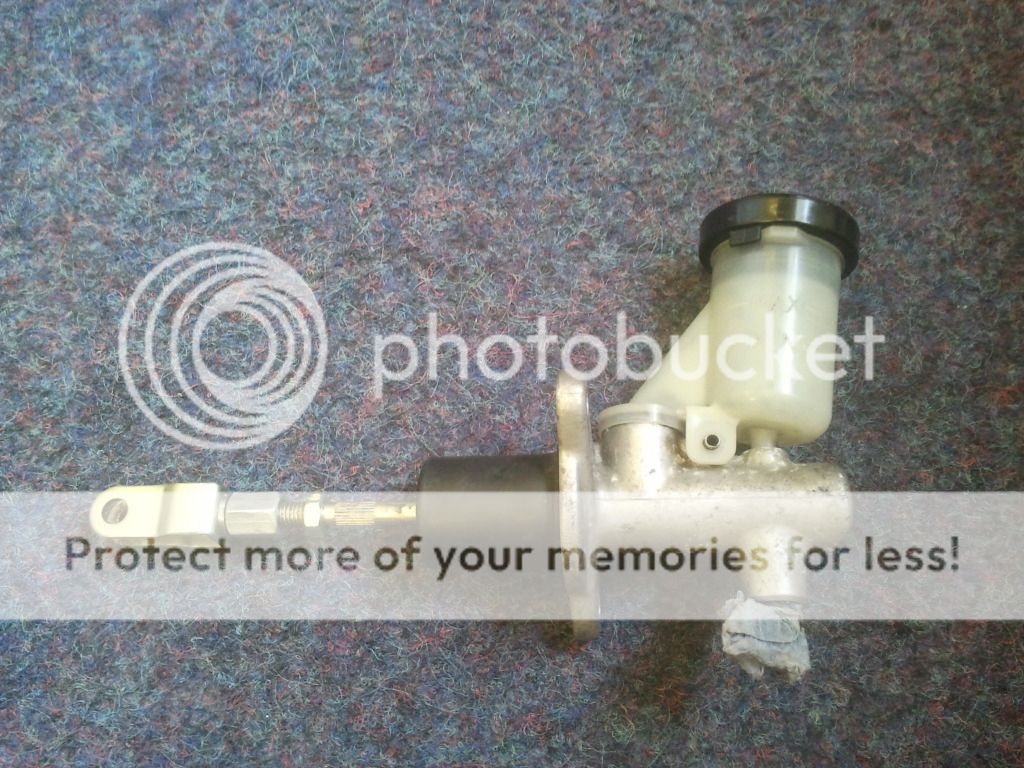

This is a boring update but essential for those doing similar conversions.
We all know about the interchangability between S13 and S14 clutch pedal and clutch master cylinders I won't discuss this. But as for the S14 and S15 I found no direct info on this so here is what I now know.
The s14 and S15 have different clutch pedals - not interchangeable.
The s14 and S15 have different clutch master cylinders - not interchangeable. The main housing is the same, but the s15 one has a longer push rod assembly to reach the pedal.
I have an S15 pedal and an S14 master cylinder, so the following pics should show how I made it fit with an M8 connector cut down by 8mm in length.

Have a friend over here that I supplied a Spec S to. He popped in an RB26 just recently. Had maybe 10mm of clearance between the water pump and electric fans.
How is the inner casting inside that plenum you bought? Ive seen some replica's and they were pretty nasty inside.
