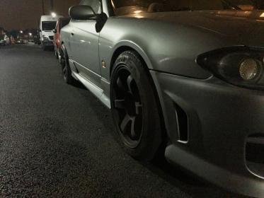

Can't say specifically, but the HSD monopros were fine with mine. Let me get a pic sorted so you can see what 9j ET25's look like (without spacers)

Needed a roll on the rear but no stretching arches, and the fronts are fine as is.

That's a really nice fitment, That's what I'd like to go for.
