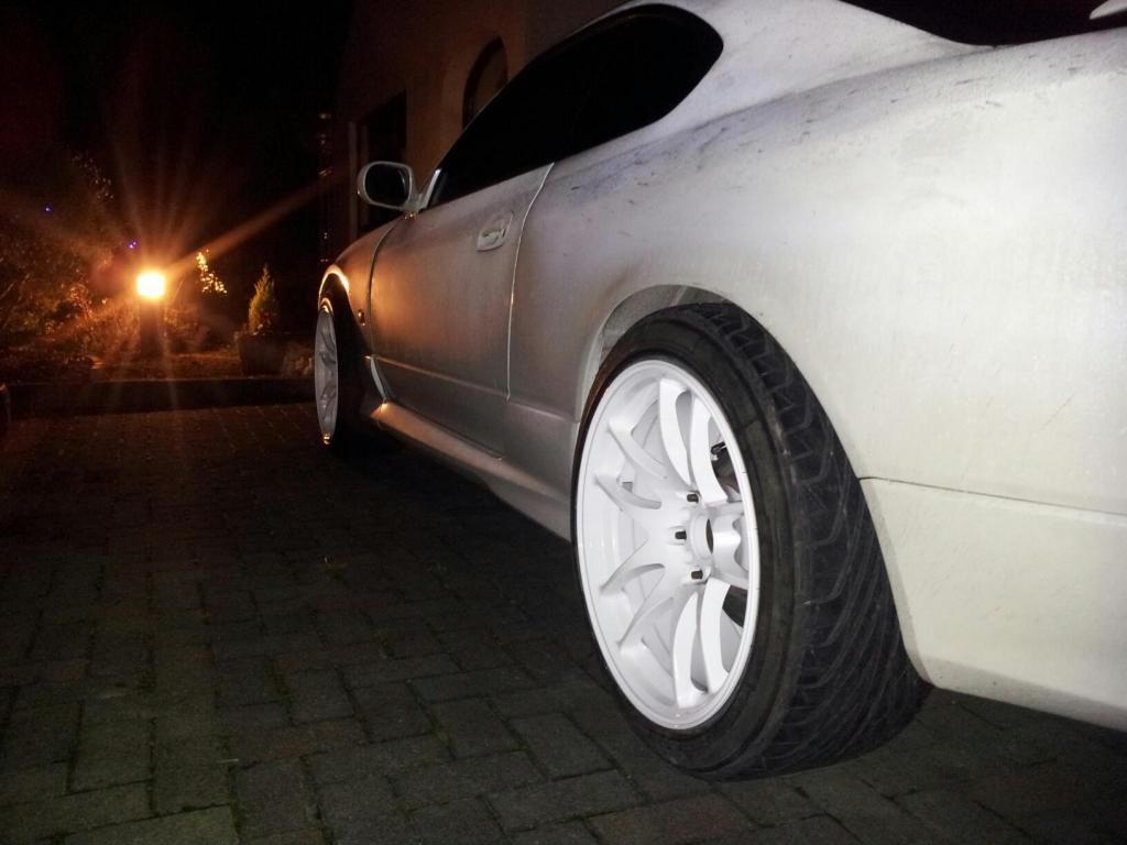

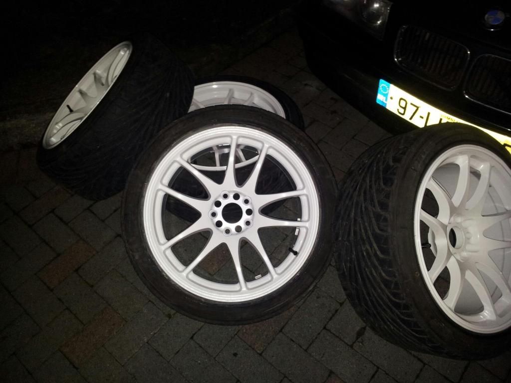

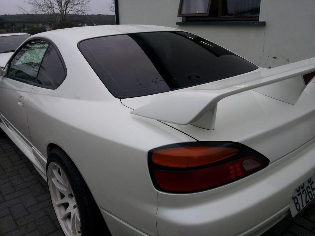

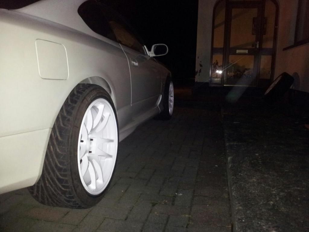

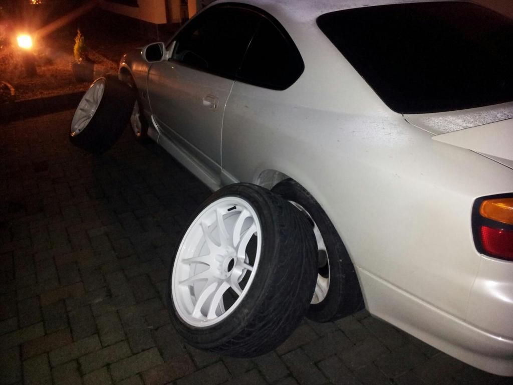

As said above lad have these and also d1 spec wheel nuts they will kill you!! Some were so loose I thought somebody tried to steal my wheels have to be checked constantly...looks like u have the perfect am out of dish!how many mill is the dish
Mine are perfectly tight since day 1 which I would expect for the price but i'll keep checking. I would not touch D1 spec, I believe they are cheap aluminium or something and warp.
Too wet to go outside and check but according to Works specs chart, the front has 71mm dish and the rear has 96mm :thumbs:
What specs are the works and what size tyres looks great? Are you on stock body?
I updated the 1st post with wheel specs just there and yes I'm on the stock body with aero kit. I like the idea of 3 piece wheels because if I ever did decide to go widebody, I can split the barrels

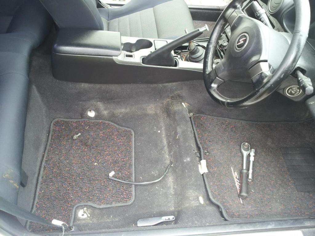

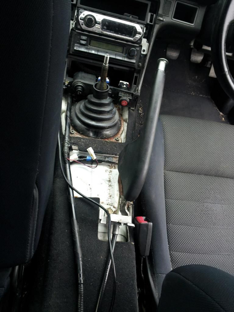

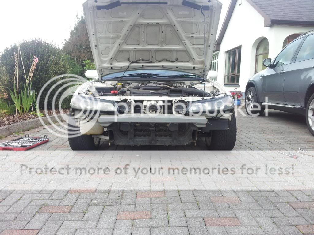

Been awhile since I updated this, the car is in the garage as of last week so the conversion is under way :D
Here is the list of parts I collected for the swap:

The wiring has been pulled and sent to Wiring Specialties in the US so they can give me a 'plug and play' loom for the engine in my chassis.
Will update this as more happens :thumbs:
