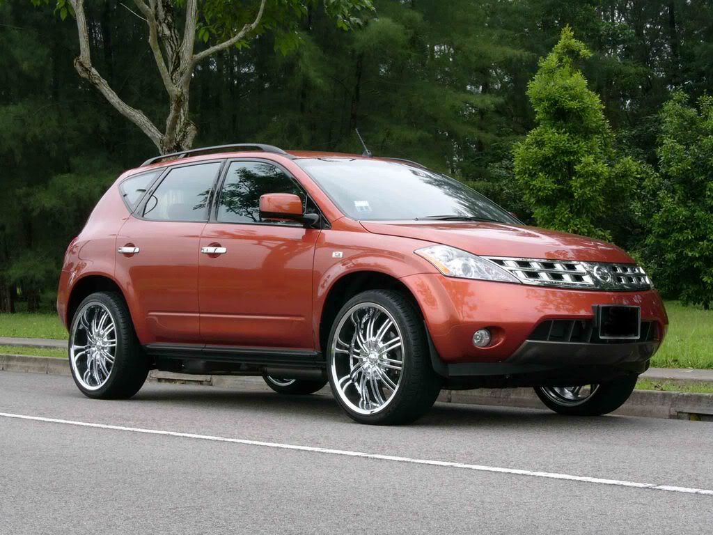

I'll put up a pic to share of my Mu w. 22" rims in my next reply as I did not like the small image I've uploaded to Image shack previously.

Here is the pic of my Mu with 22" rims.
K
kazama
WOW ! very very bling and big rims man. Any mods on the Murano ?

Sillbeers... for a moment there your Murano can pass out as a hot rod LOL... nice!
sillbeers15
Gunner93,
Thanks. I just wanted something different, so I opted for a 'big and tall' vehicle.
