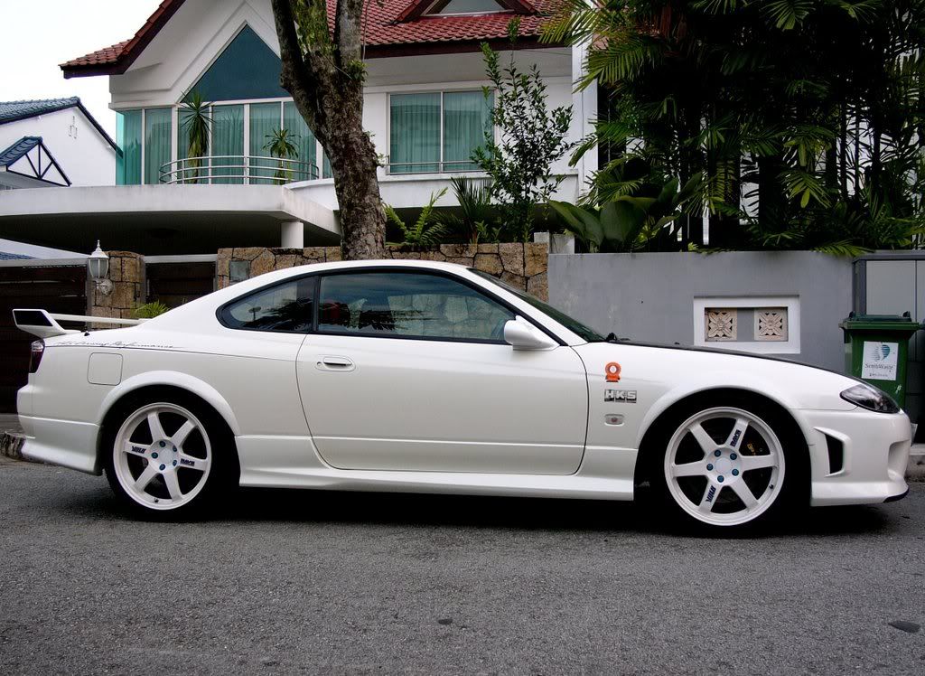

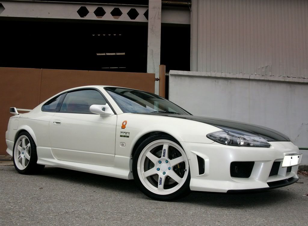

Front right view.
Rearview.
Sideview.

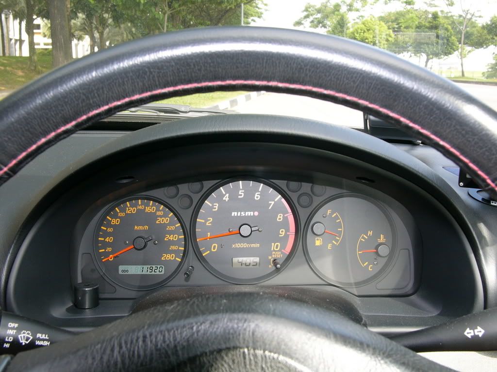

NISMO 280km/h instrument cluster.

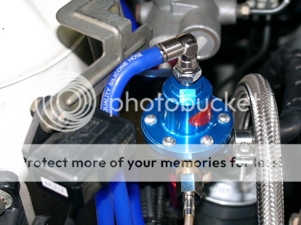

New Sard FPR, R34 GT-R Fuelpump, Borsch filter, steel braided hoses installed.

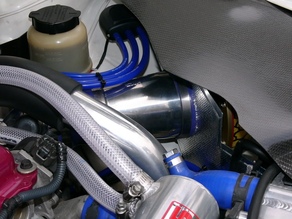

New HKS 100mm Suction Kit + Filter.

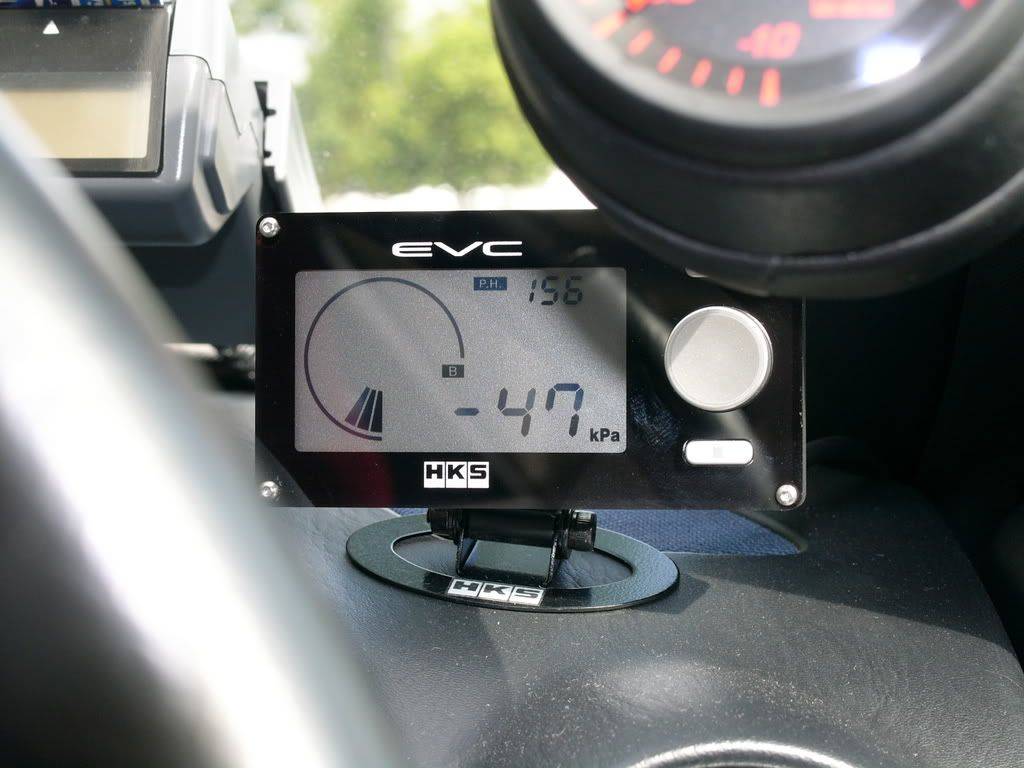

New EVC (VI) to tinkle with....hehee!

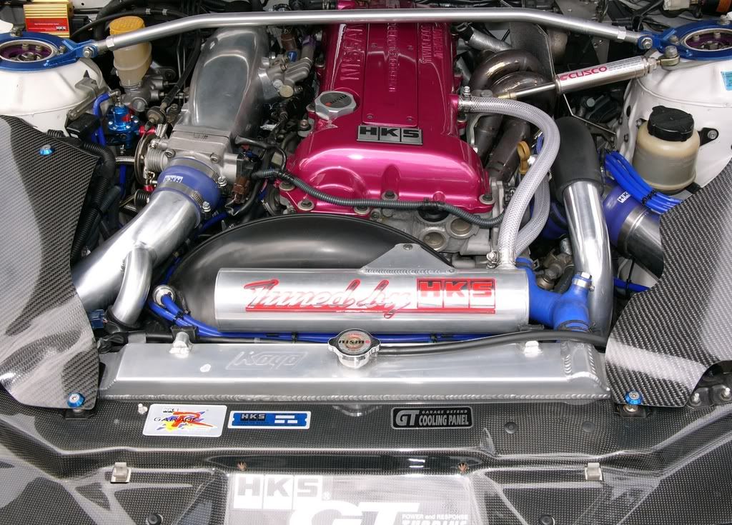

Engine Compartment updated with newly painted rocker cover and new IC pipes.

i've replaced the stock boost gauge with a HKS boost gauge b/c the stock gauge can only display upto 1 bar boost. Same reason for me to replace the instrument cluster with a Nismo 280km/h item.

I'll be placing my EVC in a less obvious location after I am settled with the boost setting and readings.

So HKS has released a new CAMP. :)
I bought the Greddy intelligent informeter. Will have to look up the Greddy and see what it monitors :)
You have lots of space to fit the EVC and maybe the CAMP 2 unit depending on size under the stereo :)
Edit: Just read up on the CAMP 2 and unlike the first edition this is integrated into the navi or dvd player screen.

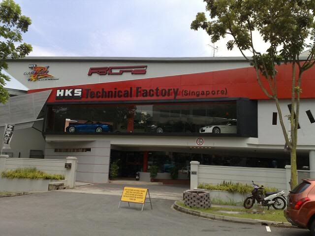

HKS Technical Factory Singapore (Garage R) did the installation and tunning job for me. U can see the tail of my other Nissan in the pics..hehee.
The installation and tune for F-Con V Pro and ....came to SGD$11k.
The value I've paid for are more to the intelectual property rights the tunners have and the direct access to data and support from HKS Japan.
