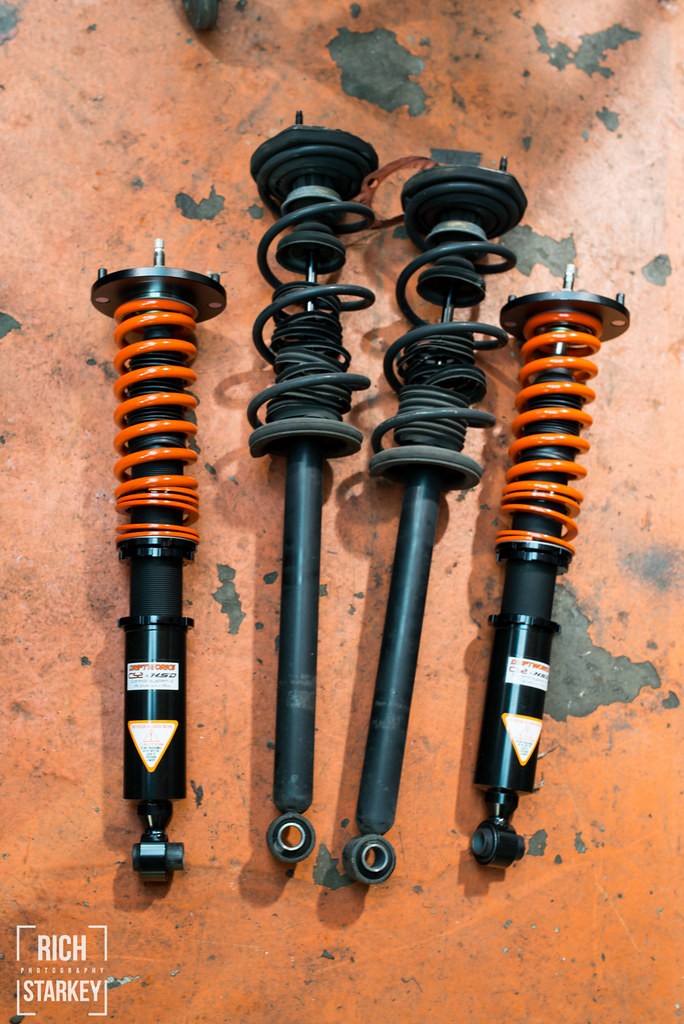

The car started slowly with just a new set of CS2 coilovers fitted to start with.
Stock ride height
_DSC2596 by Rich Starkey, on Flickr
_DSC2595 by Rich Starkey, on Flickr
_DSC2594 by Rich Starkey, on Flickr
CS2 vs Stock

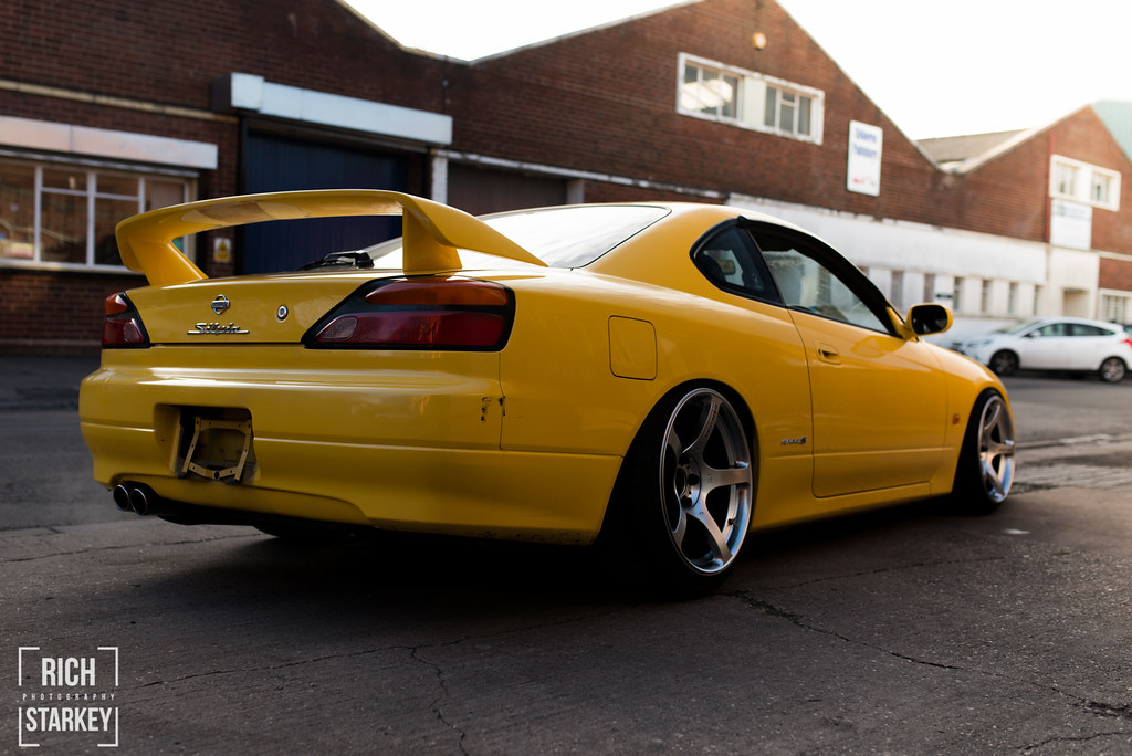

So with the new coilovers fitted I test fitted a set of the new Cosmis Wheels that we had just received, 17x9+15 front and 18x9+15 rear. Went straight on with just the rear lips flattened on the back, the front needs more camber to completely tuck the wheel
_DSC2645 by Rich Starkey, on Flickr
_DSC2736 by Rich Starkey, on Flickr
_DSC2745 by Rich Starkey, on Flickr

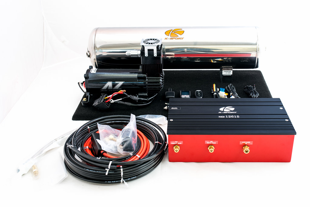

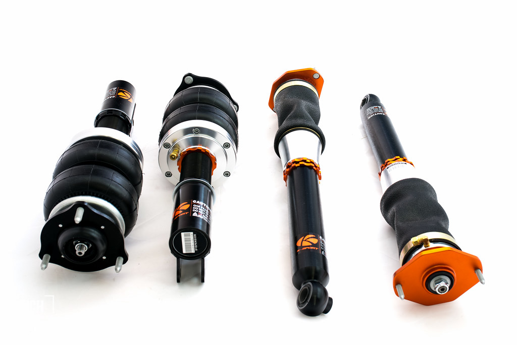

So I decided to put the S15 on air suspension and an opportunity came up to put a set KSport Airride on the car. The kit comes with an electronic fob that can raise and lower the front and rear of the car independently. The kit came with everything you needed.
_DSC3169 by Rich Starkey, on Flickr
_DSC3170 by Rich Starkey, on Flickr

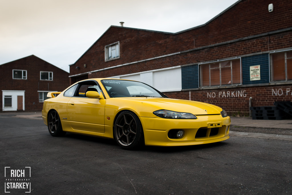

Fitting was easy, the only problem was the front clearance on the airbag, the cosmis wheels needed a 15mm spacer to clear (making them an effective 0 offset) so the standard buddyclub P1 went back on (still with a 15mm spacer)
_DSC3338 by Rich Starkey, on Flickr
_DSC5864-Edit by Rich Starkey, on Flickr

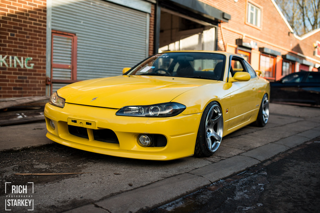

Unlike most scene kids I am using the airride to get over speed bumps, not hard parking so im having to get the ride height and alignment setup for driving height (as shown below)
_DSC5853 by Rich Starkey, on Flickr
_DSC5852 by Rich Starkey, on Flickr

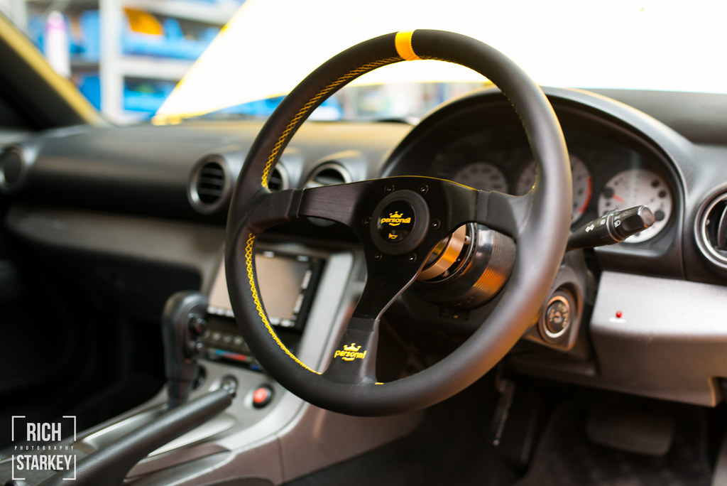

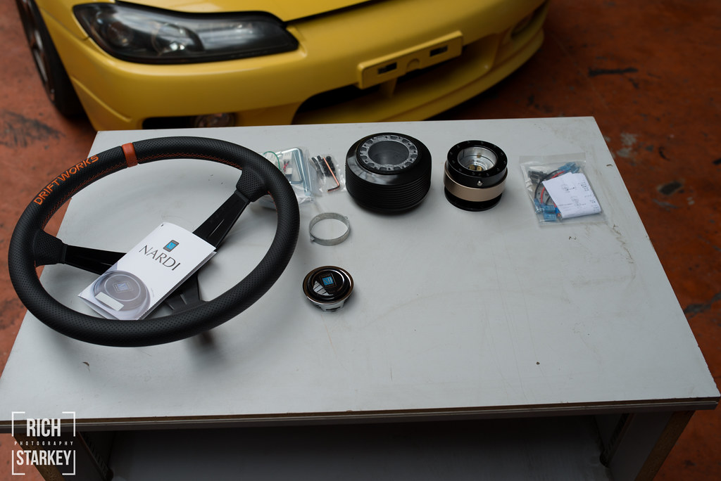

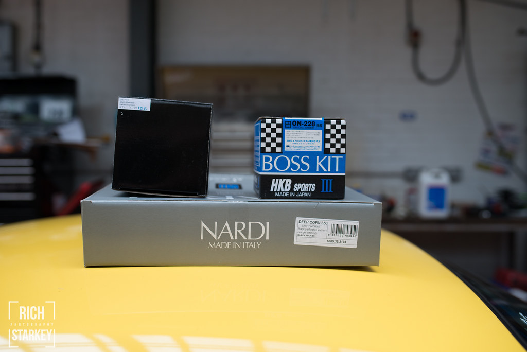

The final part of this instalment is adding a Nardi/Personal wheel to the S15 along with a snap off boss
_DSC6209 by Rich Starkey, on Flickr
_DSC6211 by Rich Starkey, on Flickr
I was originally going for a Deep Corn Nardi but it made the wheel sit too close to me so change it for a Personal Trophy leather wheel.

Need to keep us updated on the air ride. Is it silly money?
4,640
I have been looking at air for mine to save my kit ha ha what sort of money would that kit cost? How is the ride on air too? S
11 August 2015
9
Birmingham, Uk
Depends, the kit on my car is close to £3.5K and its pretty good. Depends on what you are going for.
I use it every day for work and its as comfortable as reasonable coilovers but i drive it lower than what most people would do so maybe better at a higher ride height (bag pressure is similar to spring rate) On max low it sits on the chassis rails and you cant move off, also the rear wheel has silly camber.
Its great for getting into car parks or over speed bumps, the remote has 3 presets and takes seconds to get to the desired ride height. I will be selling it and going back to coilovers as I aim to do some track days in the future.
4,640
That's the thing I want to be able to drive my car fast still and not lose the handling it has now but this kit sits low ! Even in comparison to my c west ha ha so I need to find a way I can run it lowish, handle well and not destroy my kit . kW do a lift kit for the front shocks that might be another option. What sort of money would you be after for this kit when you shift it bud?
