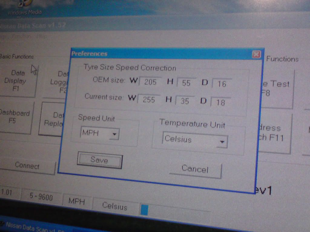

Yeah, if you want a bit of stretch you could do with wider rims. If your worried about your speedo going out it's simple to sort out. If you plug your laptop into your consult port with nistune software installed you can alter the tyre size and the ECU corrects the speedo reading.

Sorry, I mean Datascan, not Nistune. I'm running 255 35 18's on the rear and the speedo has an equal difference to the sat nav all the way through the speed range now I have sorted that out.
Heres a screen shot I just took..

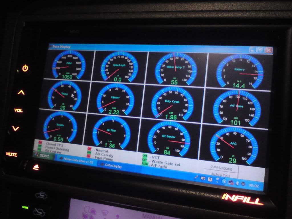

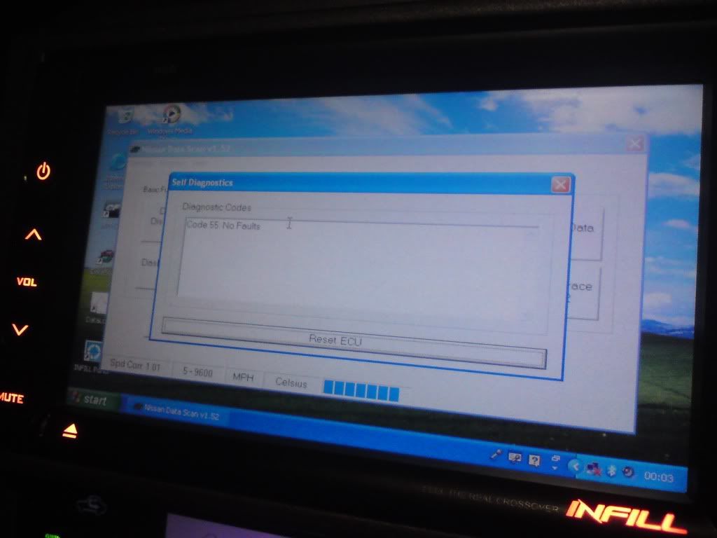

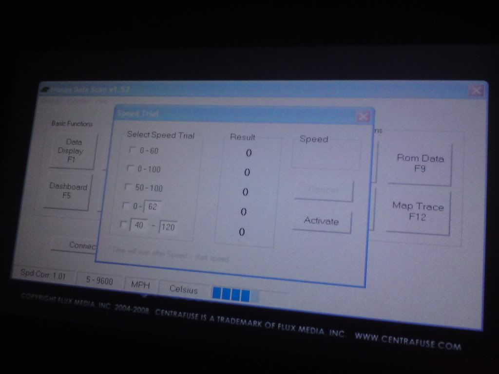

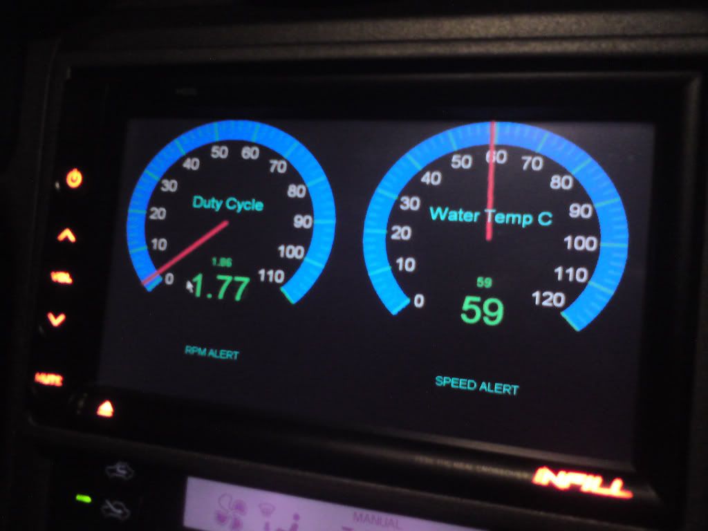

Erm.. loads mate! Everything from self diagnostics to fuel trimming, data logging, data scanning..
Here are a few more screen shots..
