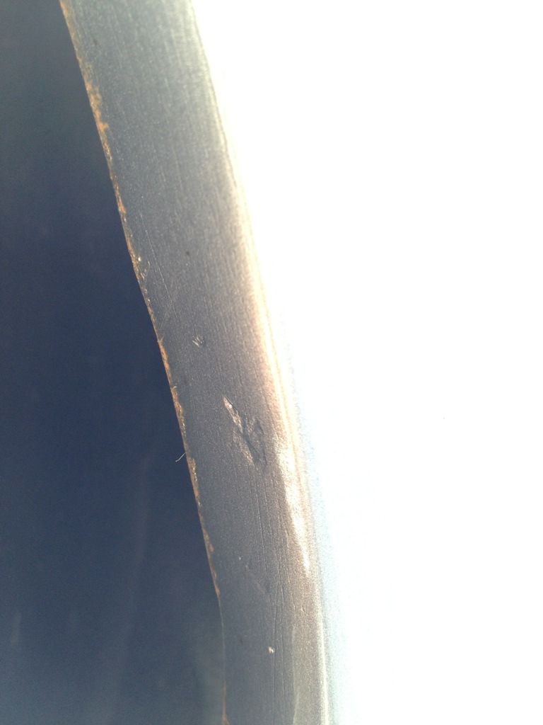

Don't think the rears are going to work, went to a place to see about getting the arches rolled today and there's filler in the arches which will crack if they try to roll them. Fronts are done but not sure what to do now to be honest...

How sure we're they that there was filler in them? It's hard to tel from pictures but looks pretty straight!

They said there were small hairlines where it had been smoothed, I had a look and could see them when they pointed them out, don't think it's worth a punt though as if they have been fillered as some point and do crack then it'll just result in an expensive spray job. I'll see if I can get some pics.

Got a few pics, let me know what you reckon. It all looks like metal to me but I'm not an expert so what do I know...

You don't have to cut up the rear fenders in order to "fit" 9.5 wide rims. A roll with a smooth pull would make it fit. The offset on those rims you selected would mean you'd have to crank dat camber, in order to make them fit. I would have started at +22 personally....

I'd be more than happy to get the rears rolled and pulled slightly if my mind hadn't been poisoned with the possibility of filler and an expensive paint job if it did go badly.
I think I'm gonna try the pair of 8.5"s on one side and see how it fairs before I go sticking tyres on the 9.5"s.
