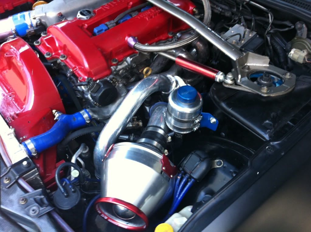

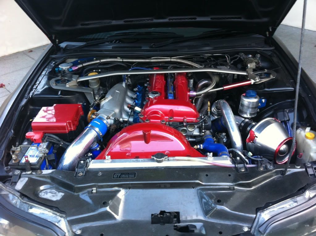

ENGINE
CP pistons 86.5mm 9:1 compression
Brian Crower conrods
Tomei head gasket
Arp head & main studs
set of 16 brian crower stainless steel valves, intake: 34.15mm, exhaust 30.15(all standard diameters)
set of 16 brian crower ti retainers & single valve springs
16 supertech valve seals
ACL race and main bearings
New nissan crank shaft
Tomei poncams 256/256
Garette 2871 turbo, with Tial VBand Exhaust housing
Mazworx screamer
Tial 38mm external wastegate
Mazworx oil bloc

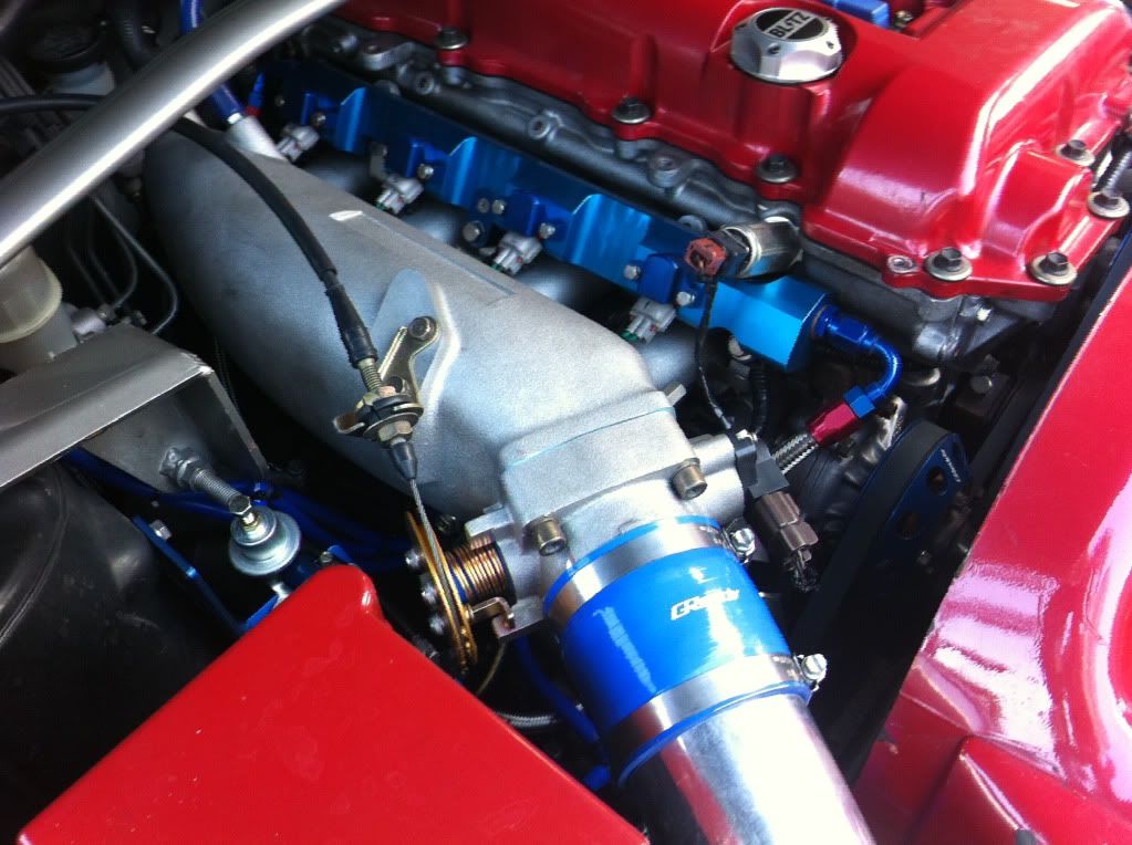

Power enterprise 850cc sidefeed injectors light purple x 4
Greddy intake plenum and naprec 70mm throttle body
Greddy piping from throttle to intercooler
Border fuel rail + fuel delivery kit
Walbro fuel pump 255L/hr
New nissan water pump Feb 2011
New nissan oil pump Oct 2011
Cusco oil cache tank
Nismo Flywheel
Maz downpipe
Spitfire coil
new O2 sensor 2010
HPI engine damper
Greddy pulley kitPower Ent belt x 3 (fan, A/C, power steer)
Blitz engine oil filler cap
Tomei Rocker Arm Stopper
Nissan VTC and VTC solenoid new replacement
new nissan timing chain kit feb 2011 USD225 - not installed
new complete nissan engine gasket kit
INTAKE/COOLING/EXHAUST
Blitz front mount intercooler
ARC radiator - need to change
Blitz sus power intake
Blitz supersound vd blow off valve
Fujitzubo exhaust
Mocal oilcooler
Mazworx equal length coated exhaust manifold
Greddy oil pan
Nismo low temp thermostat 62deg
Billion Racing power steering tank
R33 8 shroud clutch fan
Greddy intercooler hotpipe kit
AEM meth/h2O injection kit, using mid size nozzle, check valve and filter

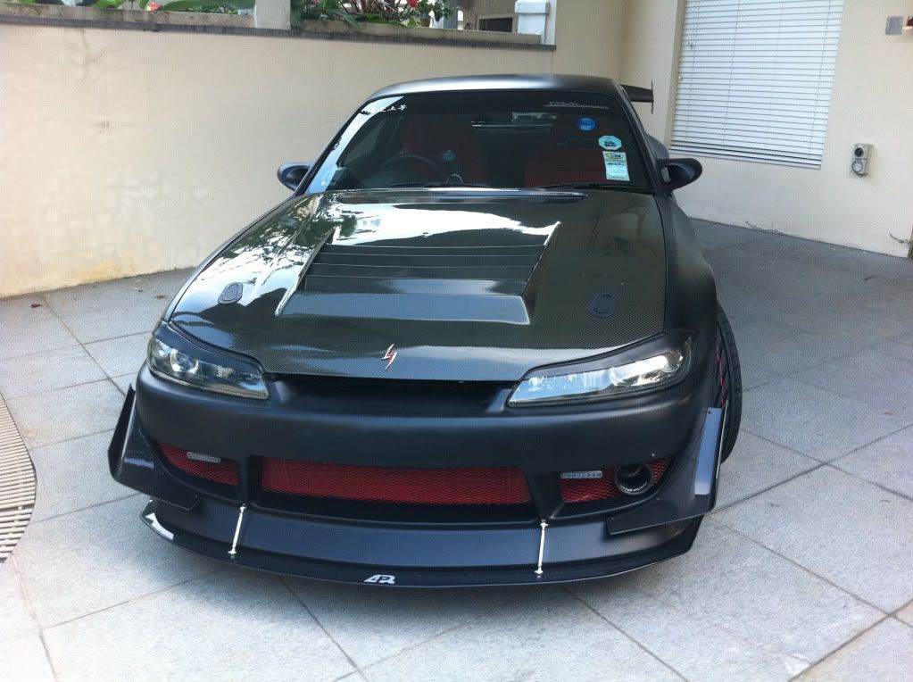

Matte Black
D-Max Aero Carbon Bonnet
D-Max front wide fender 30mm
D-Max rear wide fender 50mm
D-Max GT carbon Wing 200mm Height, 1600 width
D-Max front Bumper
D-Max sideskirt
D-Max rear Bumper
Granador mirrors
Aerocatch bonnet catch
Charge Speed Carbon boot
Vertex eyeline

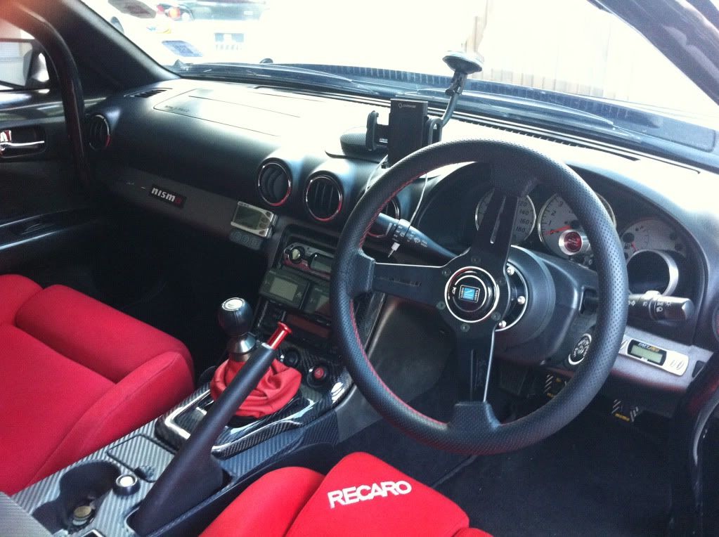

INTERIOR
Recaro TSW carbon seat with Recaro Rail and mount
4 point Sabelt harness in black special alu adjuster
Nardi 330mm classic steering wheel
Works Bell short boss and Rapfix GTC ball lock system
Momo Pedals
Cusco Safety21 6 point Roll Cage
D-Max Carbon Door Panel (interior)
Red leather gear gaitor
EP racing Carbon stereo panel
EP racing Carbon Door sills
Piaa 20 & 21" Silicon windscreen wiper with spoiler
Piaa 18" rear wiper

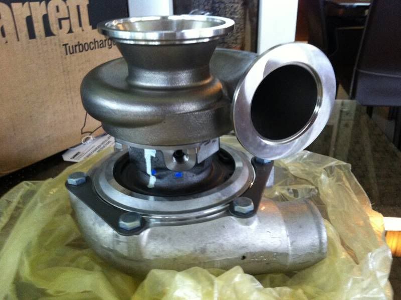

Not yet , thanks to this wonderful resource and sharing of info I've got 2 more sets of upgrades. Mazworx vband and top mount turbo conversion with equal length exhaust manifold(thanks to ichigo300), and the aem meth/water injection that hypnotik has done.
Both kits are ordered. Actually doing these earlier than I expected. But might as well since I blew 2 turbos in a week! Had to thoroughly check what the problem was and got the garage to throw in a free tune as they guaranteed to solve my 1st turbo problem. :) catch up with you when I am bck.
31 December 2009
162
Sgor Mansfield

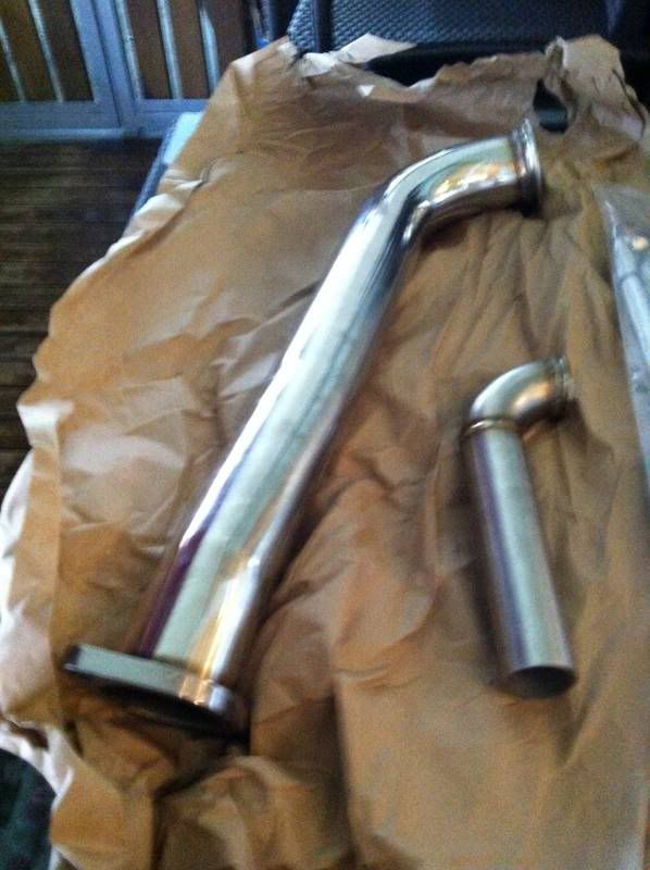

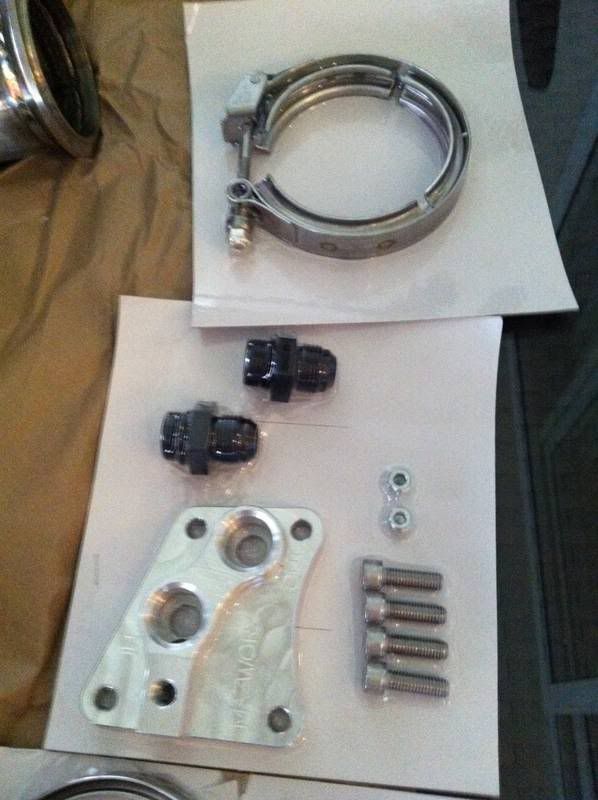

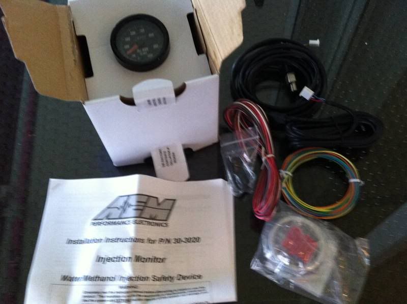

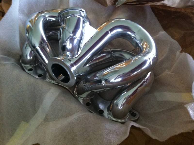

parts have arrived! 2871 Turbo with tial housing vband
Maz equal length exhaust mani
Maz oil block
MAz screamer and downpipe

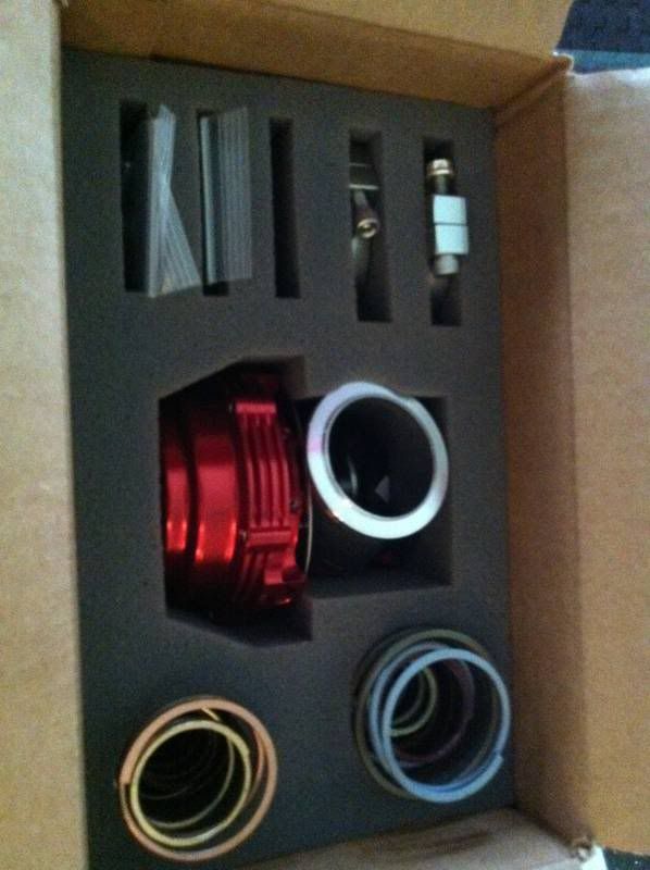

tial waste gate

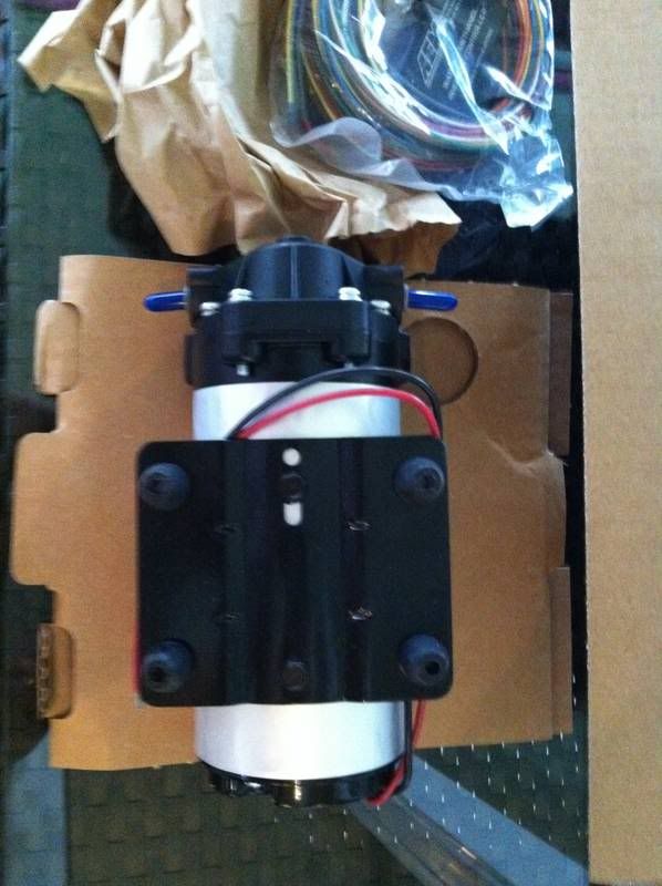

AEm meth ingection fail safe device, flow meter
and pump

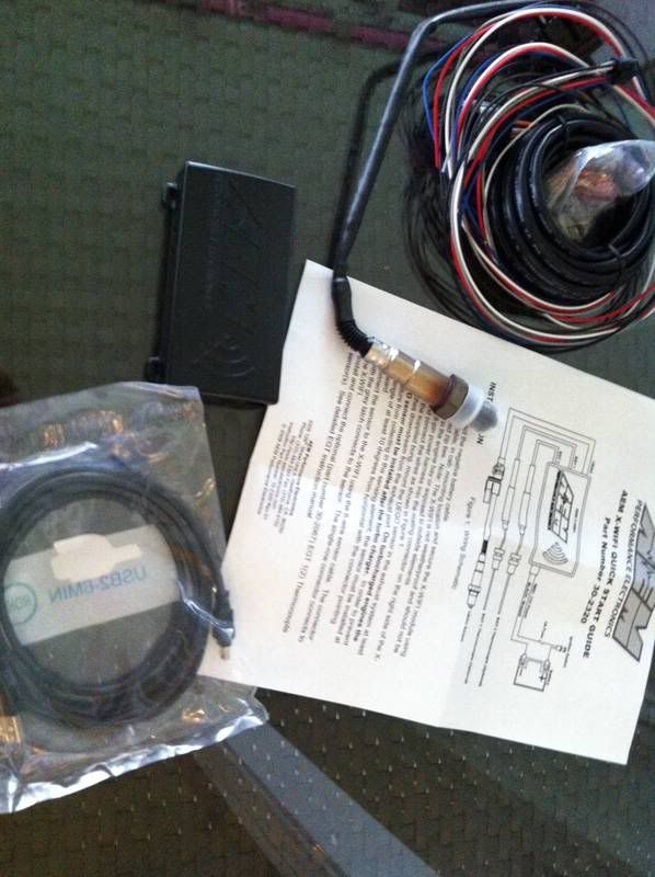

AEM X wifi wide band afr
sorry for the poor pix, photos taken by a very angry wife! haha....have sent these off for installation. :)
