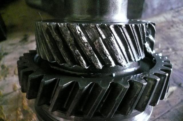

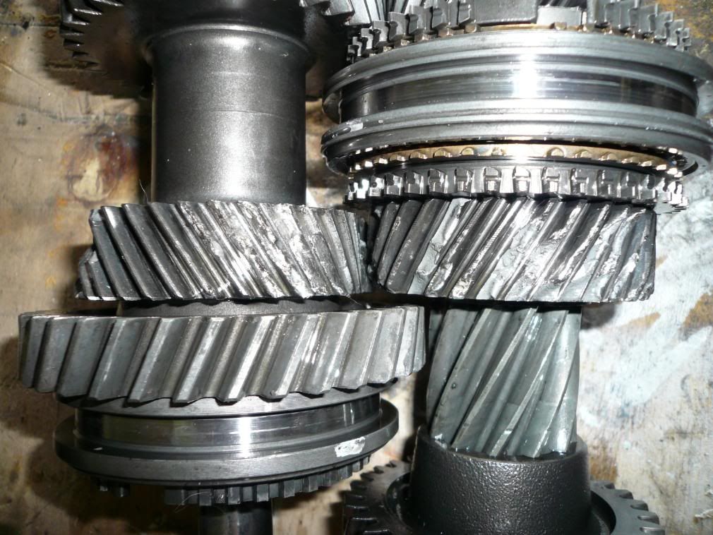

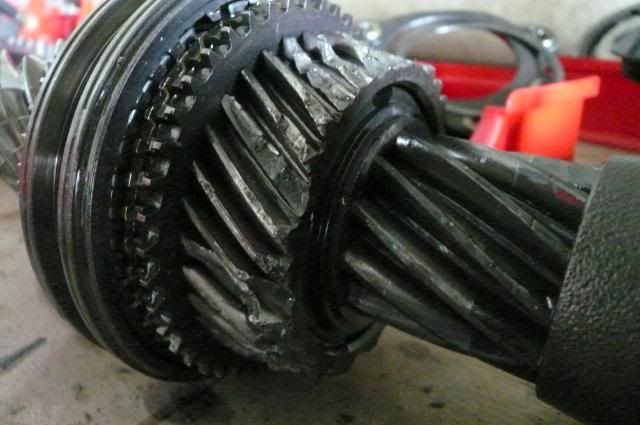

I took the gearbox apart to recondition it and keep it as a spare and this is what i found

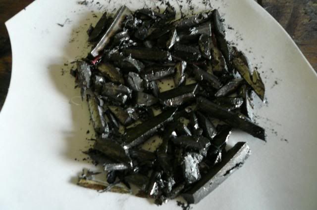

When I was opened it this fell out
This is what I found inside :annoyed:
The circlip never moved
Mainshaft :furious:
This is what big power does to a gearbox

damn! Just out of curiosity what kind of power are you pushing out to destroy gears like that?
:wave:
The car is making about 400bhp at the moment but I have plans for more when I get the gearbox sorted out .

whats your plans now for the box as the main shaft is fooked...?

Ouch. That looks expensive!

might as well up the spec... if you gonna rebuilt it its judt gonna happen again.
