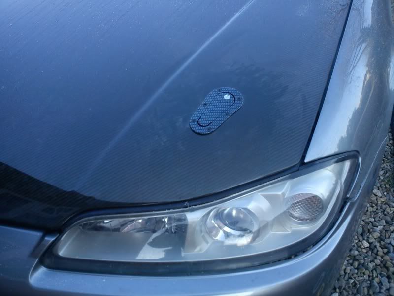

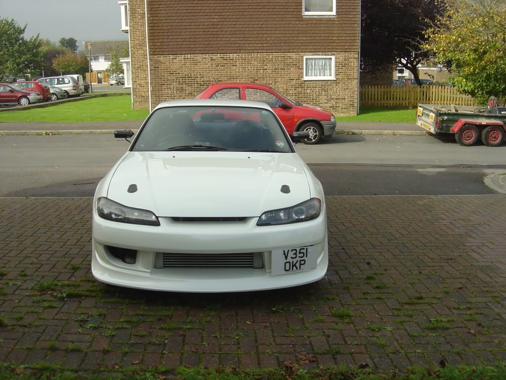

I've got aero catches on mine as the FRP bonnet was flapping around without them, I should be able to post some pics later
Have a look at ichigo's signature pic above Jase ^^^
Mount them where he has lol :wack: :p

Mine aren't the locking type but I also have a working original bonnet catch, so it's still lockable.
Will try and post some pics with the specific location of the locking pins.
The only thing on mine which is a pain is the alignment of the Aero catch and the pin has to be perfect for easy opening, mine isn't and i'm talking just mm's here, once you release the aero flap the pin should automaticaly release, on mine you have to put pressure on the bonnet just below the aero catch to allow the pin to release, not a biggy but i'm also not a fan of bending my FRP bonnet.....
Jase, the best advise i can give is the old classic of measure twice cut once, otherwise you might find they lock but don't unlock at all :wack:

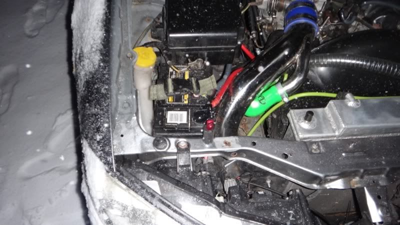

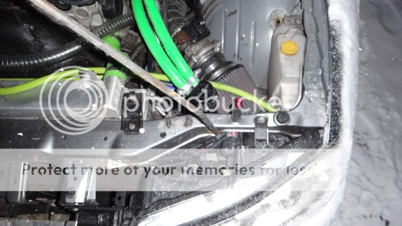

As promised, heres a photo of the Aero Catches fitted:
Taken about 6 hours after fitting in bright sunshine. Bring on the snow!
slightly better photo, but not really. I was freezing my ass off and couldnt be bothered spending time on the photos haha.

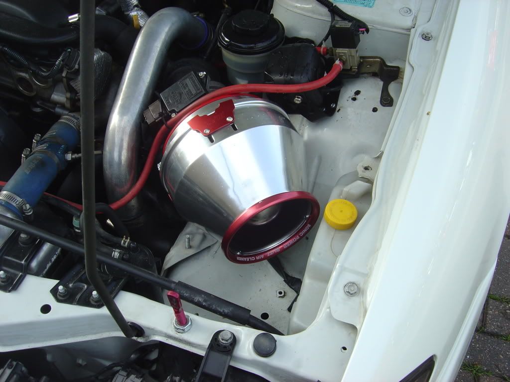

drivers side pin:
passenger side pin:

Have you got a note of the measurements you made?
I fancy giving this a go.
24 November 2009
1,121
North Yorkshire
Looks good bud :)
i made measurements initially, but then when i remeasured, they kept changing and its impossible to get exact measurements because of the slope on the bonnet. you'l see what i mean when you come to fit yours..
easiest way i found is to use the existing holes on the frame for the pins. stick a marker pen in them holes pointing upwards, then close the bonnet. and hey presto. one exact pin dot! then drill a hole from the bottom up, through the marked dot. then close the bonnet and look through the hole in the bonnet and check its lined up with the hole on the frame. if its not, redrill, and keep going til you've got perfect alignment. then stick your catch template around the mess you've made, line up the pin hole on the template, mark the bonnet, and whip out the jigsaw! simples!
