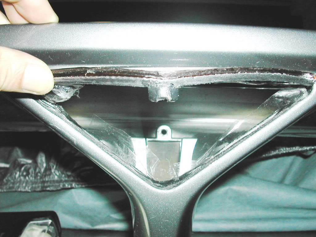

I finally got the stubborn screw out. The unit is still firmly stuck on the spoiler until I poked a wire through the screw hole and guess what? There's nothing in there except a brake lamp cover stuck with sticky tape all round the sides. I guess the previous Jap owner really buggered this up!

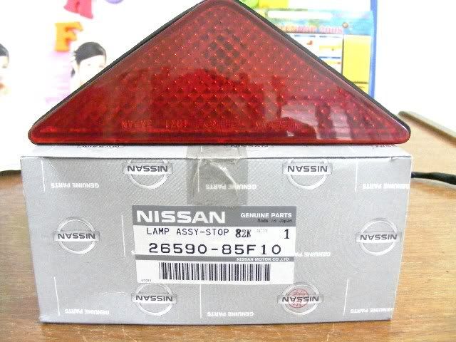

Perfectrun :)
Part Number:26590-85F10-
Description:LAMP ASSY-STOP

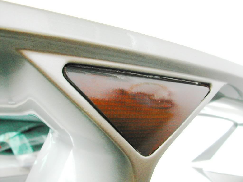

Here's the aero stop lamp on my rear. Looks like smoked cover?
Sure could have fooled me but theres no bulb inside.

I'd just spoken to my local importer. Apparently the JDM aerospoiler -brake lamp is only a reflector/dummy cover. It needs to be custom made into a third brake lamp. Not sure if the part no. comes as just a cover only? Any idea?
I've rechecked FAST, and it appears to have the same part number for all three different high level brake lights... :wack:
Here's the separate PNs for the bub holder and bulb. Remember that wire has to somehow get from the holder, through your boot lid and into the boot...
Part Number:26597-85F10-
Description:SOCKET-STOP LAMP
Part Number:26261-89917-
Description:BULB-STOP LAMP
The bulb is an 18W 921 type.

Update...
Managed to take this pic to show what I meant. You can see the screw hole, its empty. Well I suppose the Lamp Assy is standard fit for S15 aero spoiler. I have placed an order from my local importer. Sure hope it fits when it arrives. Fingers crossed. I will update again.

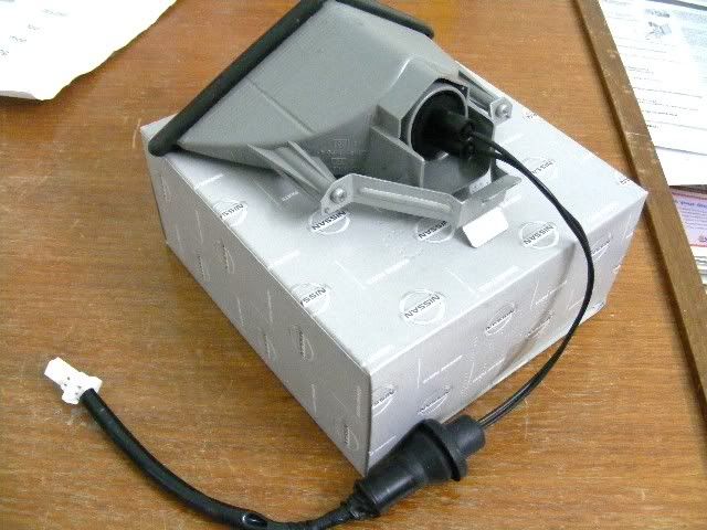

Update :
Heres whats arrived today finally from Japan.
Comes with the harness and bulb as well. Fitting it on my aero spoiler tomorrow.
