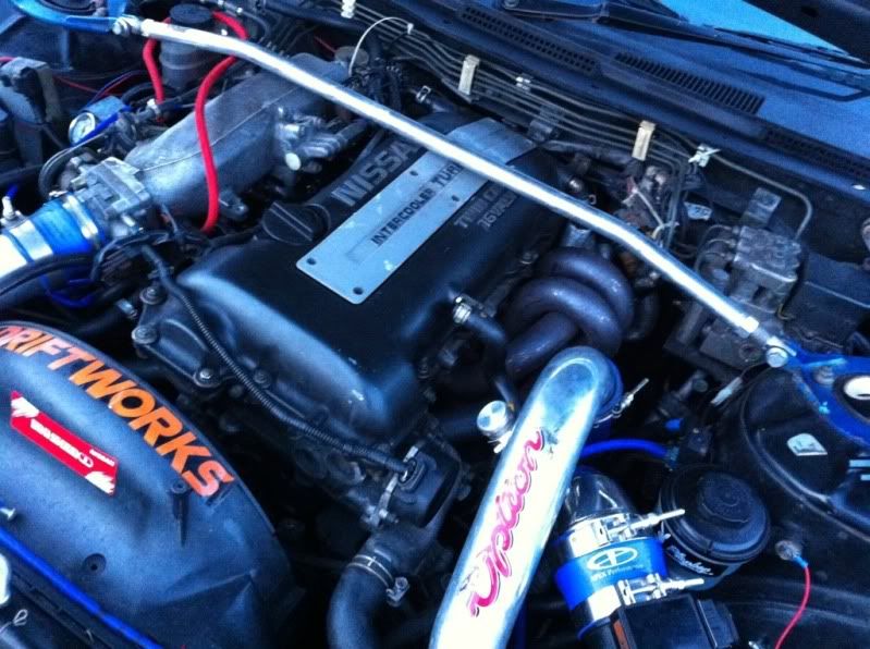

The pipe from the actuator goes to the left hand side of the boost sol. Then the feed from the plenum should be pointing strait at you. ill try find a pick for you of mine.

boost pipe from actuator is black with a little blue tape on it. Blu pipe is routed to plenum . :)

Thanks for this. Was how I had it though. I'll connect it back up at some point not sure when now weekend maybe and see what happens.
When you say plenum do you mean intercooler pipe?

There is 3 pipes underneath the throttle body. Use one of those. You could use one off an intercooler pipe if you wanted . Most use one of these though.
