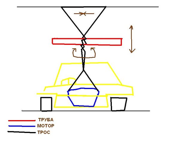

And so from there is nothing (after work by itself) and on "it is weak most"! Has changed the motor! Changed in garage of the friend, without an electricity and special tools! To pull out the motor it has appeared where easier than it there to thrust, thus without having what lift, a "goose" or even //////!
Tooling for swap): 1 jack hydraulic ! 2 jacks manual (stock there is in all cars) 1 cable towing (years 80th) 1 pipe of centimetres 120 and modest set wrenches keys and heads which constantly replenished as required!!
Long puzzled with the friend how to pull out the motor!
So have lifted the car above jacks on each side, have propped up jack hydraulic under a box, have adhered the motor to what that to armature in garage sticking out of a ceiling, all have turned off, and have lowered the car! Accordingly the motor remained to hang on a cable! Further on hands have pulled out it for side-altars engine bay (do not repeat it of the house a back till now is ill)))))
And here back to thrust the motor so it has not turned out... Therefore having thought a little more.... Here in general that scheme)))))
Rotating a pipe (it is designated red), put between a cable (Black), there was a possibility to lift and lower the motor (dark blue)! For the account from cable fishing in its top part (Arrows brown)!
Further have faced a problem to get the motor to a box (on the Japanese manual - свапят motors pulling out and dragging together with a box, on a bourgeois manual - remove a box then the motor and in return sequence collect, on Russian manual to get the motor in a box))))))).... After 1.30 hours (Ё % "?;; %И Not standard lexicon )))))) ) dance with tambourines and jacks, the mobile phone has been broken for anybody persistently kept ringing (be not frightened it was then glued and to this day works).... After 2х hours... engine has taken the lawful place))))

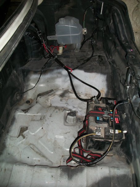

Further assemblage of all of the rest and purchase of not getting details has begun! Namely: 1. MAF 2. intercooler 3. A gasoline pump 4. Every possible liquids 5. down pipe 6. bypas 7. power intake
Since piping intercooler passes through the location batary, it was necessary to remove its platform, and thats why the electricity in garage is not present.... It was necessary to beat out its screw-driver and a hammer))))) (I know barbarity but there was no other exit)
Further simply all has collected together....
The accumulator and washer tank (it a broad tank from Guelder-rose Frets) have moved to a luggage carrier))))
