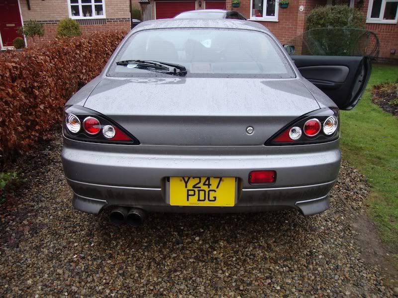

Just bought some nice rear lights off Craig_m on here.. and im puzzled haha.
cant seem to work out how to get to the old ones.
i've removed all the fabric and such from the boot but all i'm greeted with is metal. and no access to rear lights!!
help!! lol
off to tinker now see if i can work it out. but pretty stuck...
this has usually been an easy job on previous cars too... :(

cheers mate, me being unobservant as per usual. by the time im back checking this i've already done it haha.
for anyone as blind as me there are 4 nuts, 2 on the far side (where the indicators are) and then 1 in the center-ish, and another right next to the edge of the boot. i found the two on the far side easy, but the other two were tucked under a metal lip so didnt notice them at first. you just unscrew these, push the bolts through and the light unit will pop out. easy peasy :)

How come your bumper has a fog light cut into it? Dont think ive seen that before
24 November 2009
1,121
North Yorkshire
lol because the original (and only) previous owner used to live in japan, and imported it himself, and due to lack of japanese vocabulary, the guys who fixed it up to make it uk legal decided the best option was to cut a chunk out of the beloved car and slap that horrible thing in. the owner goes back to check on progress and finds that eyesore there... :(
its the only thing that i hate about the car, but dont worry, its getting filled at some point, and the rear fog is off in the drivers side cluster where the reverse is. :)

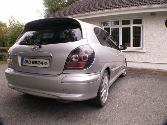

Ahhh that explains it then! Bet he went nuts lol! Yeah same on my car, removed a reverse bulb and put the fog light in its place! :) Lights looking good mate! ...im tempted to remove the rear wing off of mine, i like the more flush look!
