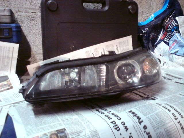

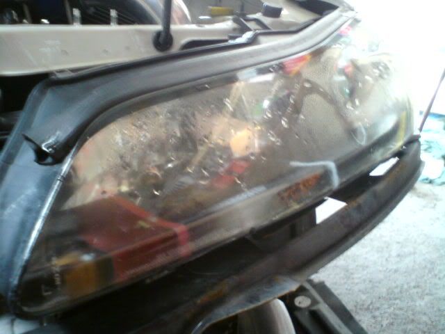

picture of the headlight, some of these droplets are on the inside...
I put the whole headlight in the hotpress for a couple of days to see if that resolved the problem but although it dried the droplets of water , there was still a bit of residue left inside..Next, just out of interest i tried the oven for size..... and no, the light is much to big for the oven so people using ovens to do this must be using industrial sized ovens..

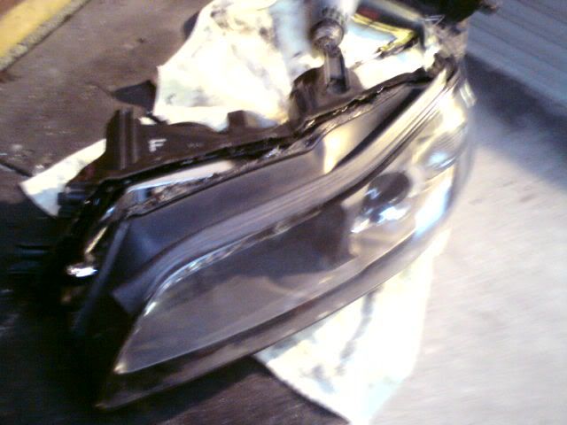

Heat gun it was so, and i started by going round all the joint/seam on the lense case , then broke the seal with a flat head screw driver, more heat again with the heat gun and gently prise apart with the screwdriver and with your hands...
i just want to mention also, you'd want to be some numpty to melt the lense case with a heat gun as i heated mine fairly well and was no where near melting. also make sure you have the indicator bulb removed, as i forgot about this and it'll hold in the lense if not removed

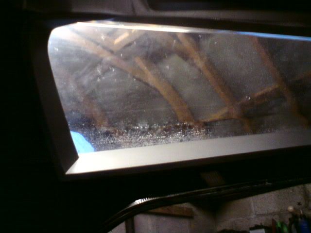

I took this picture looking through from the inside of the lense, you can sort of see some of the residue on the inside

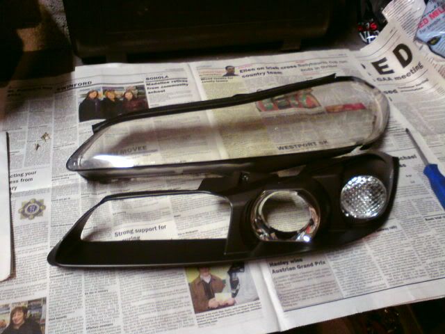

Heres the lense seperated
Then i cleaned ,t-cut'd and polished both inside and outside the lense.. However i was and still not 100% happy with the outcome , but not through any of my work.. the lense itself seems to have very minute discrepencies throughout the lense, in the actual glass/perspex... hard to explain, it was lik it was frosted... if you were looking in , you'd think the damgae was on the inside , and if you were looking out you'd think the damage was on the outside.. anyhow no amount of polishing resolved it..
