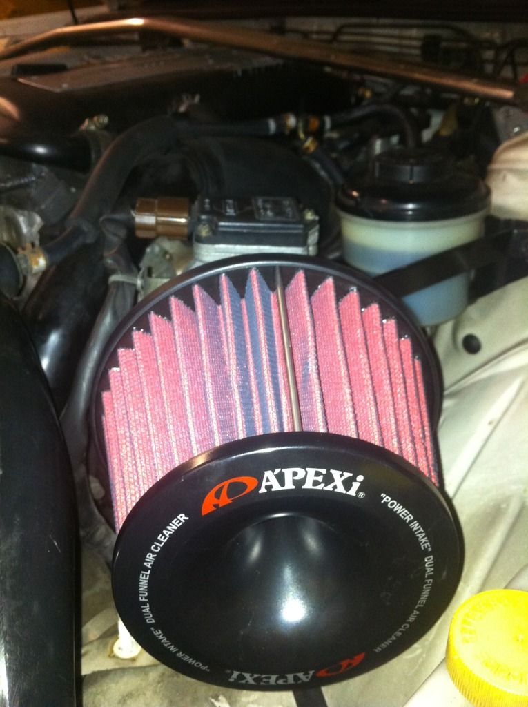

Next up was the Apexi Intake I had bought whilst the car was still in the docks, bought a Stainless Intake from Apex to go with it:
Fitted nicely apart from not being able to connect one of the brackets, not the end of the world.
