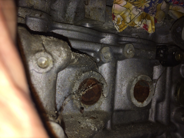

Could you guide me too that bolt? behind the thermostat or something?!
i can't find it and from underneath i have to have 5cm wrists... (and still not able to see it)
maybe point it out?
drifter
4 April 2011
512
10
Norfolk
There's 2 spare holes near the knock sensor
