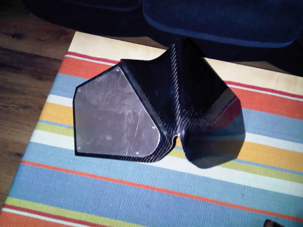

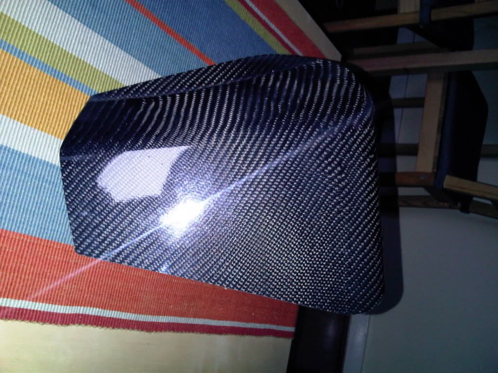

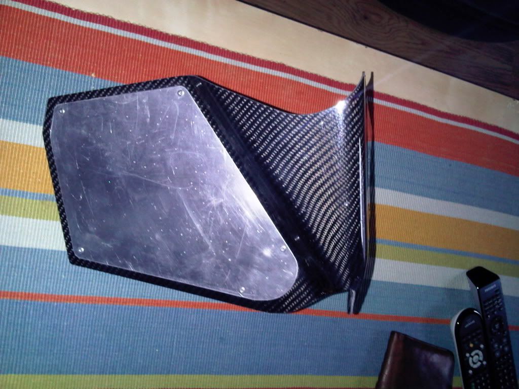

That is what just arrived :
I will be pretty happy to put it in a car, but first - I need to figure out how to mount it without damaging it too much (holes for nuts and bolts). And I need to wait untill rain stops. Had a quick look under bonnet, and there is not even 10 mm space between manifold and abs unit, so hope that will fit. Also I need to undo the strut brace to put it in place. But the quality of shield is excellent, well done Craig!!!!! You should be named carbonCraig :)
Ps. If it stays the way it is after testing, can I keep this one? Or do you want me to send it back? I will update this thread with pictuers taken just after some drifting :)
The guy who made them told me this one had a design fault, that's why it was good for testing. I have not seen it myself (apart from your photos) as I've been in Kenya for the last 4 weeks! If your happy with the quality of it then I'm more than happy for you to keep that one.
When I had my Topstage one fitted there was about 5mm between the mani and alloy plate. This isn't a copy of the Topstage one, it's much better. I will PM you some pics of how mine was mounted. I'll have to design a mounting system for these that is neat and tidy.

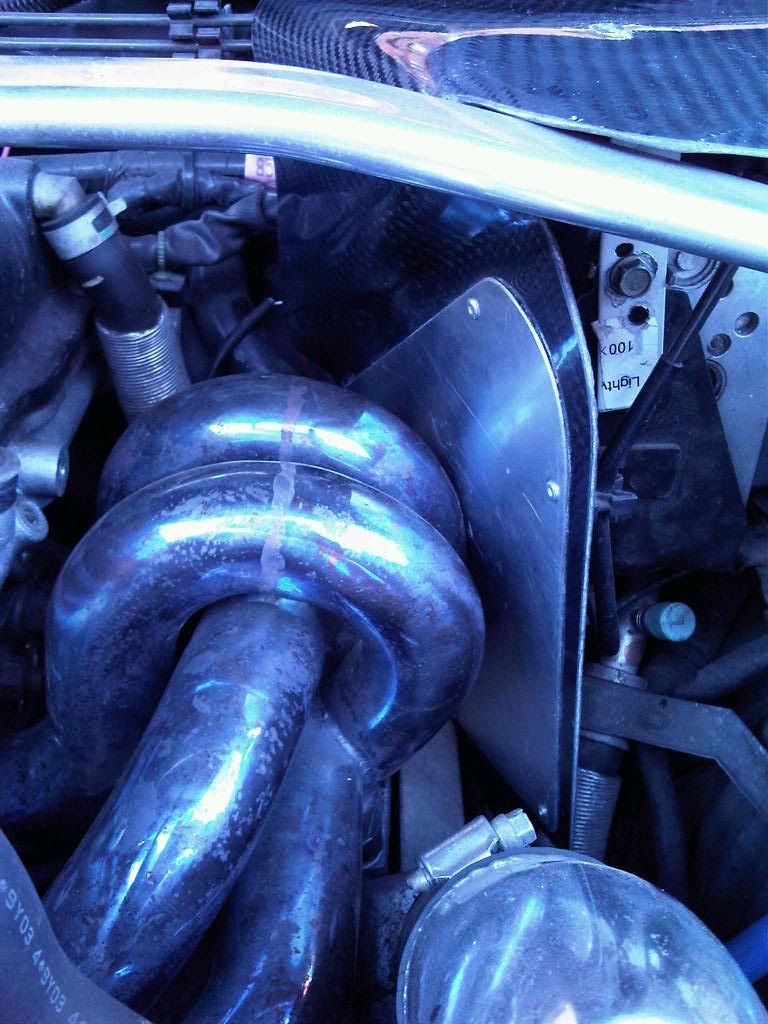

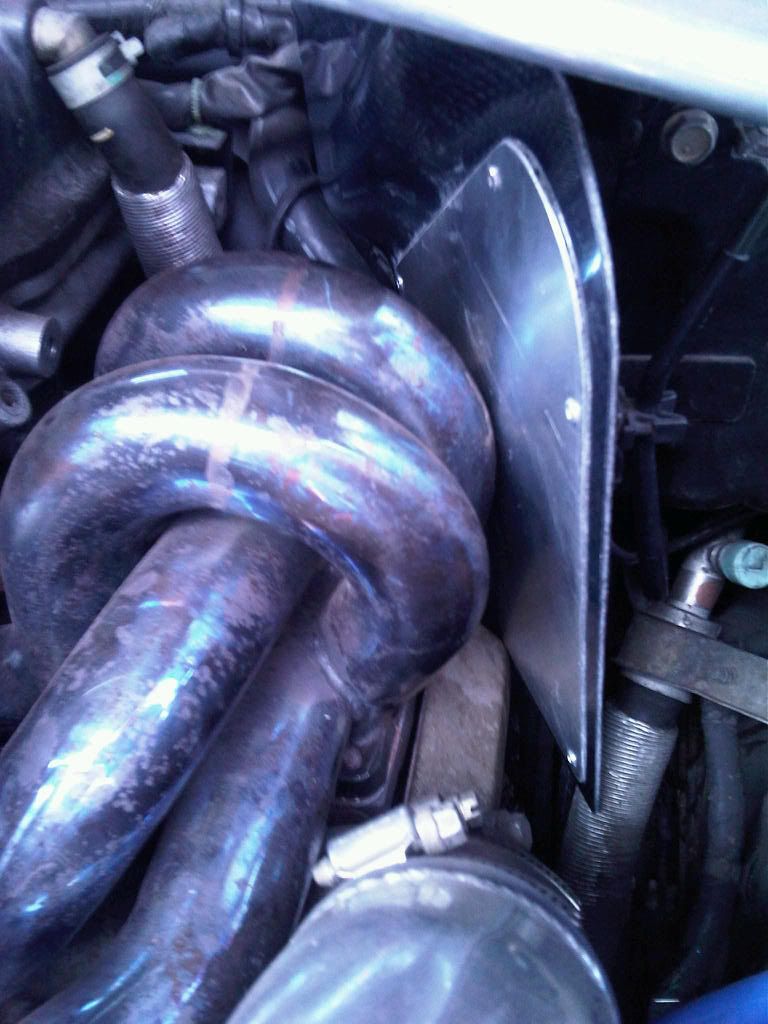

Hi
I have finished mounting and having 30 minutes drive with no problems at all. Tonight I will try to give it better (harder test) to see if anything will deform. Here are some photos:

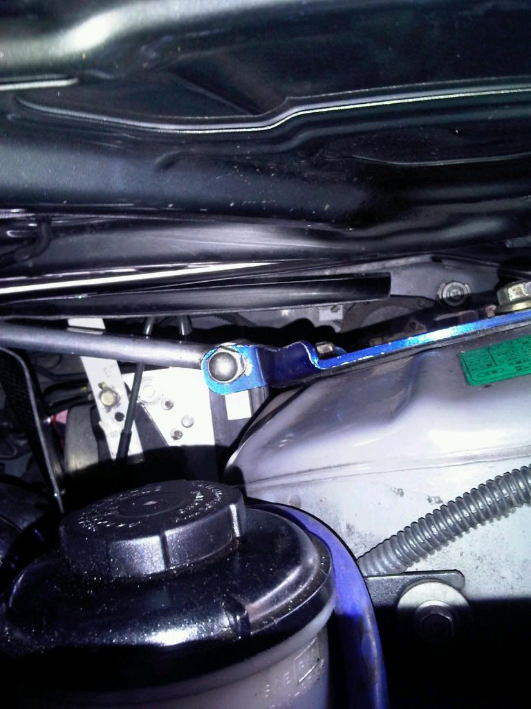

After I hade a quick measure, I decided to close the bonnet and see if the shield isn't in the way, so If you are going to mount it, be careful not to put it above certain level above abs unit, because bonnet brace is very close to it:
So that is all for now. I will let you know how it went with bit of drifting :)

Nice work Greg :)
If you add a bracked to the lower part you could pull it in slightly which will increase the distance between the manifold and alloy plate. Also, you can tuck the top of the carbon underneath the scuttle panel which will give you more room in every direction :)
