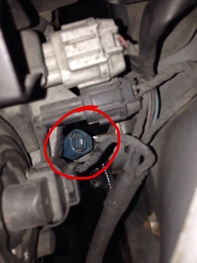

2. If you look just behind you head lights you should see a plug that isn't connected to anything.
3. With abit of wiggling find a route to pull the wires down to the fog light whole.
