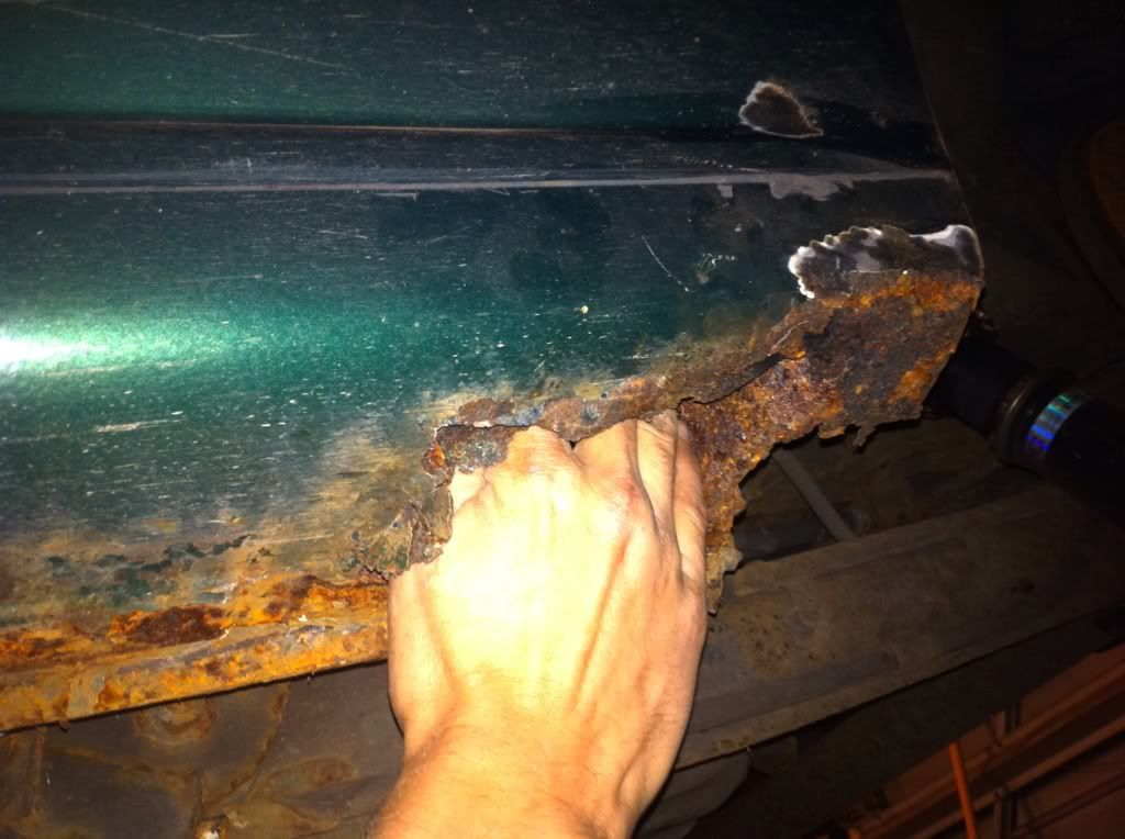

Nice work James. Yours is in a lot better condition than mine! Check the rust!!..

Sh!t Craig!
Dont go crashing her for god sake, it'll crumple up in a pile of dust!
Try and patch her up before your next track session. Don't need to look pretty if it's a track car!

Holy crap Craig!! Not nice but I'm sure you'll get it sorted :thumbs: We must catch up soon!!! :)
