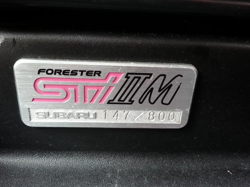

I then took the plunge to finally get a turbo vehicle and my friend sold a limited STi version of a Forester to me. EJ20 all the WRX goodness in a fat fat body
I wish these were LM GT4s - still limited Rays Engineering wheels also however - my biggest regret when selling this off
The Type II M was as I said 'limited' but its value did not hold up - either way I only had it for a few months before I got the DC5 Type R

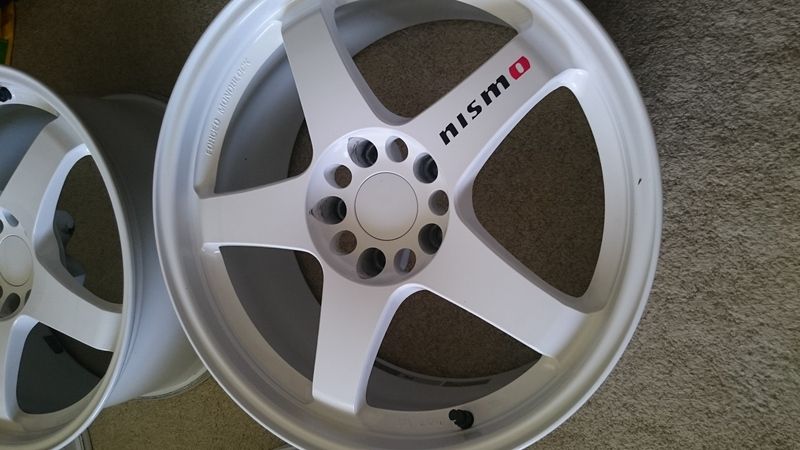

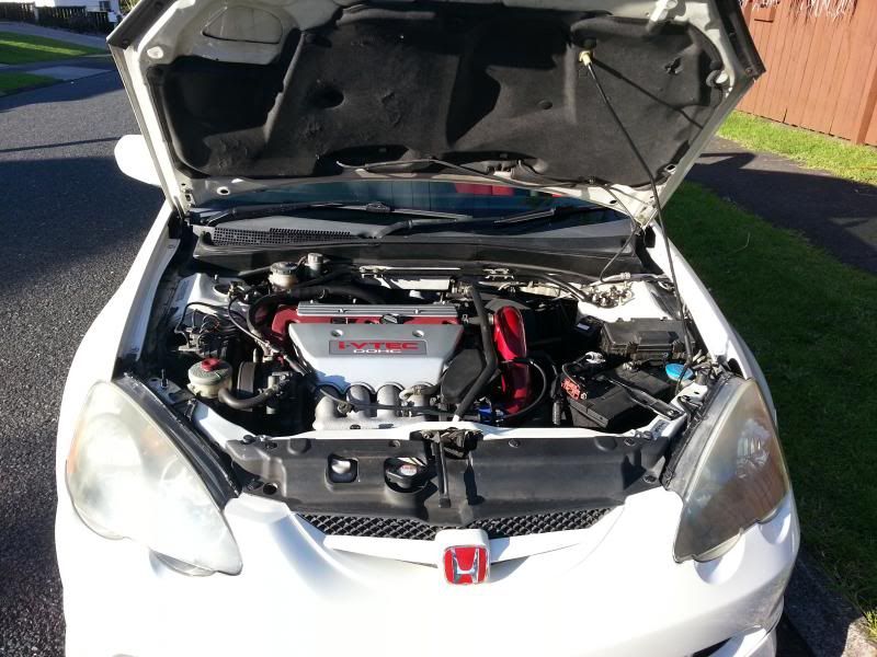

Fully stock JDM Type R 220 HP motor with the lovely Wedsport SA-70 Wheels that came with it for only an extra $300!
But something wasn't right with this car - I couldn't certify the mods for the coilovers here in NZ because of a specific rule against DC5 and EP3s - this weirdly put me off the car as I didn't want to drive something that voided my insurance.
The K20a was a great engine however - especially combined with the short ratio 6 speed gear box - Hondas finally had torque and I didn't have to buy a Euro R or Prelude.
But yes something was wrong - it didn't satisfy me - it was the car I always wanted but it never made me want to go overboard on it or drive it really..

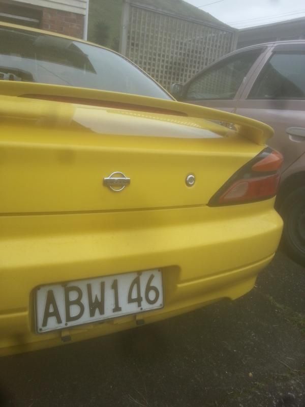

A couple more weeks went by with nothing and finally I took a chance and bought a car without a test drive.
It was a 2001 200SX NZ New S15 in factory yellow with just clocking 100,000ks. It had little description in the classified and had a set of green neons equipped with it. Fully stock with no mods whatsoever.
The neons kinda put me off because it was advertised that an older gentleman has owned it. Its the old 'one careful lady driver' line when the car is fully worked - cept this was bone stock and clean as hell
It was an auction so I bid on it and long story short - I got it within budget and around market price for one. I asked the owner if it was possible to get a pre-purchase inspection and they agreed. Again at this point I am still skeptical as hell because I'm sure this is owned by a teen and being an hour and half drive away from where I live - I had to limit the risk.
Pre Purchase inspection passed with flying colours. I went down and picked it up off an actual older gentleman who had owned it brand new from Nissan and had all the books and service records
Sadly no photos of it being purchased and the classified loses its photos after a few months but here are a few of what it stood on to give a clear idea
I drove it straight home and boy was it fun and the power that it had from factory compared to what I had driven before. It was pretty much a JDM model but badges are different and has a rear aerial and not detuned like ADM models

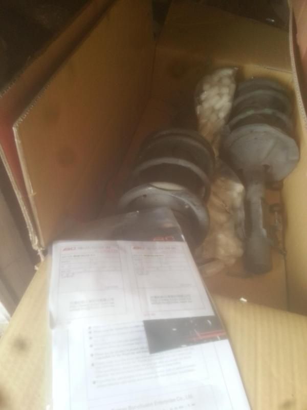

So having the S15 for a few weeks, what did I want to mod first - I also had put myself out there and signed up for a practice skid day at a pan to familiarise myself with the RWD vehicle.
So it was adjustable suspension.
I found a friend who was selling HKS Hipermax II D Spec but doing a bit of research it was the older model and quite dated - I wanted something that could last at least a few years so I went with the BC Gold range from all the reviews I read.

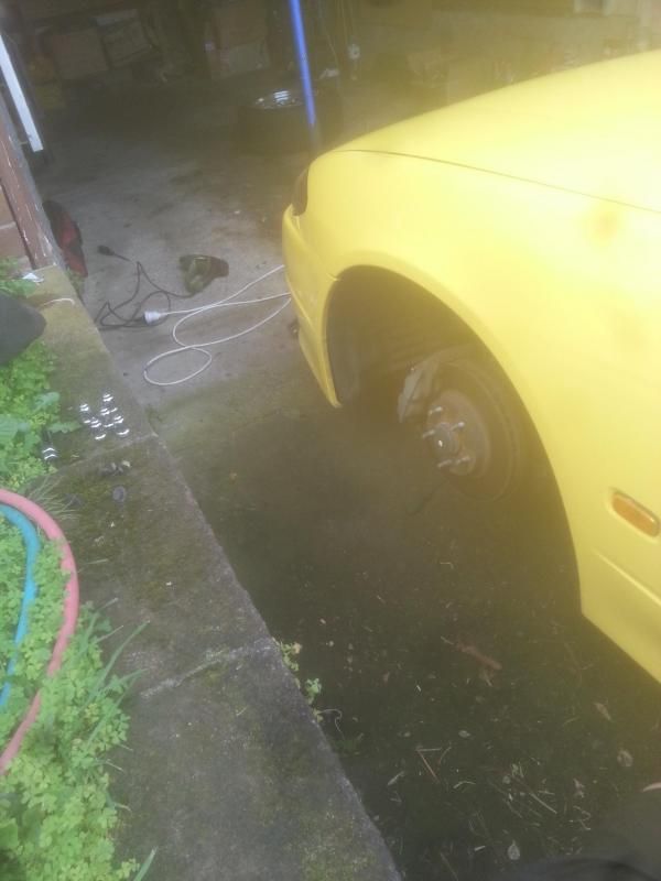

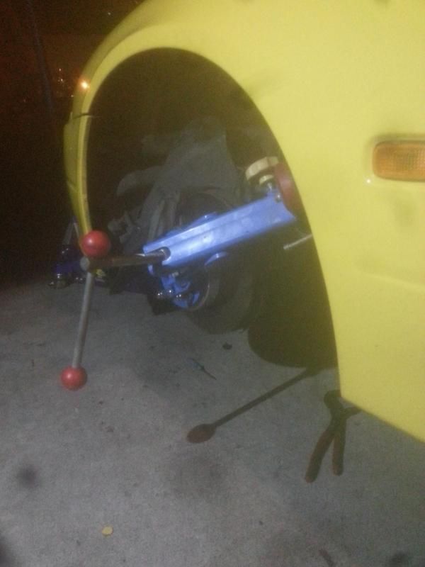

I never knew how easy it was to put suspension in - Just a few bolts and elbow grease and bam they were in. A good friend of mine spent a sunday afternoon doing it and man it felt great to be lower. Handled much better also - less body roll etc.
Here are a few pics from a potato
Old rears out
Fitment was spot on cept with the front brake line bracket needing slight bending to fit properly - otherwise no worries

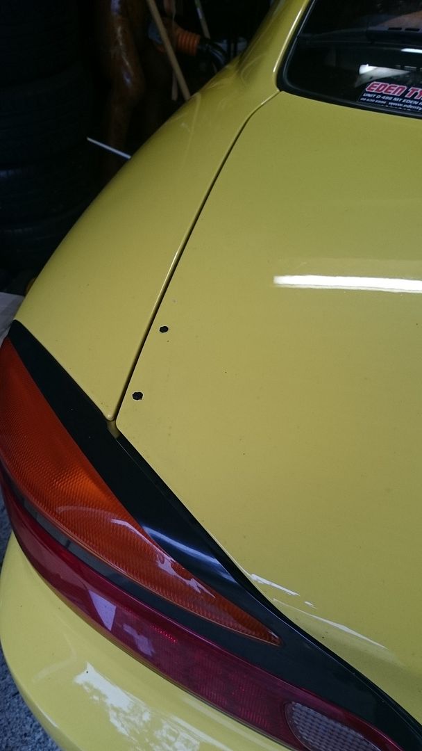

During this time I despoilered the car - wasn't going to fully go for a weld up repaint job but a family friend is a panel beater and he did a great job plugging the screw points

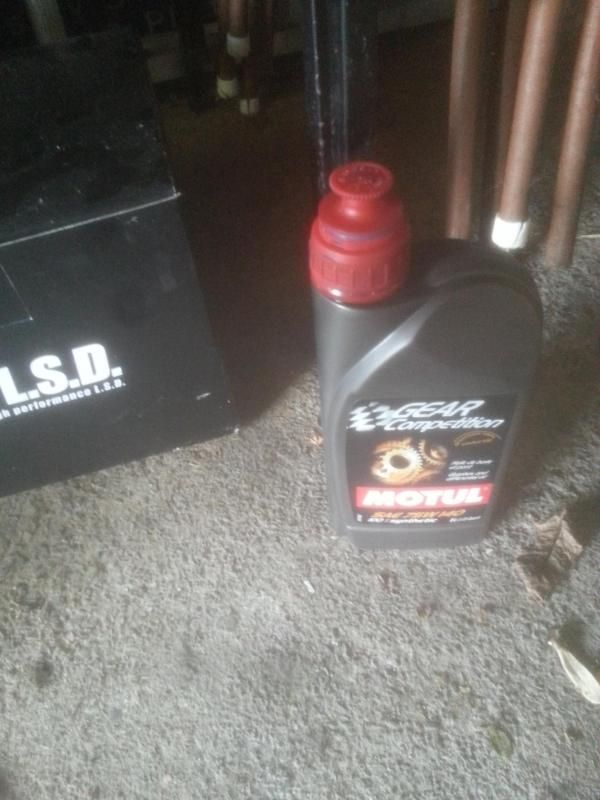

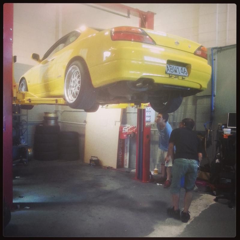

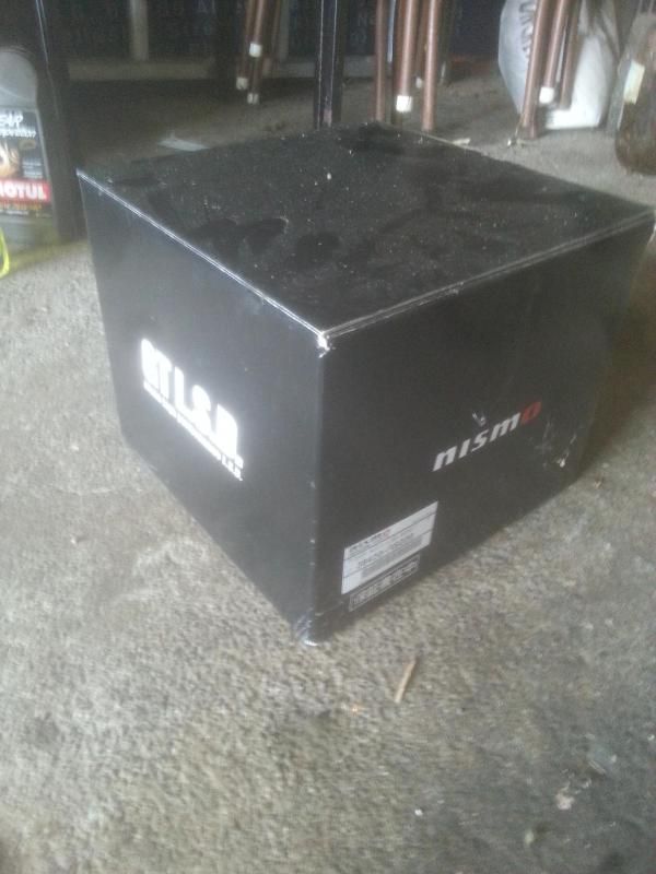

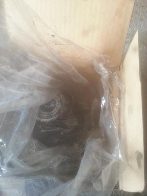

So the 2 Way came in about four days of being shipped out. EMS is sure getting fast.
Went straight to my mechanic - I had no confidence to change a diff myself. Popped in within a couple of hours and clunk clunk clunk. It was amazing, it felt great and so loose dumping the clutch.
I just want to put for the record, a 2 Way is not that bad for daily driving - its predictable and you won't magically kick the rear out unless you are really hooning it. The car is probably at 150 - 160kw at the wheels so normal driving for it is fine.
The Nismo GT Pro LSD came with new bearings, 2 bottles of Motul LSD oil ! and the centre itself.
Stock Helical LSD hidden away

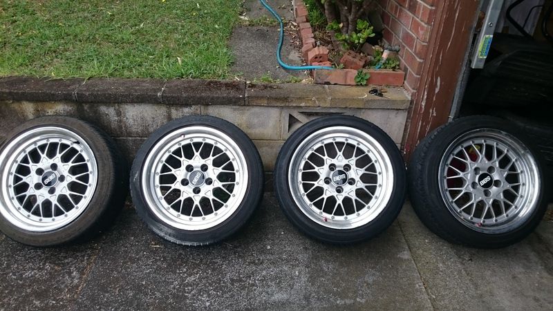

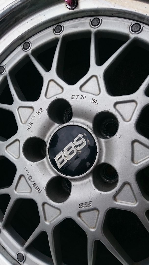

After this day, my friend was selling his BBS RS II Type - O 17x9 +20 all round off his S14 Kouki - Got them for a great deal

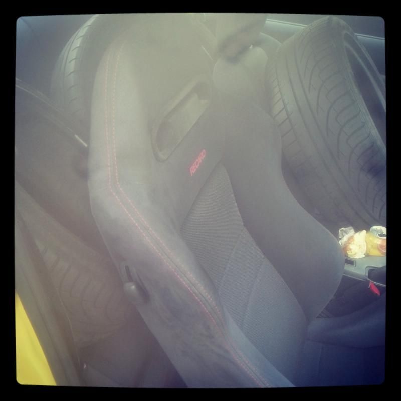

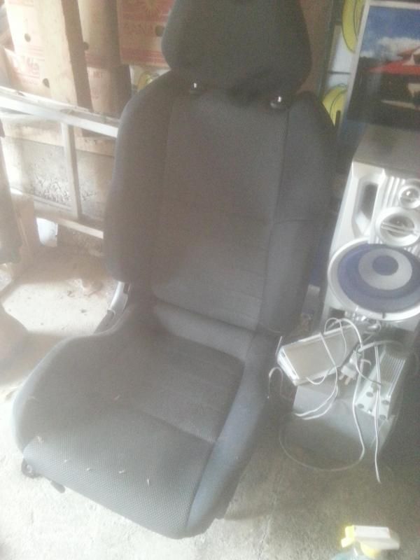

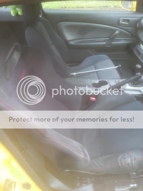

I also saw a classified for someone getting rid of a Black SR3 Recaro from a DC2 ITR - Drivers side only - exactly what I wanted. Get me some of that Honda feel I love.
Fitted it up on NZKW rails and drilled the bracket for the seatbelt

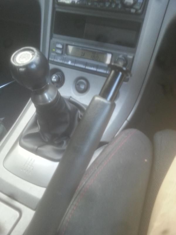

Also installed a GKtech drift handbrake button for the mad 1 pot rear lockies - I need to really upgrade the GTST Rear brakes
Black to keep things nice and stealth

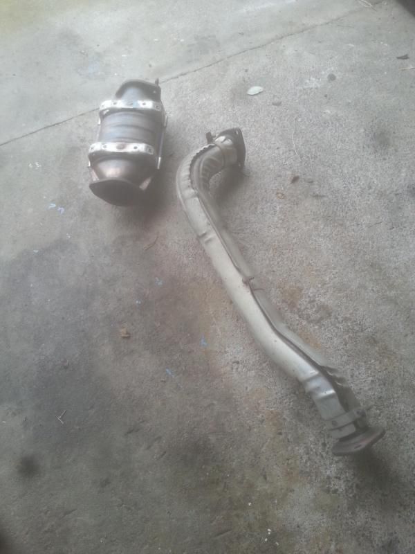

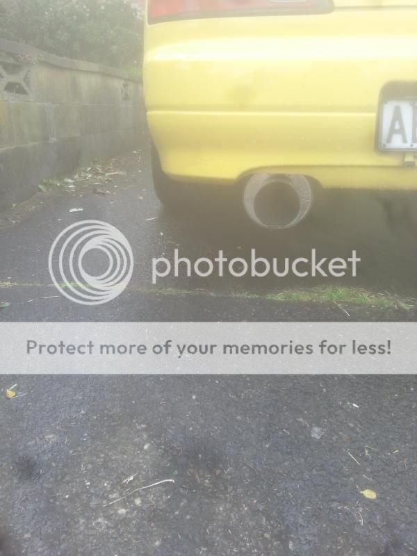

So I threw up whether to go for an FMIC or an exhaust - the plan was to start doing some bolt on power mods - support upping the boost abit on the T28BB with a EBC.
What was the point of going a 600x300 generic kit and get choked by the exhaust section. I got a great deal on a brand new HKS Hi Power Silent catback system
Ordered in a few weeks after some Megan Racing products from a good importer Moonlight Racing
Out with the Cat and Factory Front Pipe
I kept the factory dump because I was advised keeping a bit more response by having a smaller dump and the T28 is way bigger than T25
Went from around 9psi factory boost to about 11psi from just bigger front and decat

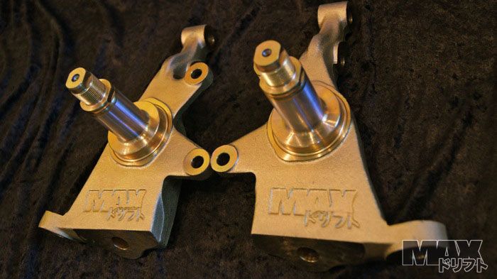

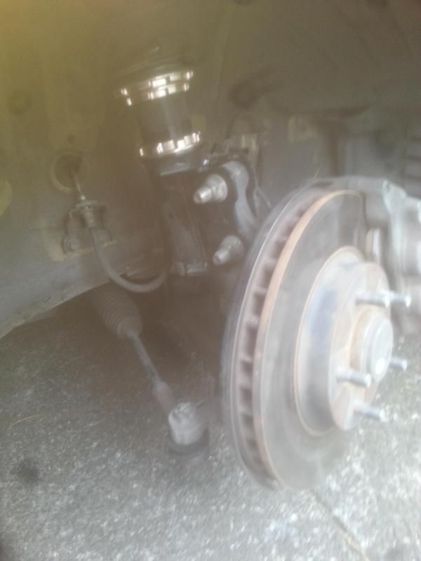

I picked up some Parts Shop Max Knuckles and organised with a good guy named Todd who does Keto Steering Systems for some D1 Drivers here in NZ

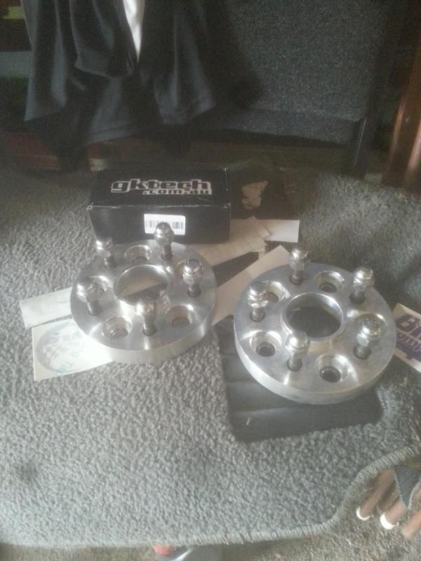

I got some GKtech offset rack spacers, 25mm Spacer to throw me into -5 offset after the knuckles are in and needed to roll the guards silly and remove the plastic **** out of the way -
Split a little bit of the paint but its nicely rolled in the front now and just needing a loom tuck
Knuckles are hopefully going in on Tuesday and the lockstops just need to be shaved from the LCA and reweld some new ones to get slightly more lock - Hopefully all goes well but something is bound to come up!
mbb
19 May 2015
39
So the last post above was probably late last year around October November - So i'll document what I can remember
Knuckles went in perfectly, only change was that these did not support ABS so the plugs have been disconnected to the front - I'll be looking to finish up by removing ABS all together with a kit like this:

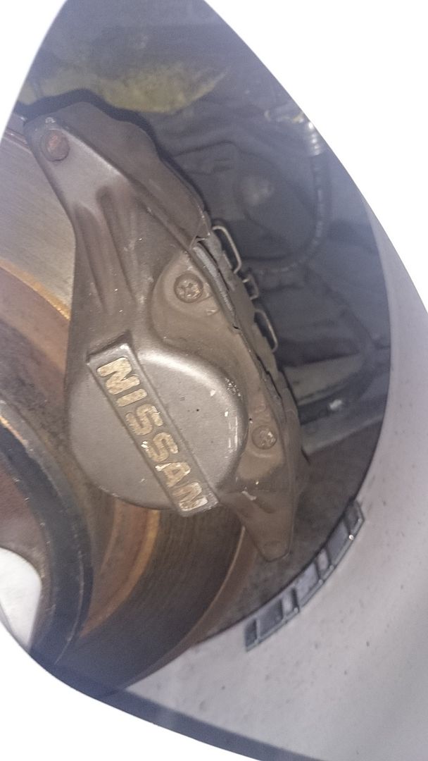

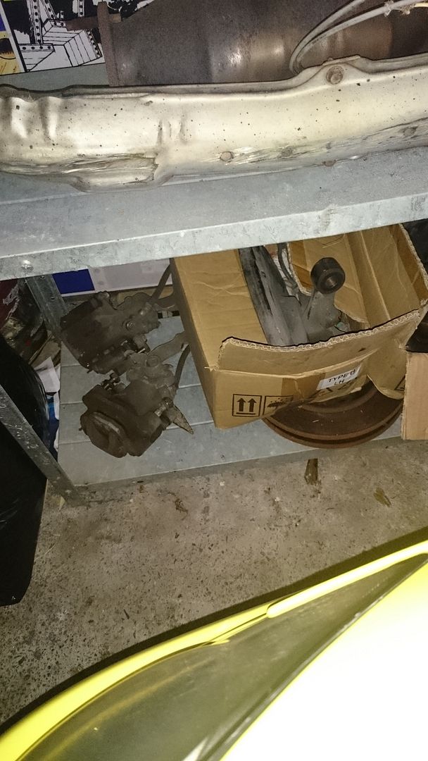

I also picked up a R33 GTST 2 pot caliper and drum setup and got it installed - just needed a R33 handbrake cable and got a custom adaptor fabricated up instead of the normal 'eagle adaptor' or whatever is used
You can see from above the handbrake cable started getting damaged as I put on some drifteks on the rear to drift on and they were 17x9.5 wide :/
Graveyard for original calipers and stock knuckles

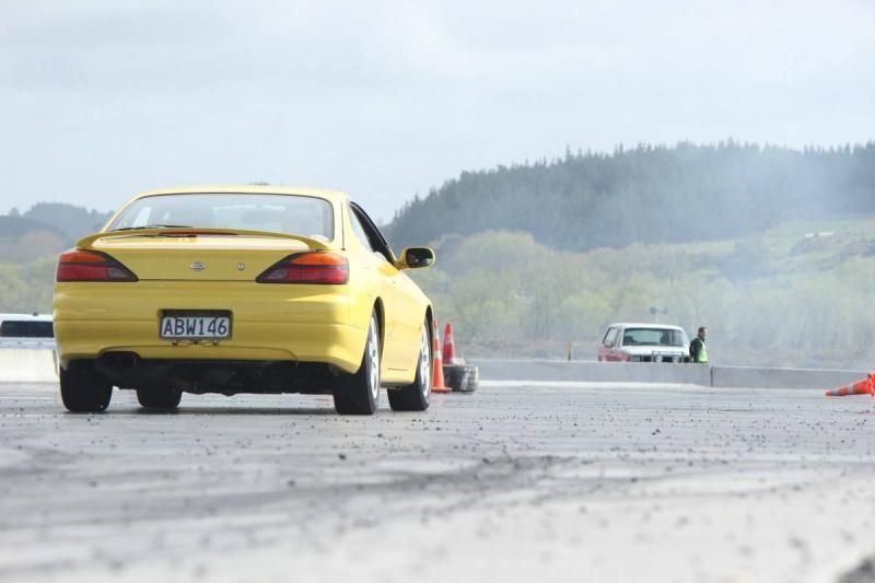

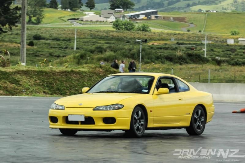

Also went out to another drift day to check out the new knuckles and handbrake with the 2 pot rears - and they felt amazing and increased my margin of error of spinning out. Handbrake locked up nicely too
Heres a few pictures from the day:
Went a bit too hard and dropped the tyre pressure to about 24psi to get more grip in this pair of skid wheels. The compound of the tyre must've been **** cause they lasted a couple rounds before this one got punctured and loss all air in it hence popping off the wheel
Even got to attempt to start experimenting with tandems with this nice sil80 CA18DET

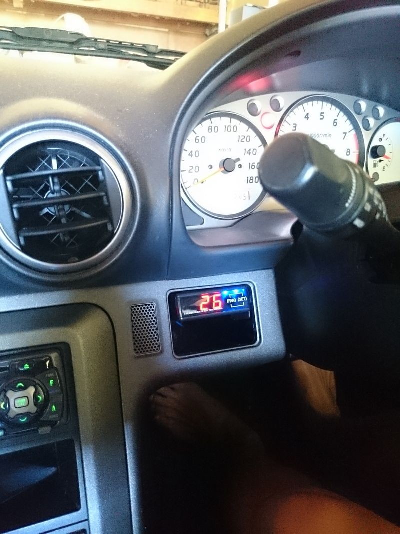

Like I was saying, not much happened over the summer here, this is around January-February now.
Got a Top Gauge water temp/voltage meter. Got it installed from a good mate of mine and only trouble was the adaptor for the sensor on the top hose and cutting it up to fit.

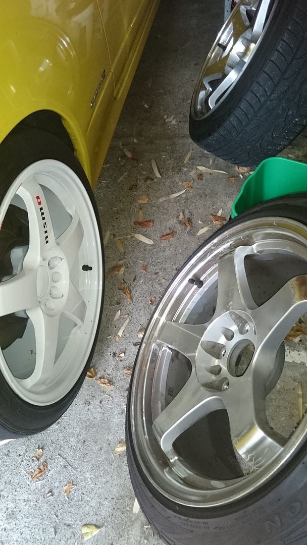

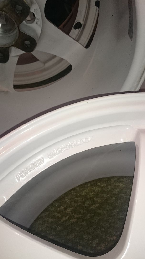

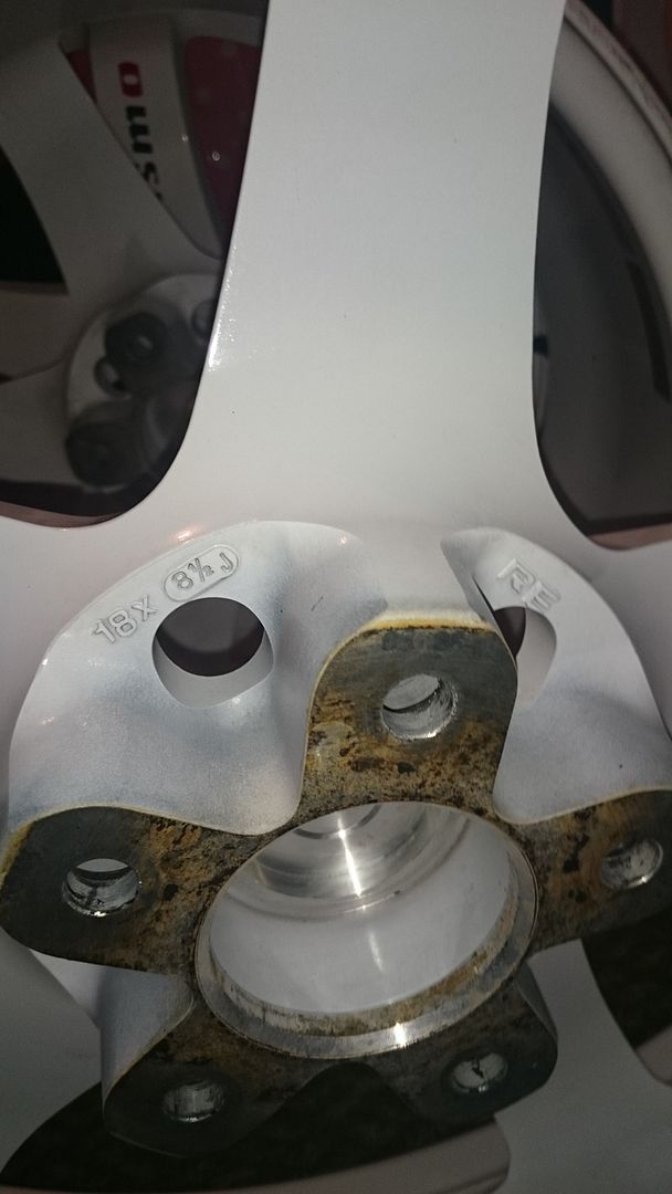

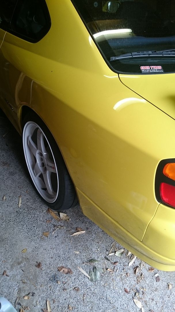

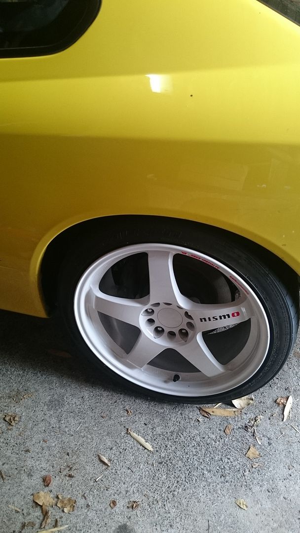

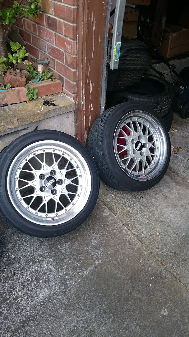

So I found some new wheels and have had my eye on them for awhile.. and it was a local set and the price was fair..
I had to say good bye to the BBS wheels and sold them to a friend who just finished converting to 5 stud so it was perfect for his S14
I travelled down the country about an hour out of town to pick up these goodies

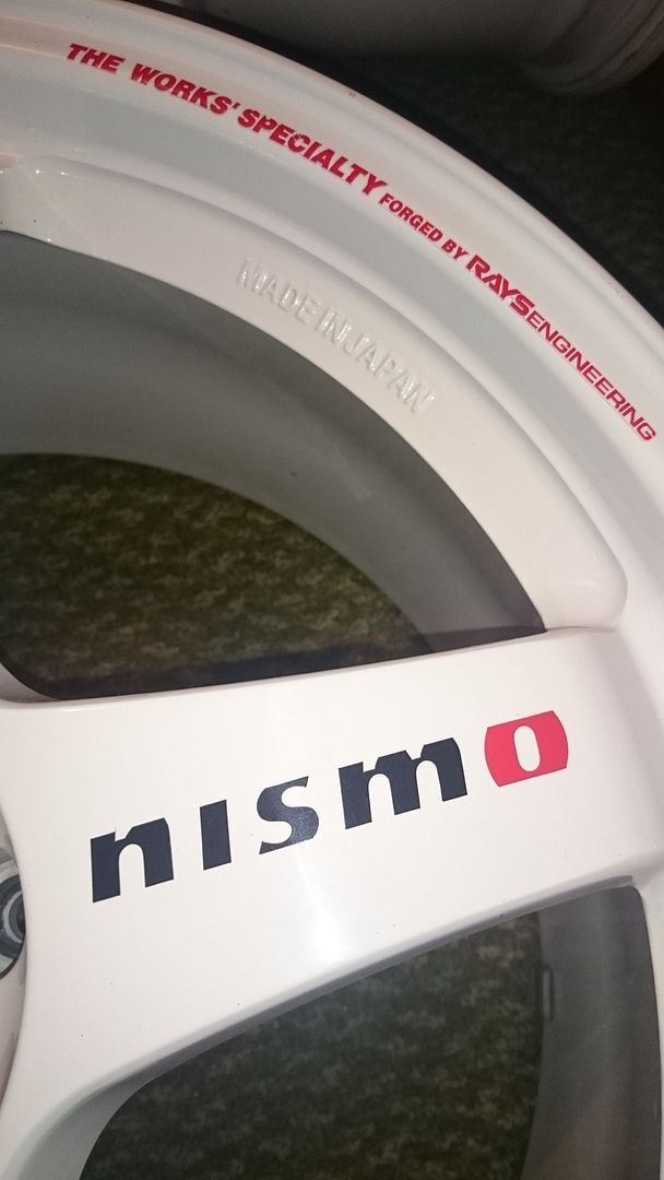

18x8.5 +25
They usually come in 18x8.5 and 18x9.5 but these came off an imported 350z from Japan and the owner did not know the value of them.

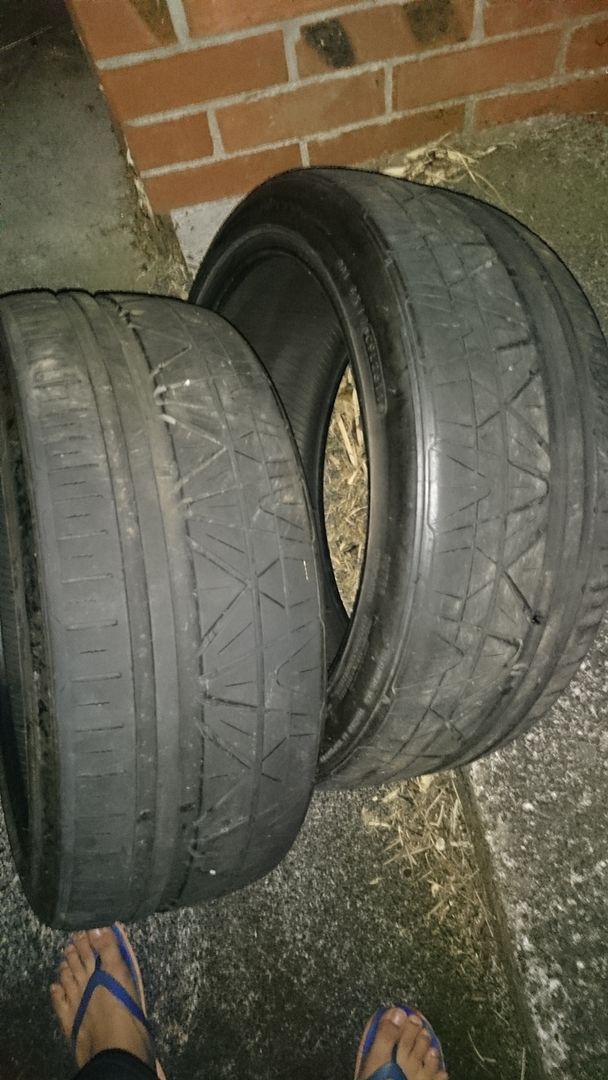

I picked up some Nitto Invos to wrap the front for some nice grip
and got some trash camber worn Falkens in the rear to fit on and finish off as I was on a budget for the month.
Here they are on
Compared to some fake Drifteks
Here it sits to this day
I really need to get some camber and toe arms for the rear to straighten it up. Want to have it done by next drift day so I can get some more grip

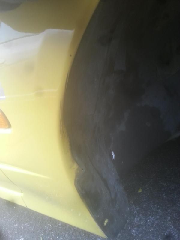

I've found since changing from the 17s, they've scrubbed alot of the inner guard away in spots down to the metal so its starting to rust if I don't fix it up.. might sand it down quickly and apply some primer .. though I don't think this is the best fix.. just temporary.
