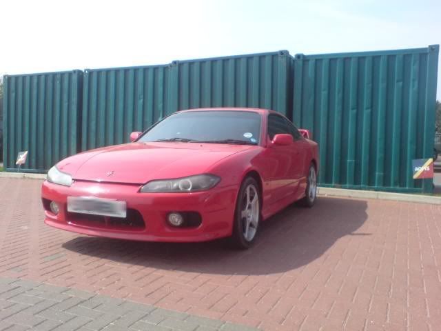

Well, the 180 has moved on to pastures new, so I thought I'd need something to keep Team Driftgarage busy​
This is how I got it...

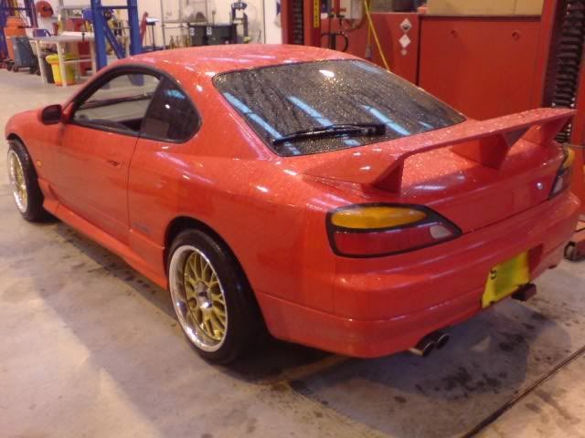

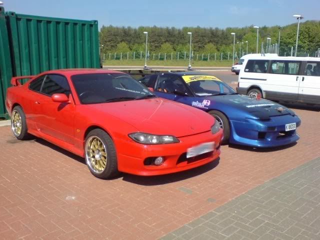

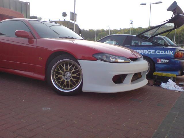

Wheels were a bit weak for my liking (17X7 ET35 and fitted pretty flush), so the
Advan Sienas were drafted in...a bit of archwork as required, methinks.

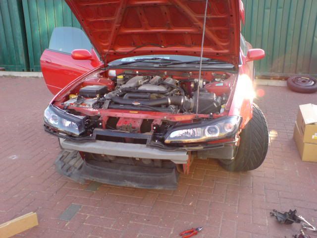

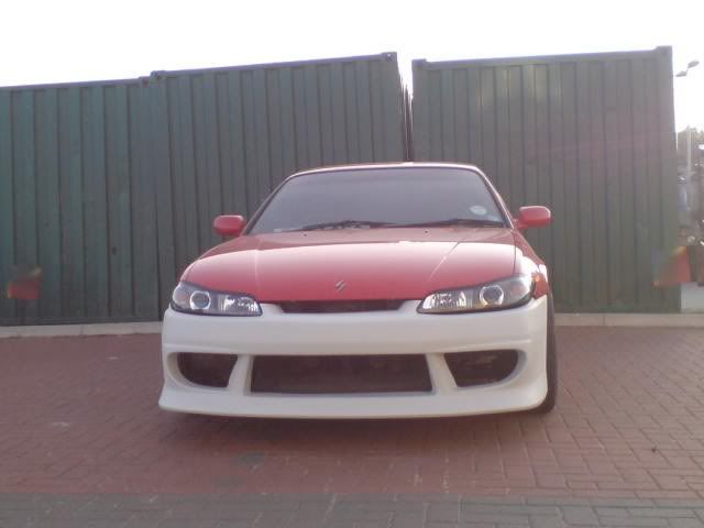

The headlights were looking a bit tired and I had a new set sat around, so fitted them...

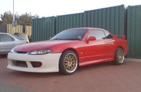

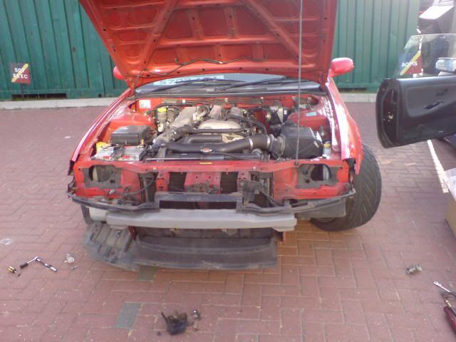

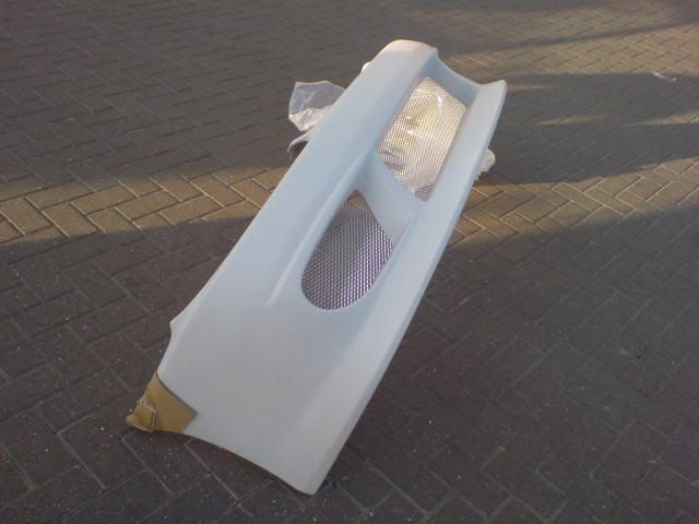

We popped up to EP Racing to see Jeffrey and pick up Bruno's bumper, and they had this in stock, which was a nice surprise...
Just needed to lose the slightly gay mesh and swap it for the original. It's just sat in place at the minute, but seems to be a good fit. Cheers Jeffrey.

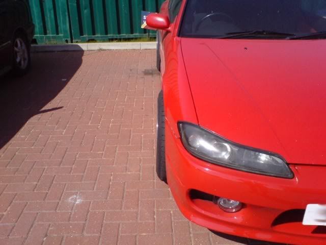

looks like it will come along nicely mate, like those wheels!
You can see in the 1st pic they look "Cloudy", sure this is what has been discussed elsewhere and some metal polish would have done the trick.
M
mitch
They needed a proper degunge and someone had drilled sidelights into them, one of which had fallen out and creatures had climbed in :D

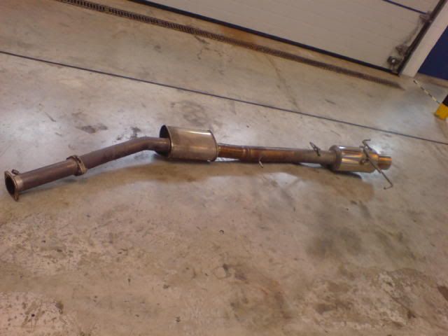

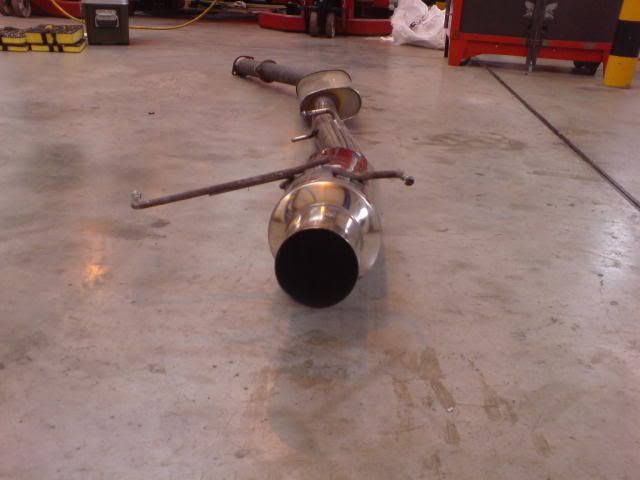

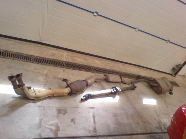

Anyway, no point in selling a mint set and keeping the manky ones when I could swap the older ones for the Apexi exhaust plus cash...

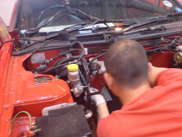

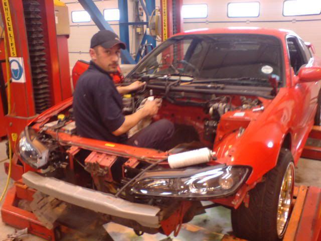

A few pics from yesterday's efforts...
Waiting for surgery
Mister Polo grafting

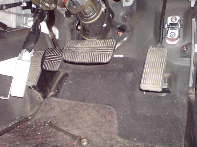

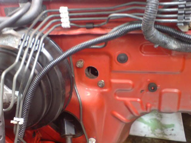

Clutch master cylinder holes and fitting. I'm glad we took the engine out :D

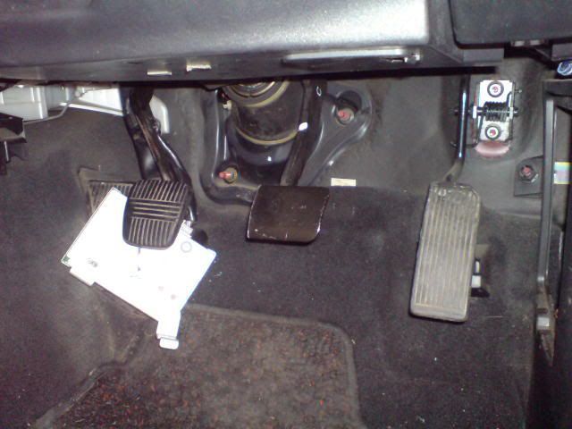

Pedals touching...
Until angle grinder attack...
Cleanest SR I've had...
Manualness...
