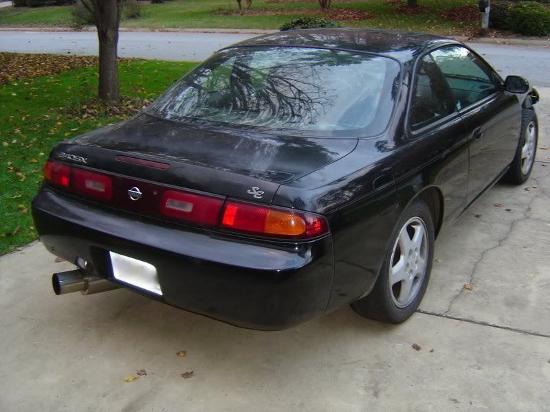

I'm working on my current project, a 1995 USDM 240SX. I've been at it for a couple years now, which
includes a completely rebuilt KA24DE w/ 8.4:1 forged pistons, GT32 turbo, custom 3" exhaust, retuned ECU,
Z32 MAFS, 720cc Nismo injectors, 6 puck clutch, lightened flywheel, Z32 brakes, Tein FLEX coilovers,
other miscellaneous suspension upgrades and other odds and ends. I'm in the process of sourcing
a M/T S15 HLSD and figuring out what tire/wheel combo I want to put on, as well as completely stripping
out the interior, and improving on sound proofing and silencing the creaks and rattles a 10 year old car has.

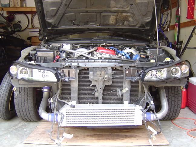

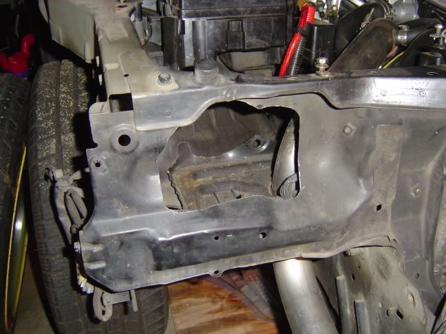

I've also just recently started the S14.5 conversion process...I have the S15 headlights, S15 JDM bumper,
upper and lower bumper support and retainer, and some fiberglass conversion fenders. Currently
looking for a CF hood. Here are some pics showing some progress:

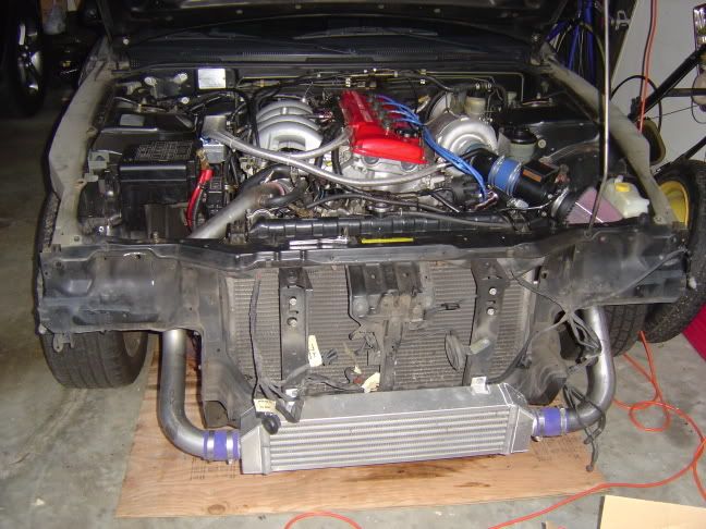

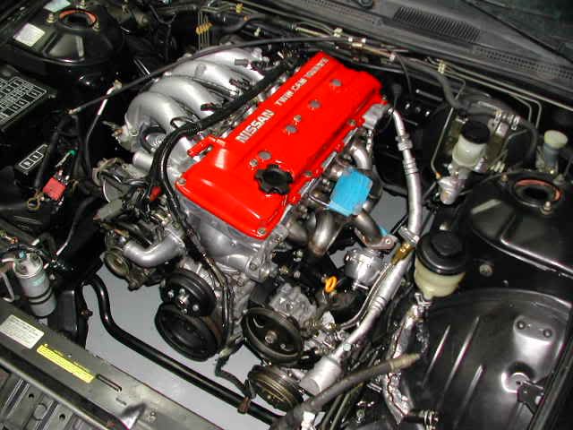

Here's an interim shot as the motor was put in and the turbo components mocked up for final fitment...
Currently running 7 to 8 PSI, so next up is a switch to a higher quality intercooler arrangement so I
can turn it up to around 18 PSI on pump gas. Also working on getting the exhaust quieter because
right now, it is LOUD! :eek:

Hello and welcome from across the pond :wave: A very nice set up you have there :cool: Who made the manifold? I love the top mount design, a friend recommended Lovefab as he just bought one from there and it looked very impressive.

A one man operation here in the States named "BoostDesigns" sold me the manifold. During my research of his company, I discovered that he actually contracted out fabrication of the manifold to a company in South Carolina called Applied Technologies and Research, Inc. (ATR). ATR was known for it's Buick Grand National performance goodies and had a pretty good reputation for solid exhaust components. About a year ago, however, both BoostDesigns and ATR went under...won't go into why, but long story short, you can't purchase my exact manifold anymore for the KA24DE. There are however, several different companies offering quality manifolds for the KA24DE, as well as the KA24E.
The top mount looks good when popping the hood, but for exhaust routing reasons (especially with a 3" downpipe), I'm contemplating selling my top mount mani and going with a bottom mount from AMS, http://www.amsperformance.com, a performance shop based out of the Chicago area. They have a guy there (Ivan) that is working on a production KA24DE bottom mount for the street...
He also has a custom bottom mount on his KA24DET which has a run a 9.2 sec at 156MPH quarter! And it's a S14.5 also btw...

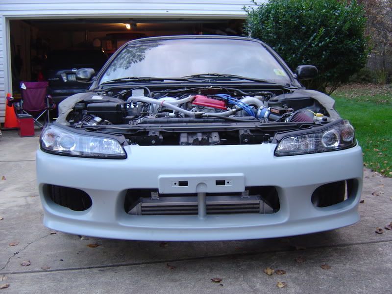

More pics? You got it...already have the front bumper in primer...

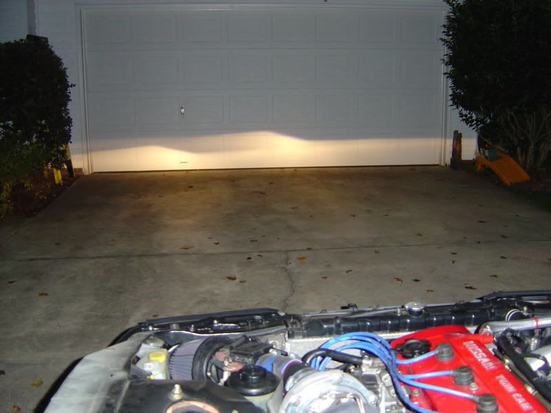

JDM lights for sure...I'm probably going to open them up in the next couple of weeks and switch
the shields out to get the cutoff correct for driving on the right hand side of the road...

Just a question.
can you have a flat light pattern in the US?
If that's the case you can just remove the headlight, take out the bulb and use a small
to make that small metal plate flat.

Welcome and nice work on your 240. I like the looks of that manifold. Too bad the company went under. Similar thing happened with the company that made the manifold on my RX-7.
