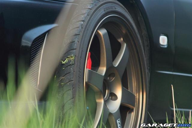

This is how a 225/40R18 Yokohama DNA GP tyre look on 8.5J wheel
As you can see, the protective lip on the tyre no longer protect the rim because of the stretch. That's the downside. I think 235-245 width would be ideal. But I probobly don't have enough room for that in the front on my car.
