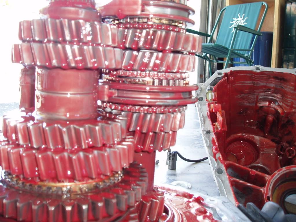

I use RL heavy and light in boxes with syncros and not had a problem in the past a lot of people say the viscosity is too thick and doesnt get around the syncros but its all bull, if you use fluids with the intended purpose in mind then everything will be fine. heres a old box of mine with rl heavy covered everypart of box never had a problem cold or warm, although some people who couldnt operate a clutch properly said it crunched like mad
