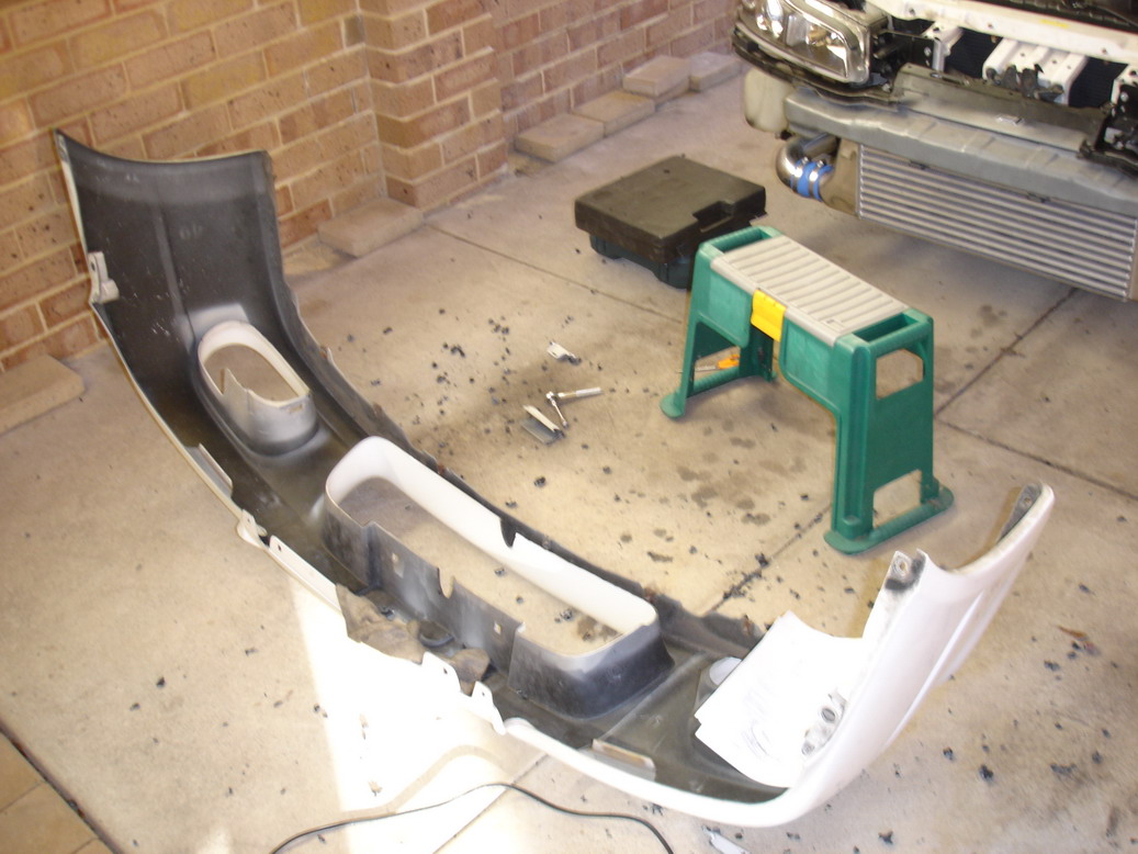

My friend didnt have to trim much for his autobahn88 intercooler as well, when we compare it to my greddy cooler, the autobahn88 intercooler is much small and thinner, therefore it was a direct fit to the front bar without trimming anything.
The pipes were hitting on the side where the foglights were attached to and i had to trim it all off to fit
