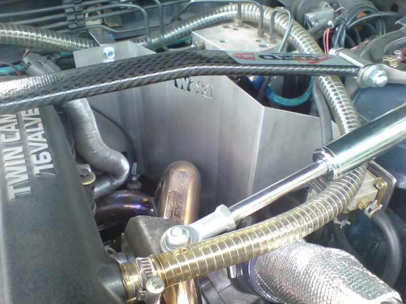

just a small update......
just got myself a Aluminum ABS heat sheid :thumbs:
as the unit was alway too hot from the ss mani.
perfect fit but only if you got a small ss mani like a tomei extreme. will not work with other after market exhaust as they will touch off it.

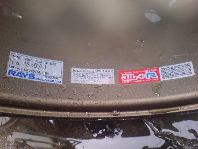

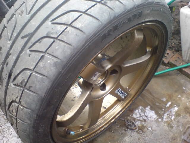

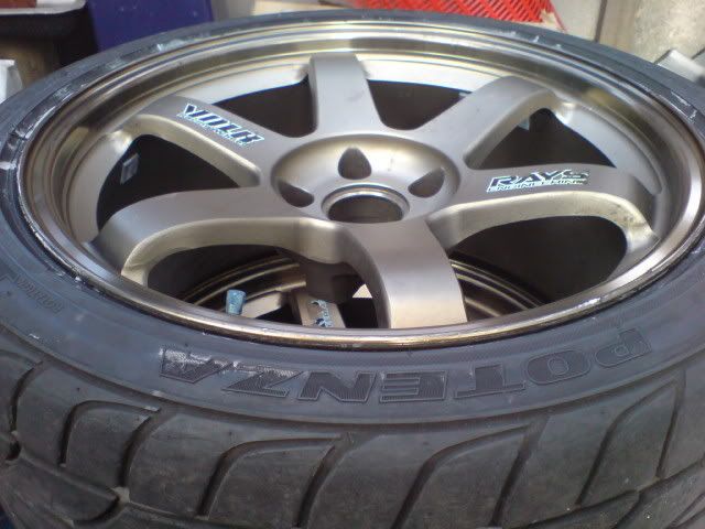

Look what i just recently picked up Yes TE37's
18"x9.5J all round
with a massive +12 offset :thumbs::D:cool: :wack:
and its wrapped in some BS RE01 :thumbs: 265x35xr18
