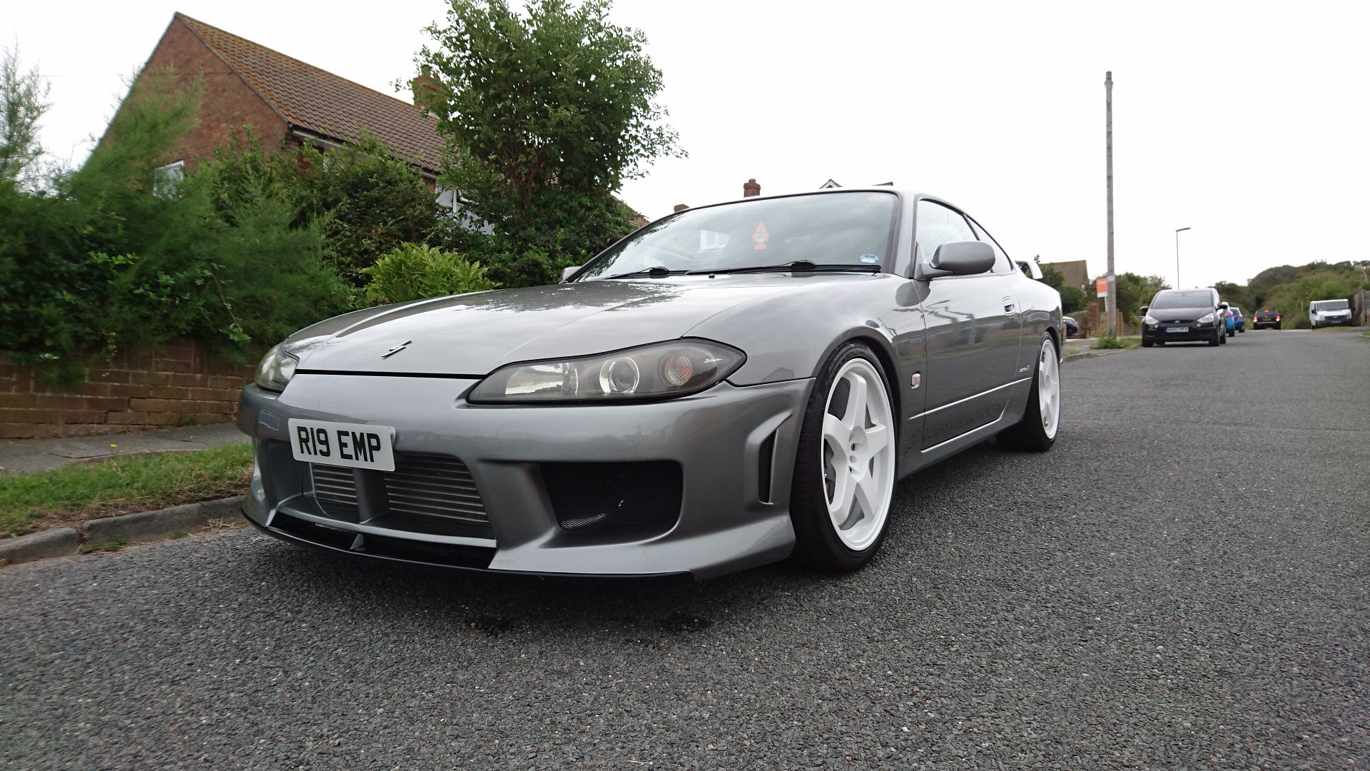

The only pic I have of it lowered at the moment, I wouldn't say it's really low to be honest...
Wheels are 18" though, 8J and et30 if I remember correctly!
I have already relocated the drivers side wheel arch wiring loom so no worries about that, just the arch liners that I'm concerned about!

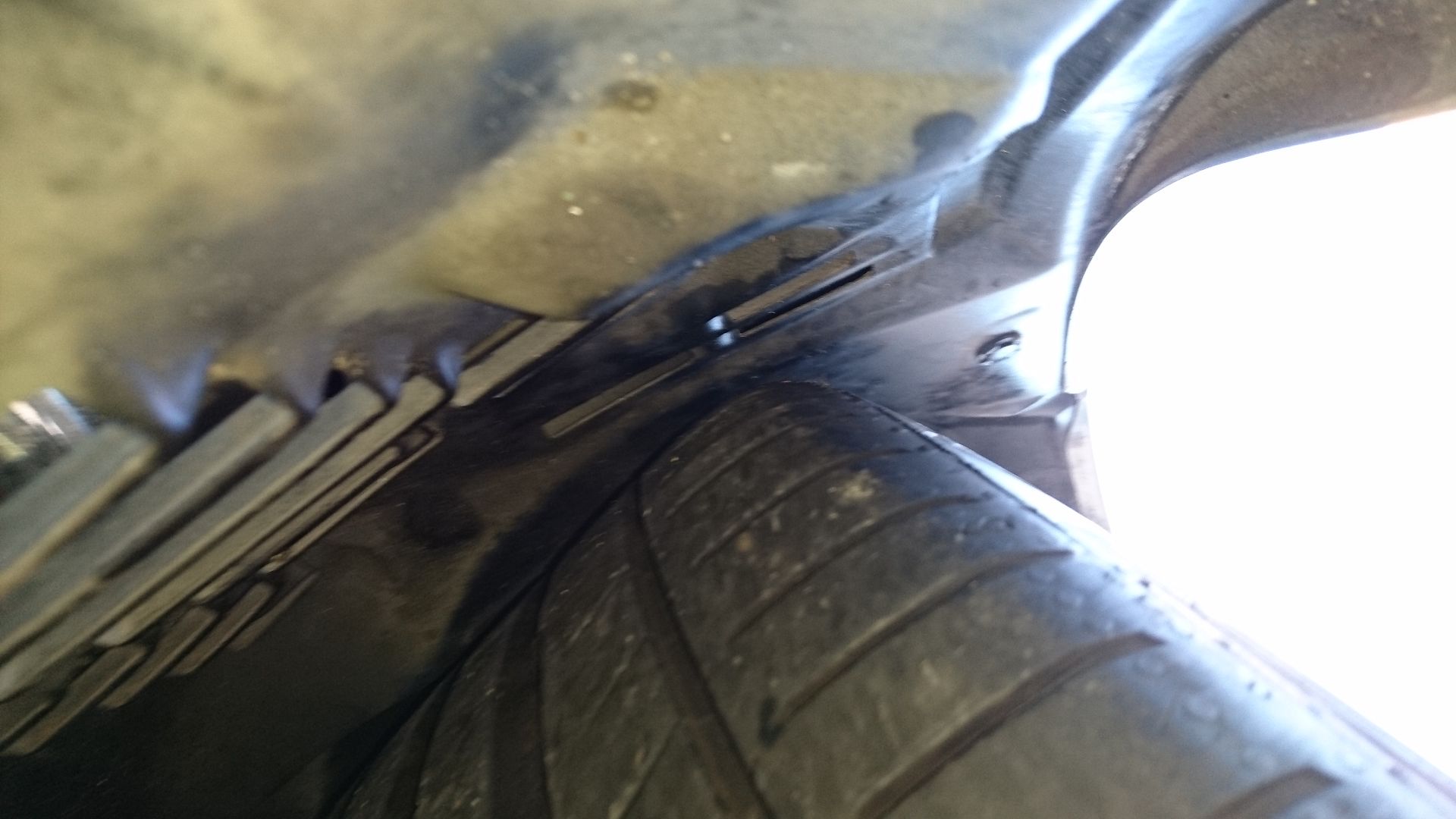

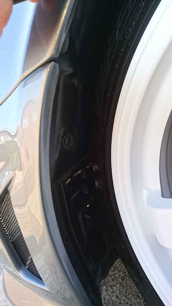

21 December 2015
51
East Sussex
@s15_ryan
So I got a few photos, they're not the best but I think you can see the area I mean...

Wow that's a lot lower than I expected.
I need to check something on my car and I'll get straight back to you on this one, I was thinking you would be rubbing on the inner section not this part!

@silviaownersclub
Are you still running the factory intercooler? The area that is sticking out won't be something that you can modify easily unless the intercooler has been removed
Also the drivers side AFAIK has the washer bottle bracket on the same location as well.
I would suggest try raising the coilovers by 4 full turns and checking again

@silviaownersclub
I must have been daydreaming, you've got a clear photo above showing the car with a front mount intercooler (btw your car looks stunning).
You can either bend the intercooler bracket or remove it entirely, the rest can be heated up and reshaped.
The wheel arch liners in S15's are 2 piece, you can remove just the front section if you want to first, modify it outside the car then put it back on.
Drivers side should be easy, I've checked the factory washer bottle and its bracket doesn't affect the wheel arch.
