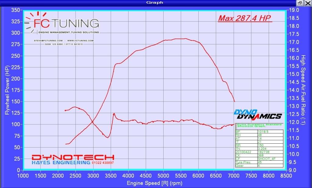

And Steve is great at explaining all the jargon, clear up all the bullsh*t about what people (who don't tune engines) thinks about this, about that... was fab just learning about the whole shebang. The one thing that worried me and all my mates warned me was the the fact that now I'm mapped to max 95% injector duty but Steve confirmed that this is fine since it's only for a very split second and as evident from the graphy below which shows fuelling, the ratio is constant 12:1 all the way to redline - there is no leaning out!!!

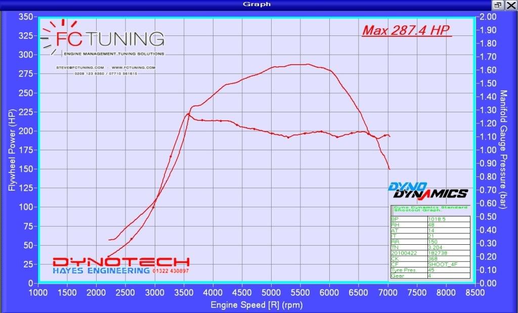

BTW - you can see from the graph with boost reading that my actuator is getting old and 1.2 bar peak soon drops off to 1.0 bar. Another reason to upgrade turbo with new uprated actuator!!

Power graph (see the fuelling is constant 12:1 which is good):
Boost reading which as said drops off from 1.2 bar:

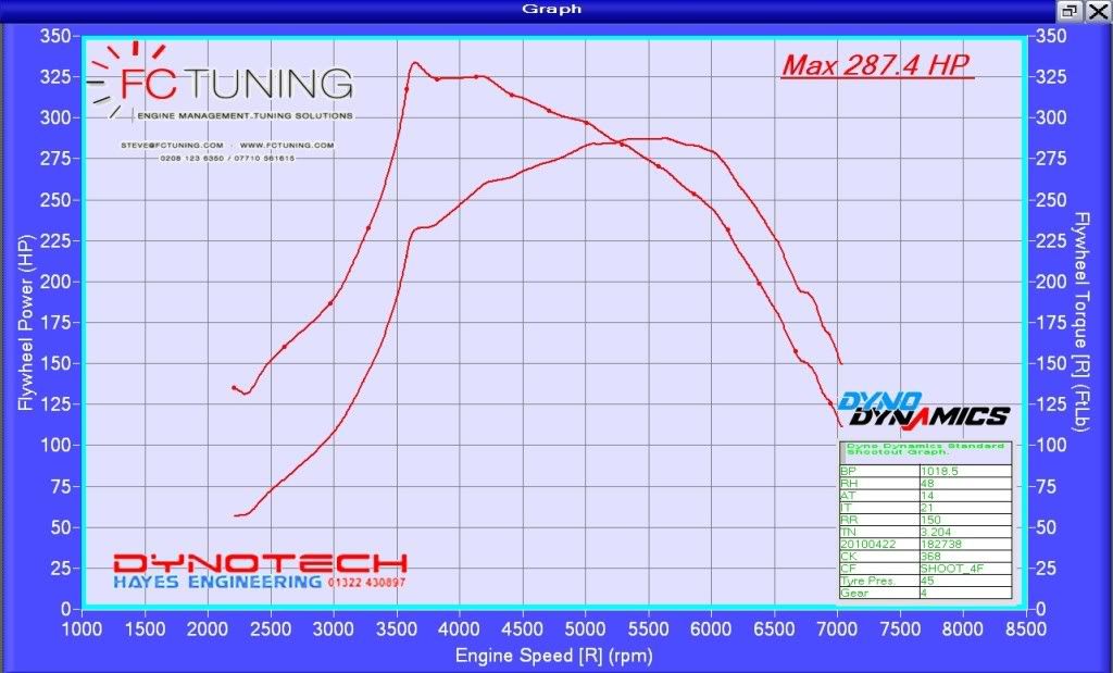

Here's the bit we should only be interested in... torque!!! Bags of it now - 325 lb ft early on... awesome!!!! :D

What is the difference between the different GT2871r's then? I'm becoming more and more tempted by one, but if I do go down that route I don't want to end up blowing the box to bits. At the moment I reach 1.3 bar around 4-5k rpm, but then the boost tails off to around a bar. Want to go for around 1.3 bar all the way through the revs so which variant of the 2871 would be best for this?

What actuator do people recommend to stop the drop
off in boost?
I'd guess it would be either the hks or forge ones?
I thought it was more to do with the fact the turbo cant supply enough charged air rather than the actuator being weak. I have a uprated actuator and mine still drops off to 1.0 bar from 1.3..
Oh right... I thought it was weak actuator and new uprated ones hold the boost?? No matter I'll be getting 2871 soon hehe :)
Darren_S15
Club Event Orgainser
18 January 2008
892
Essex, UK
Oh really, I thought it was becasue the actuator spring is tired/old, and becasue it cannot hold the boost level for long the waste gate starts to crack open, hence the loss in boost.
So is this more a case of the standard turbo running out of puff at high revs?
Yeah, exactly.
If it was as simple as weak actuators then people would just get uprated actuators and keep the stock turbo. The boost map in James' graph looks exactly the same as mine does in the way it tails off and my turbo and actuator have covered about 3000 miles and are about a year old.

mine was holding boost a little better at higher RPMs but the exhaust was hampering my high end power on the car as its only a 2.5" NA exhaust, you can actually hear it struggling to get the gases out fast enough!
i may look to change this in the future but isnt really affecting my enjoyment of it at the moment as there plenty to play with.. i made 287 i think and from my graph you can see my power dies slighty earlier than james hence the exhaust and my torque peaked at 333 lbsft.
Their still good figures Tom. Have you got a Power FC or Nistune?
That is quite a big drop off in power above 6000. Have you got a decat?
