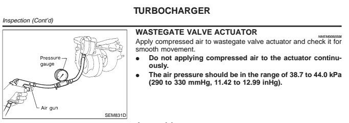

	You think you have a stock turbo but actually it isn't or you have a cheap turbo elbow that doesn't allow the poppet valve to fully openhow can the stock turbo make 14psi with the waste-gate tied open...?! should be impossible...
