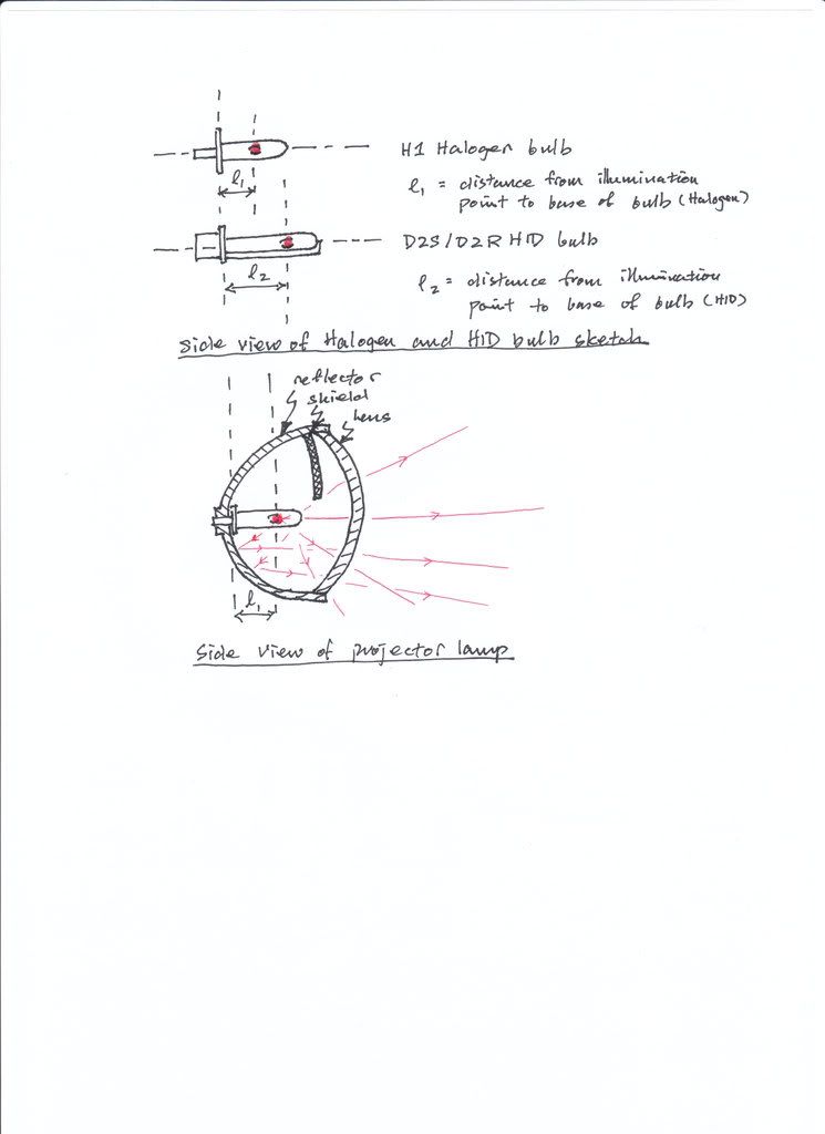

I've been doing some research on my own after reading the article posted by Nicely about the unsuitability of HID conversion kits.
As our S15 headlamps come with projector lamp for lowbeam regardless wether it were HIDs or Halogen.
I have been trying to understand their differences and I think I have cracked the nut.
There is no magic in projectors suitable for HID bulbs. Inside any projector unit, there are the following:
1. Lens
2. shield (steped edged if beam pattern shows such)
3. Reflector
The only difference a HID bulb will create from pluging it directly into the holder of a Halogen projector is the position of illumination. What I mean is if you place a H1 bulb side by side with a D2S HID buld retrofitted for H1 application, the HID bulb is much longer. If you look carefully, you can find both illumination point of both HID and Halogen bulb.
There is a rather simple solution to make the retrofit work perfectly.
That is to compare and determine the step back required for the HID conversion bulb and slot in high temperature rubber washers to compensate the differential distance. Also find a way to preperly secure the HID conversion bulb now that it is protruding more out of the projetor housing.
I am certain this will create the correct beam pattern that meets test standards after correct focul point has been acheived.
I'll do the test myself and show the results later.
If any kind soul is willing to try it out and post the results before me is welcome.

You may do a simple experiment if you wish: remove the back cover to the lowbeam of your headlamp unit. Unclip the HID bulb holder. Turn on the HIDs, slowly retract your HID bulb to visually check if any improvement in your beam pattern? If so, then your HID is not placed at the proper focal point (too far ahead). If no improvement, then we guys are lucky to have the HID focal point and H1 focal point within focus range and nothing needs to be done to improve beam pattern.

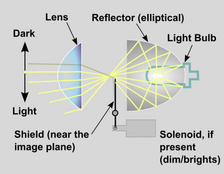

I found this...

Ok. If you do not want to fiddle with your newly installed HID bulb, just shine your headlamp onto a wall. If you find a slight hotspot at the center of each headlamp plus an even lighting pattern spending from left to right with a distinct cut-off at the top edge, you have a proper set up. Rather if you see mutiple hotspots or very strong hotspots and weak overall illunimation, your bulb placement is off for sure and you will get a rather poor beam distance for driving.
To answer your question, the headlamp adjustments are to adjust the entire headlamp unit up-down and left-right. There is no adjustment between light bulb to reflector and lens position.
BTW, your diagram is for a H4 or BiXenon application for the motorised shield removal / retrival when the high beam is switched on.
