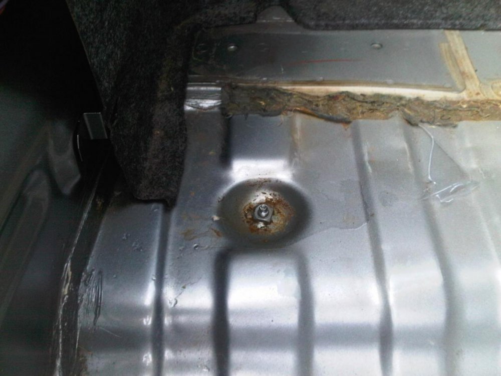

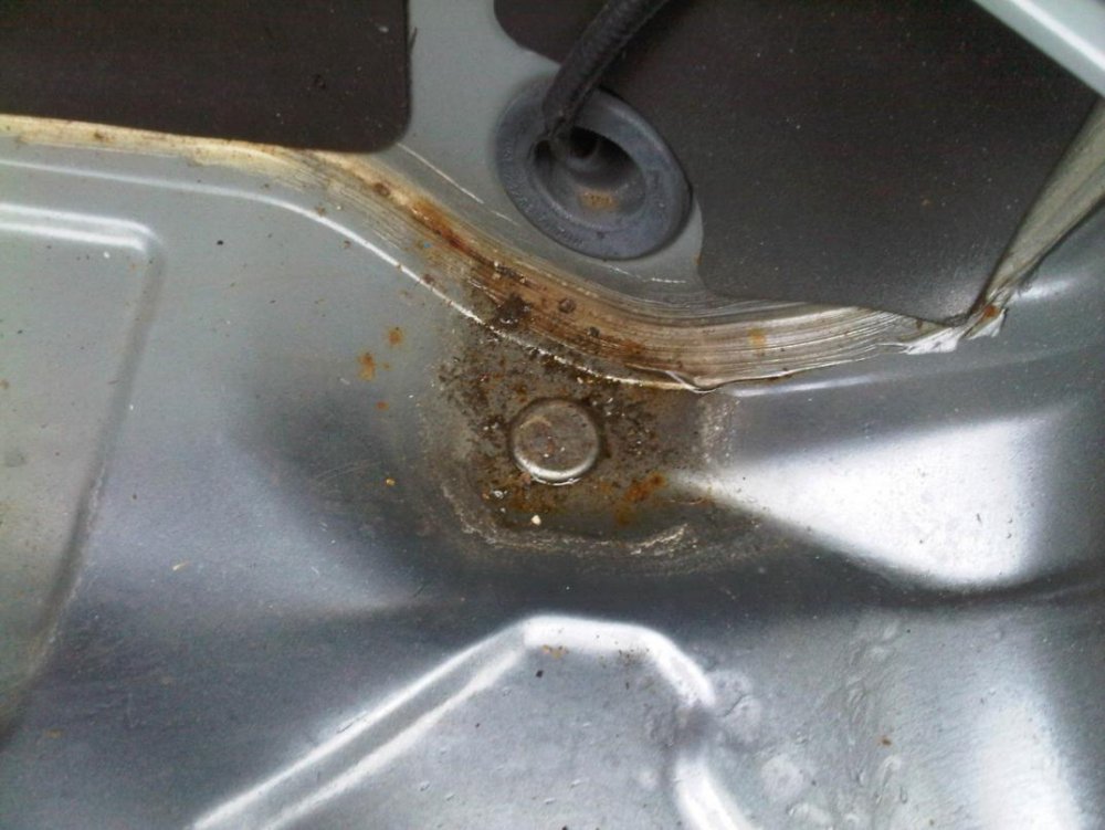

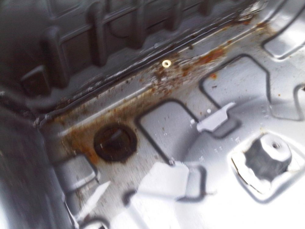

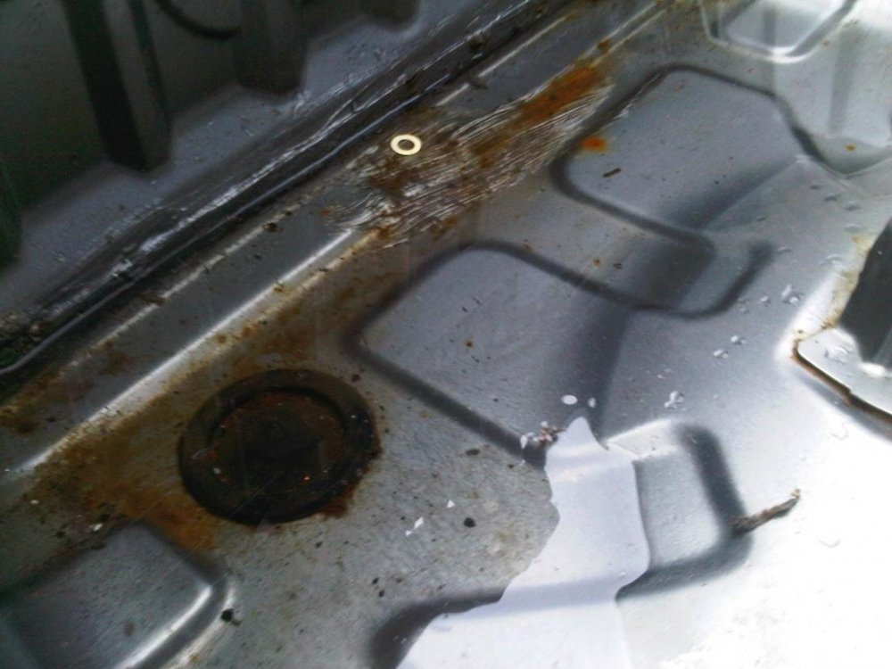

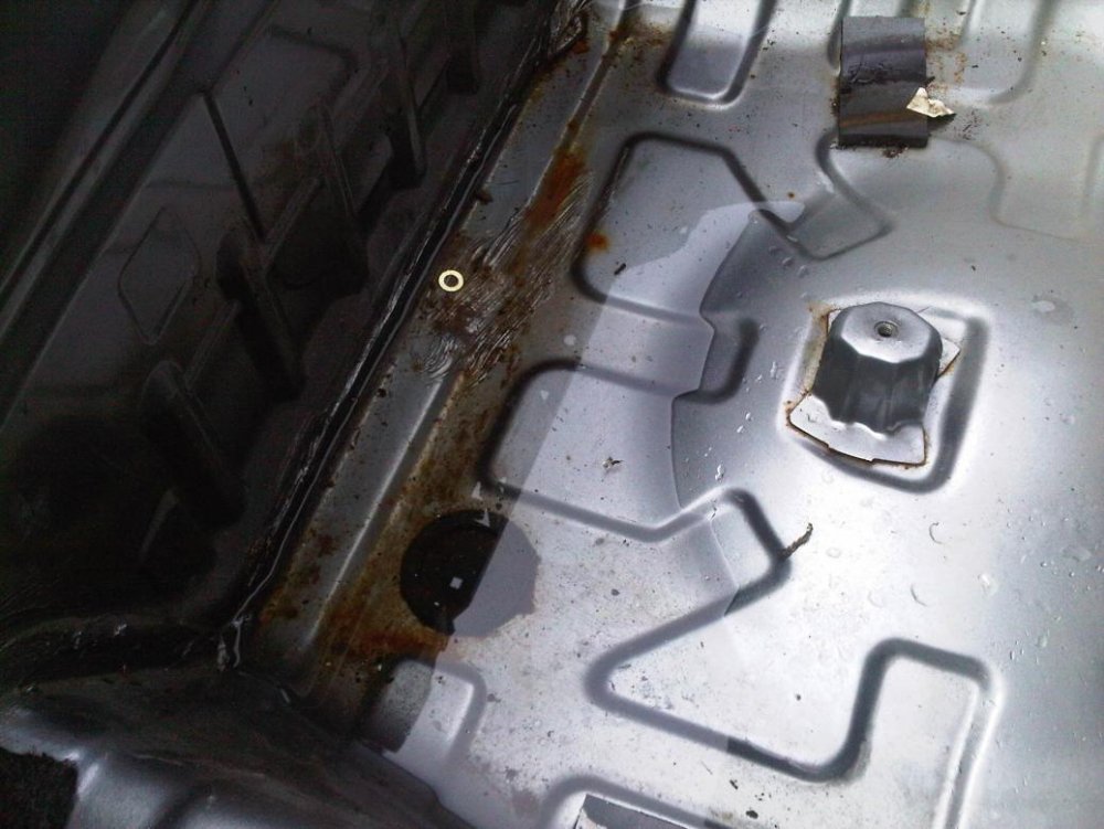

This is proper random,went to change a bulb and my boot is full of water,now the strange thing is none of the flooring/carpet is wet but underneath there is a massive puddle of water that wasn't there on the weekend,any ideas where it could be coming from ?
4,640
pics of said water,seems to be com,ing through the passenger side but still cant find where yet
IMG-20110819-00427.jpgIMG-20110819-00429.jpgIMG-20110819-00428.jpgIMG-20110819-00426.jpgIMG-20110819-00430.jpg
hard to take pics of water lol but it quite bad,gonna have to clean it and cover it over for now i think any idea would be useful thanks guys

I'd check your boot rubber seal,pull it off and make sure the metal edge has not got a rust hole in it. Otherwise have a look at the seal of your rear tail lights.
4,640
maybe comin from the light actualyas i have recently changed them will check the seal around the screw etc
