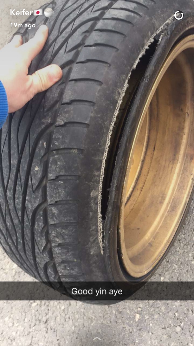

Had a blow out :(

Sheeeeit, everything else ok?
24 January 2013
1,220
Kent
Jeees! Looks like pretty new tire too

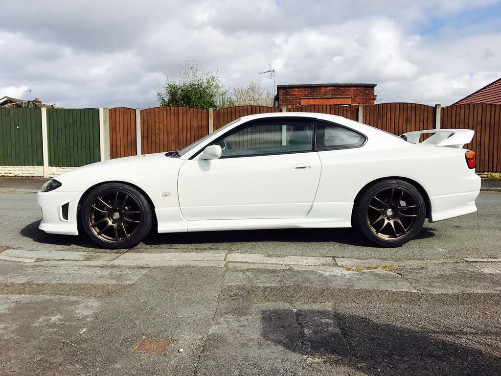

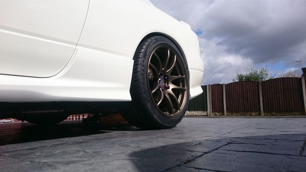

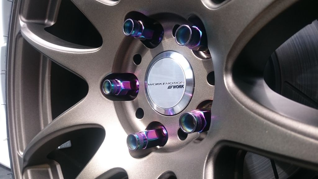

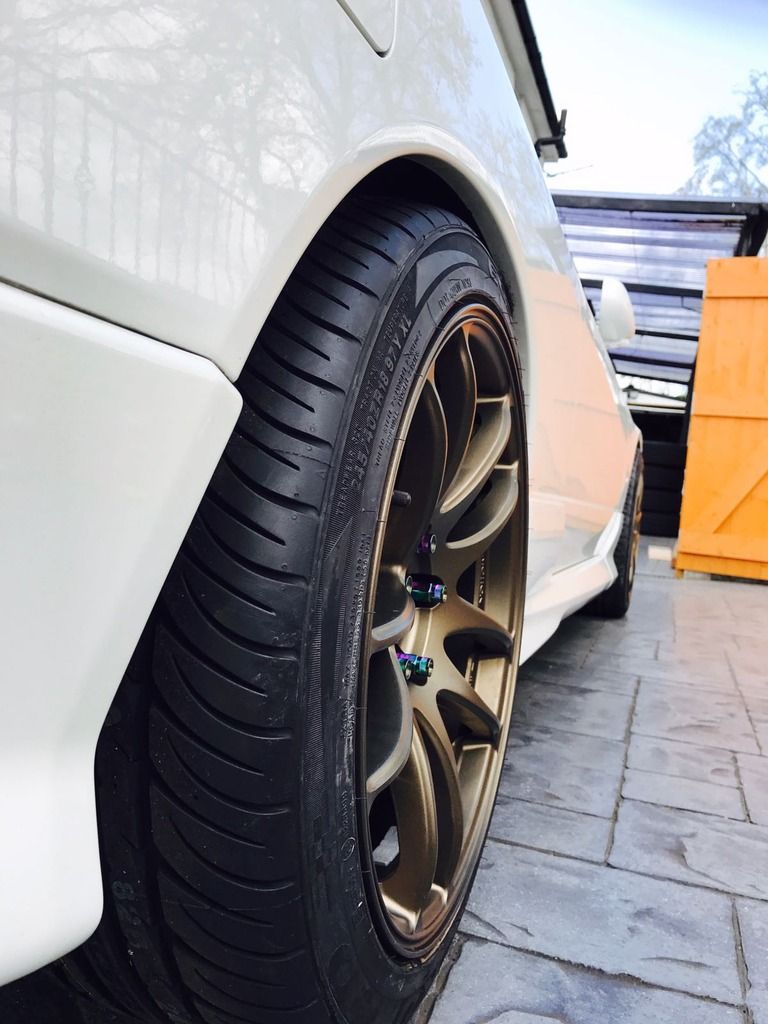

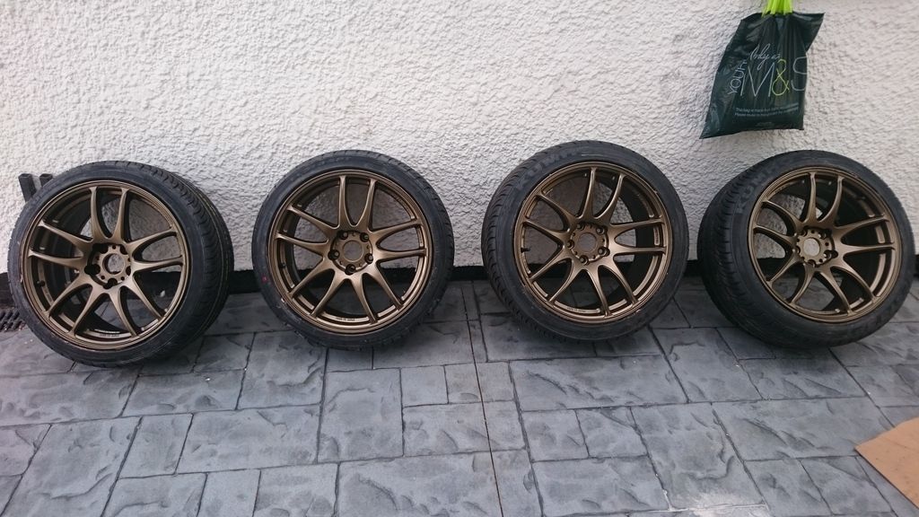

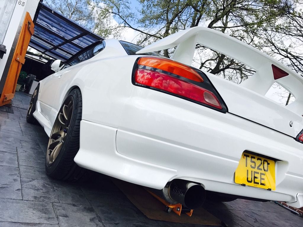

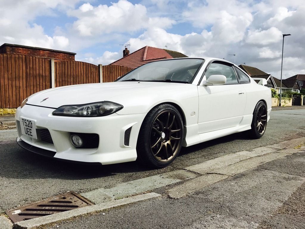

After 4 months of waiting, my wheels finally arrived. Got them wrapped in rubber and threw them on. I'm so glad I change my mind about getting CR KAIs instead of D9Rs. The front fitment is absolutely spot on, need to roll my rear arches a bit but with 245s on the back it shouldn't have a problem tucking under the arch.

Yeah lad everything okay. Tyre was pretty new loads tread in it. Just hit a rise in the road at some road works on motorway and it went pop

What offsets are the works langers im after some wheels myself and they look spot on!
8 August 2015
70
NW
@langers2511
18x8.5 et30 front
18x9.5 et38 rear
The rear arches need to be rolled flat for them to tuck under.

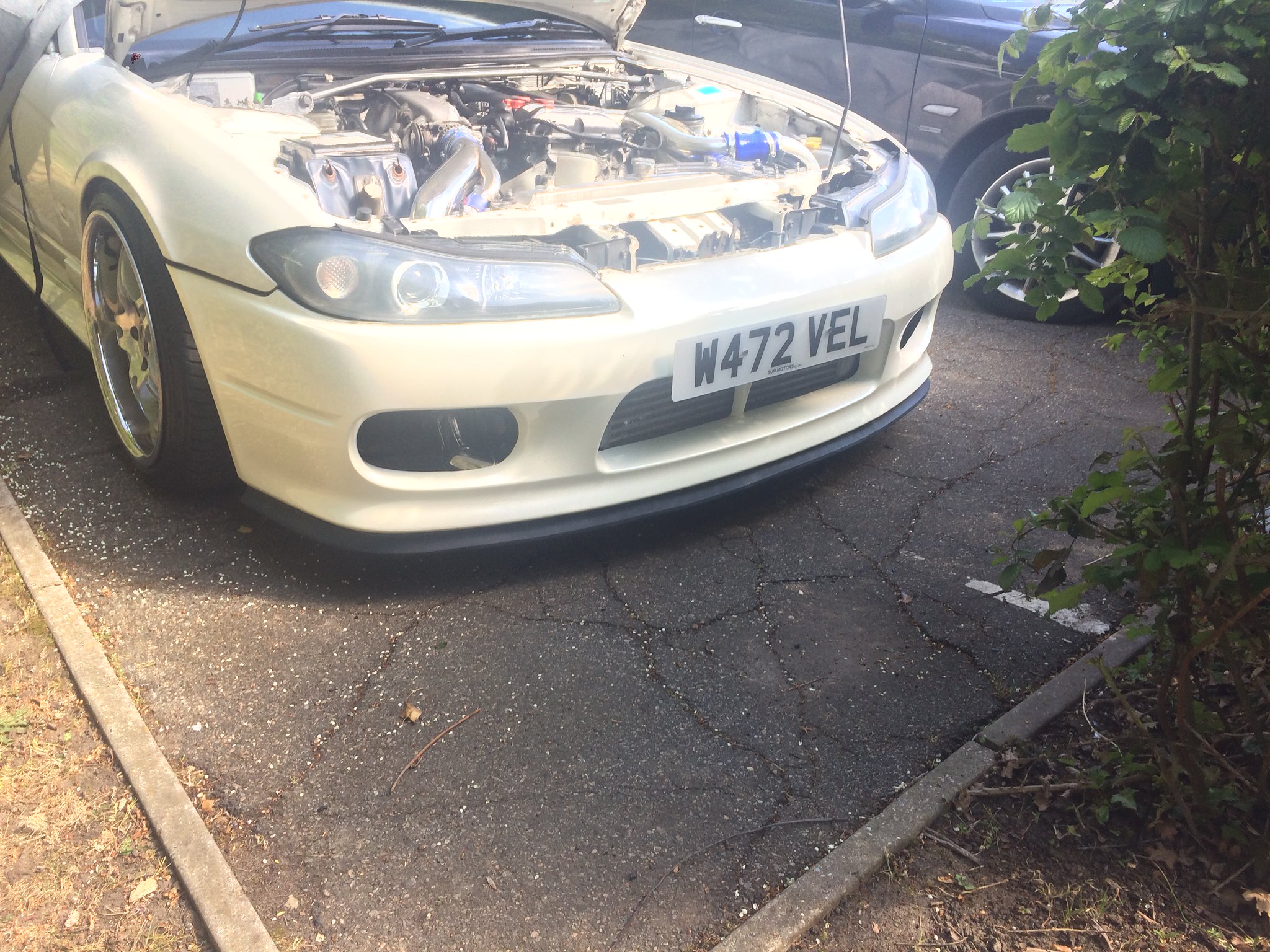

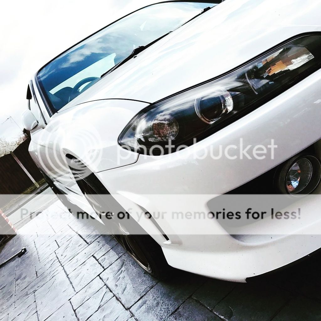

couple of recent things:
inspired by someone else on here, i too had a universal lip laying about for the last year or so, decided to fit, came out ok IMO and looks better for it.

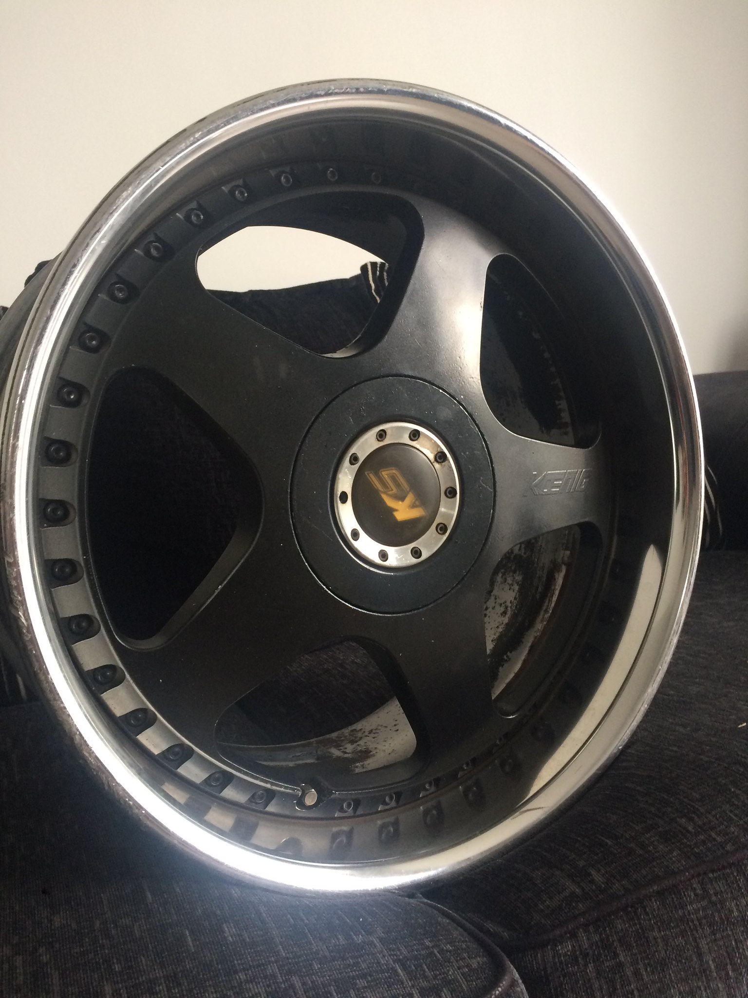

and finally got my new wheels, they are a little ropey and will be having a MAJOR refurbishing over the summer.

Nice. Koenig's are one of my fav wheels I never did get a set on my s15.
Basically Regamasters with dish.

yeah always liked them, not the greatest of width and fitments but its a start
