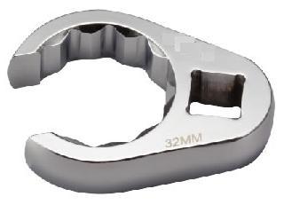

You won't be able to get a socket on the bolts. You need a get a crowfoot wrench set if you can't get it off with a spanner with an overbar.
You put a breaker bar on the end and I acts like a big spanner.
