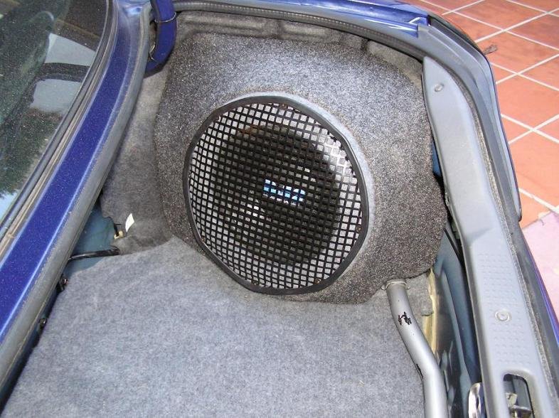

That looks very interesting mate.
Please show me a pic as it'll help me make my mind up and will do the same for others who are thinking about doing this kind of thing.
Basically what this does is fit on either side of my boot and allow me to fit any 12" sub into the hole?
What about the existing stuff that's there, does that need to be removed?
Here is a pic of mine. I haven't finished installing everything yet. The trim panel in the back of the boot still has to go in. All the boot trim stays installed and it goes over the boot brace as you can see in the picture. The box is designed for a 12" sub, but I have a 10" fitted in mine. You can also get an enclosure for the other side as well, but it sits infront of the storage area for the jack, so you could have 2 subs in you car if you wanted.

That does look pretty neat but I have a few more questions:
Doesn't the enclosure have to be fully sealed to get decent bass quality as most subs are designed for sealed enclosures?
How do I keep that thing in place as I can't see where I can screw it down etc?
Where are you mounting the amp?
Please send some pics of the full install once you fully finish it as I'm very interested.
Depends on the sub. You can run Subs in a sealed or ported enclosure. It depends on the specs as to what type of box it should go in. There are other factors that can help make the decision, but the sub design is the main one.
I have bolted a piece of 12mm MDF down and the sub is bolted to that. I should have a pic of it somewhere.
I have made an amp rack to sit above the fuel tank under the rear parcel shelf
np. This is an intermediate setup. The final setup is still being thought about. I know I want the sub(s) under the parcel shelf, but to do that I need to get rid of the torsion bars for the boot and change them to gas struts. I know how I can do it, I just have to find the right size and force rating to support my boot. The amps will then be mounted on the boot floor, but I plan to buy new amps before that. Even this intermediate setup has taken quite a bit of work, but it is just to get my setup running in the car. Once it is tuned correctly, I will start on the final install.
