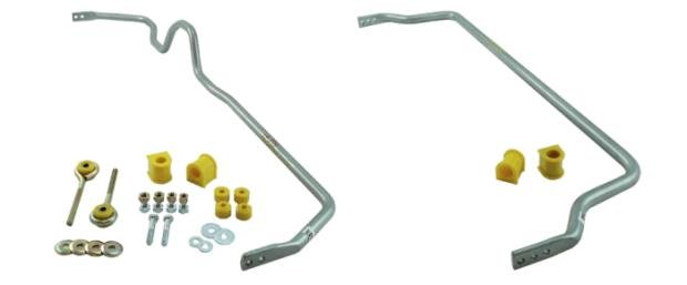

Ok - think I desperately need some ARB's to stiffen up the chassis and body roll when drifting at higher speeds etc...
Is Whiteline the only brand people would recommend? TBH I'm not keen on their prices which seem to be around £170 or thereabouts just for the front set :wack:
Also, should I get both front and rear done at the same time cos I have a feeling this is a must which is why with Whiteline the order will be for £340!!

I've seen alot of people use the thicker god speed set which they sell on DB Power. Think they Can be had for around £250 front and rears.

I went for the Whiteline at the rear only, well worth the €€€ as the improvement was incredible! But I am working with the softer Spec S chassis :ghey:

i had whiteline front and rears.... as said, they're well worth the money.
but, i only paied £250 for both front and rears in a group buy. if i hadn't of got them for that price, i'd probably have gone for something else.... at the end of the day, how much difference can one thicker metal bar have to another thicker metal bar? lol

used to run whiteling on my s14a very well worth the cash

i dont recomend the godspeed ones due to them not being adjustable

ARB's are well worth the money. Of all the suspension mods I have done the ARB's by far give the biggest improvement. I would advise getting both changed at the same time as if you just do one it may upset the balance of the car.
My Whiteline ones are adjustable. I have never seen the need to adjust them yet, as I haven't been bothered with stuffing around with my suspension at the track, but if you want to stiffen up the rear for skids, this is the way to do it.

With the Whitelines which bits are adjustable?? What settings to people tend to install on front/rear??
the ends where the links attach have multiple holes in it. Depending on which hole you use makes them stiffer or softer. I am running medium front and soft rear.

Dean - the Godspeed ones look excellent value for money but I'm swayed (excuse pun lol) by the adjustability of the Whiteline ones... esp now that I can get them cheaper than £170 each!! :)
S15AK - I've added my name to the Apex group buy on Whiteline ARB's. They will work out £126 for front or rear so getting both will save me £100 on normal retail woop!!! :D
