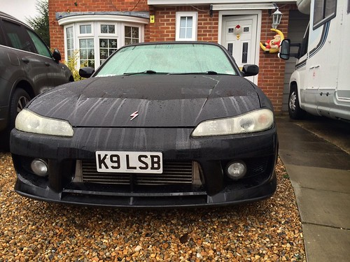

Where's the best place to get one from? Seen some on eBay but iv seen comments on here saying they could be fake. Getting fed up at looking at all different makes now I just want one that will fit with out losing my fog lights or having to cut my aero bumper

It here : D not seen it yet as its at my missus's work. What size hole saw do I need and any recommendations? Also is there a template in the box to show where to drill?

Nice that dude don't see many s15s in black

Should be here on Monday. How have people held their battery down when its turned sideways?
4,643
46
I used a tie bar over the top of the battery and then had a threaded rod welded to the tray on the arch side of the battery and drilled a hole engine side and use another threaded rod I can remove then

tegiwa imports do battery straps in different coloured alloy
21 July 2011
500
England
Cheers guys going to have a go at making something just didn't know wether there was a way of just bolting it back down
