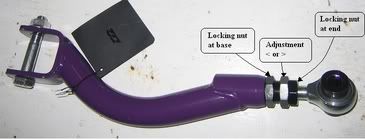

Do you guys know if it is possible to adjust the camber with the arms fitted to the car, as i havent adjusted them nearly enough :rolleyes:
:rolleyes: Jeez...
Luckily I've been able to check the Cusco ones under the desk. :D Yes, they should adjust in-situ.. The two end nuts are locking. The middle one adjusts the barrell length.
Thats what i was hoping, so if unlock the locking nut at the end and the base of the threaded parts, the middle should adjust outwards....... is that correct??
Drawing time :wave: -
