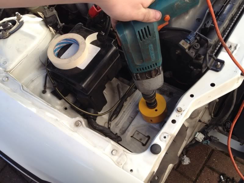

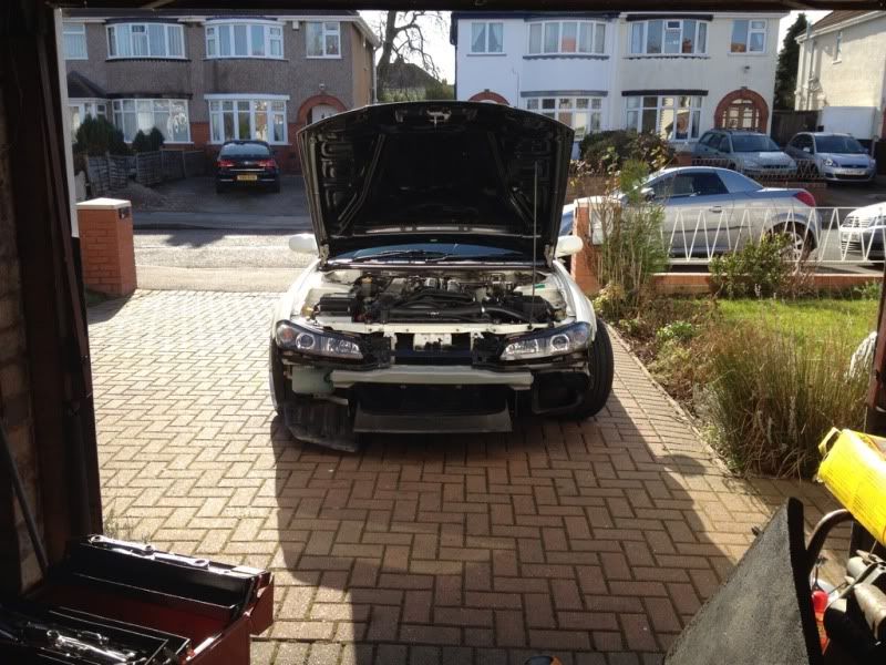

Bright and early i got to work
Removed all of the OEM Intercooler setup, and Airbox
Now it was time to get cutting :thumbs:

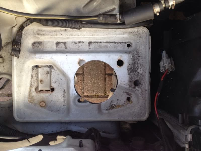

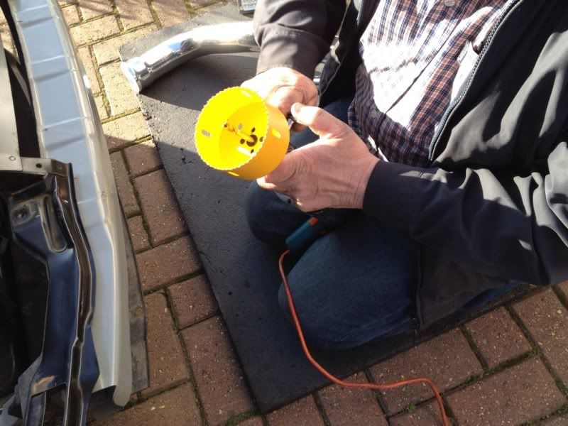

i went with a 92mm holecutter to give a little extra room for movement in use
marked out and got cutting
perfect :thumbs:

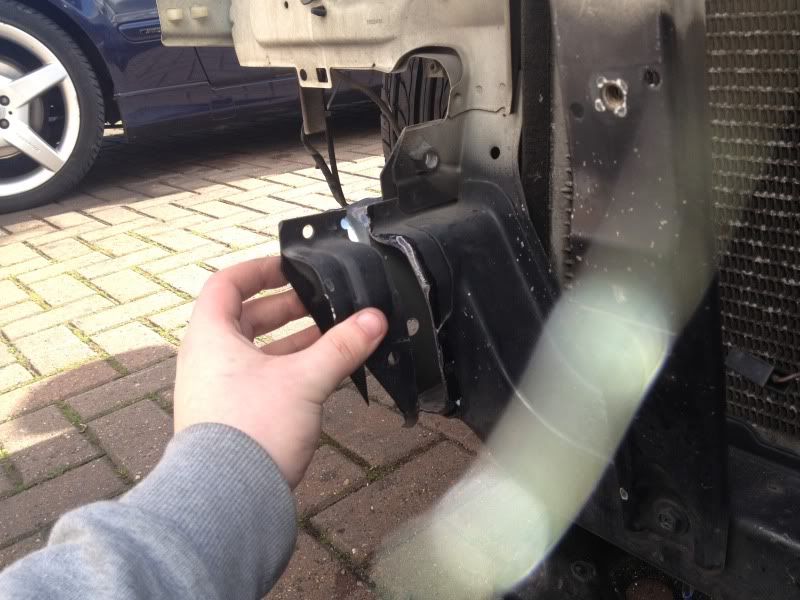

Next was to trim the inside of the bumper bar support, and paint it to stop it from rusting.
Now all that's left to do is to refit everything tomorrow :D

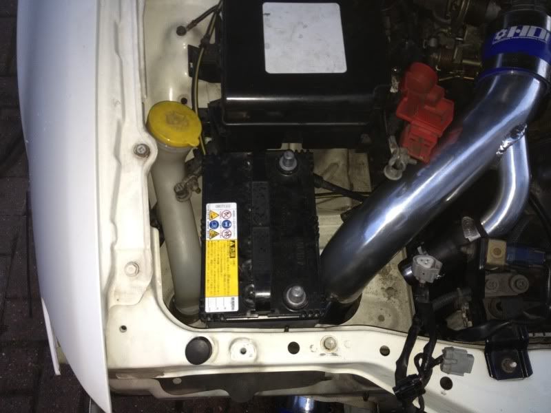

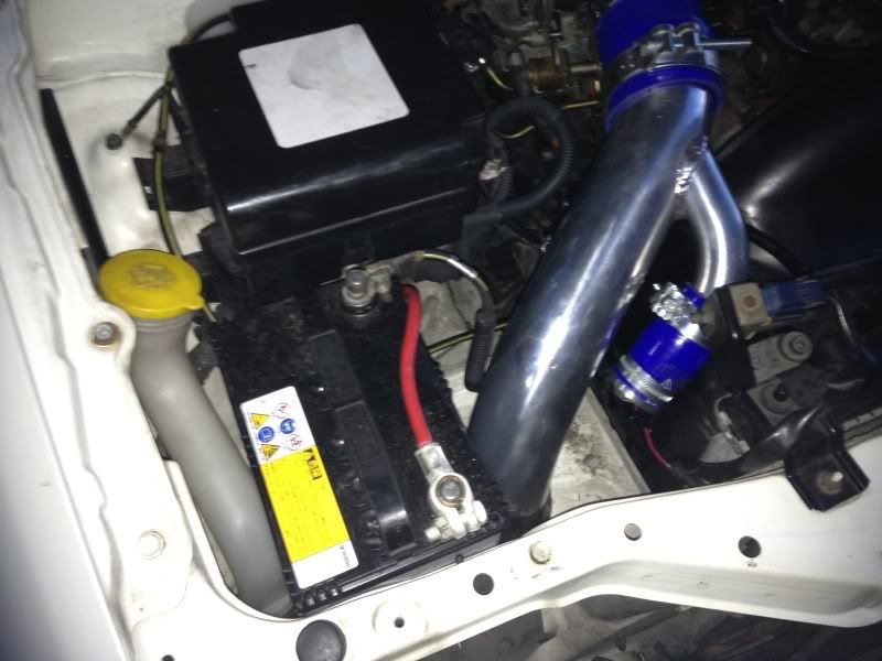

Nice mate, does the battery fit sideways or are you putting it in the boot?

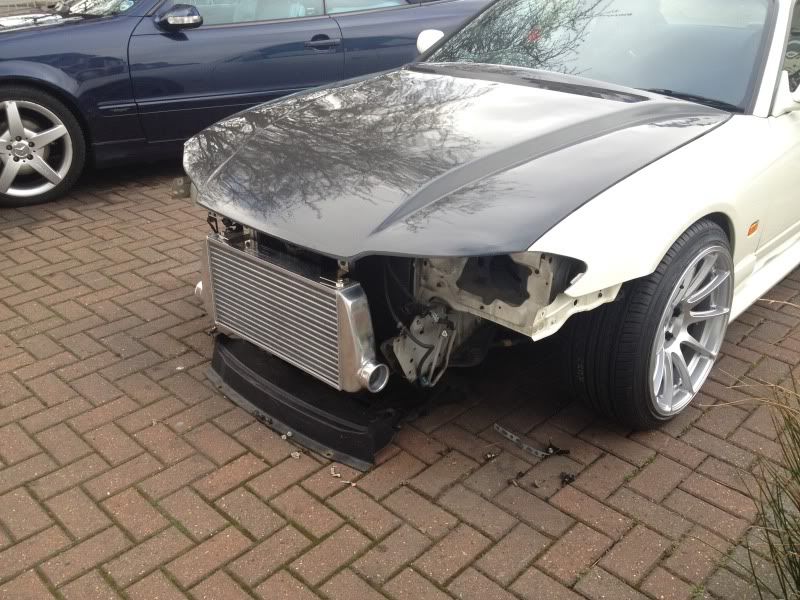

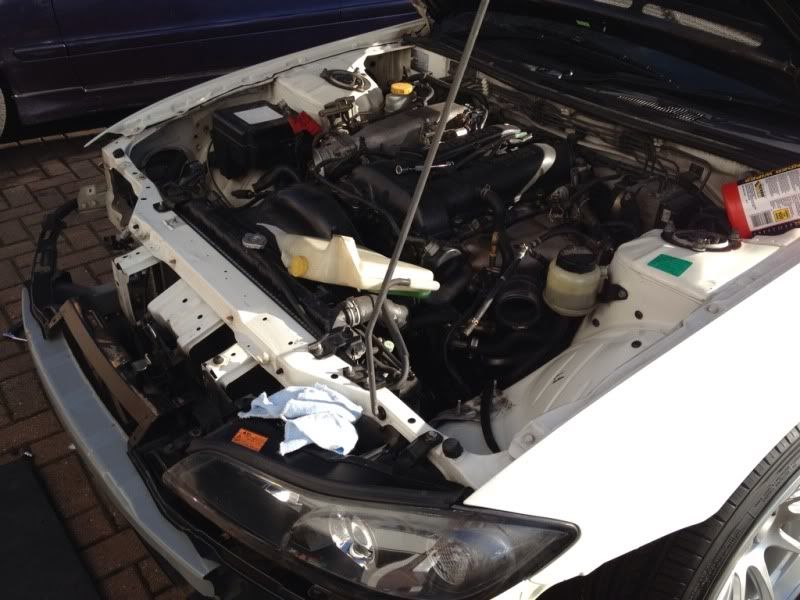

Well it was a productive day today, but still not finished!

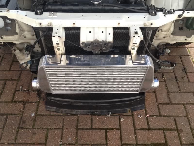

Started off by mounting the intercooler itself
This was to see how much i needed to trim off of the Chassis nose's
Took enough off to have the intercooler as far back as possible. painted them and left to dry so they wont rust

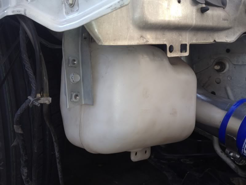

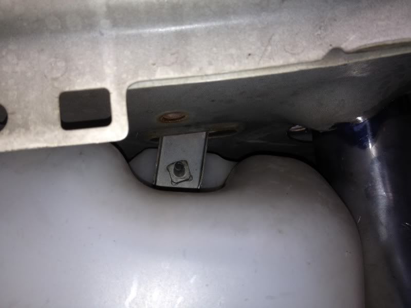

Next was to re-locate the washer bottle, which ended up with it staying relatively in the same place lol.
I managed to just spin the left most bracket upside down, and also bending the top mount bracket slightly. getting rid of the third one completely as it was braced sufficiently.
Here was the result
It now has nice clearance with the boost pipe
Then it was time to fit the rest of the boost pipes, but that was all i got done today, as i'm missing a silicone coupler for the boost pipe-to-turbo. Ordered one, and a couple of other pipes for blocking off the oem dump valve ports etc.

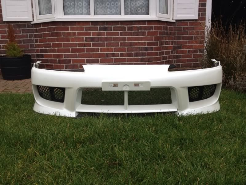

I did manage to test fit the Aero Bumper and it clear's! No trimming needed :down:
The battery will fit sideways Ollie :thumbs:
It looks like i will need to extend the positive wires though

I made a small hole in the bottom of the fuse box that allowed my positive cable to reach, just an idea, couple of pictures on my build. Looking good though mate. I did mine when it was too cold!

Awesome work Dave I have all this fmic fitting to look forward to when i get back from holiday!
My battery will fit sideways to so interested on how you solve this. Wether you extend it or take ollie's approach!

Are you planning to place a rubber grommet around the hole that you had cut?
Yes I'll be fitting rubber around the hole. As well as this, I Made the hole 92mm, bigger than what it needed to be (80mm Boost Pipe) so that it has room for movement when in use

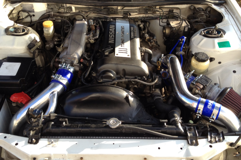

Been busy with work, but managed to get some work done on it yesterday
Finished off everything on the FMIC install, fitted my APEX intake pipe, Apexi intake, and Tomei Plug Cover

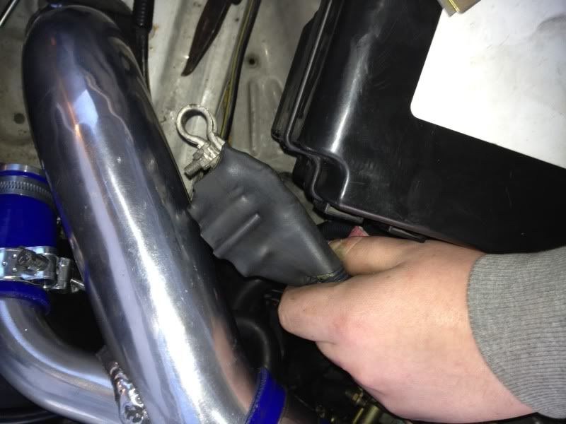

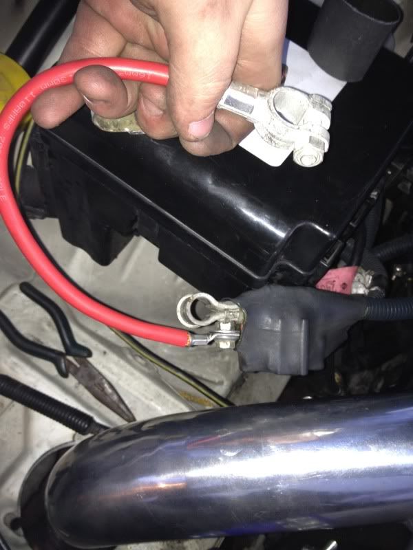

Also, a solution to extending the positive battery wires - exactly that, an extension!
first of all i removed the plastic casing
then heat shrinked that section
Extension!
bolted on
heatshrinked the rest and installed terminal onto battery
Job Done! enough for one evening, will secure the wiring, and fit new battery stay tomorrow

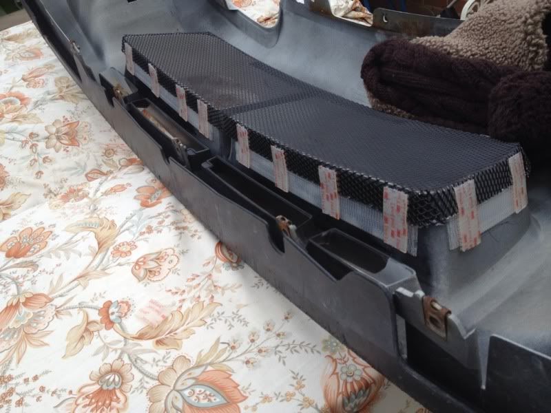

Been a while since i updated, Before going on the road, i wanted to protect the FMIC
bought some fine grade mesh to block as much debris as possible, and used 3M Nylock so it#s easily removable, and more importantly- no damage to my nice Aero :wave: this stuff is hella strong
